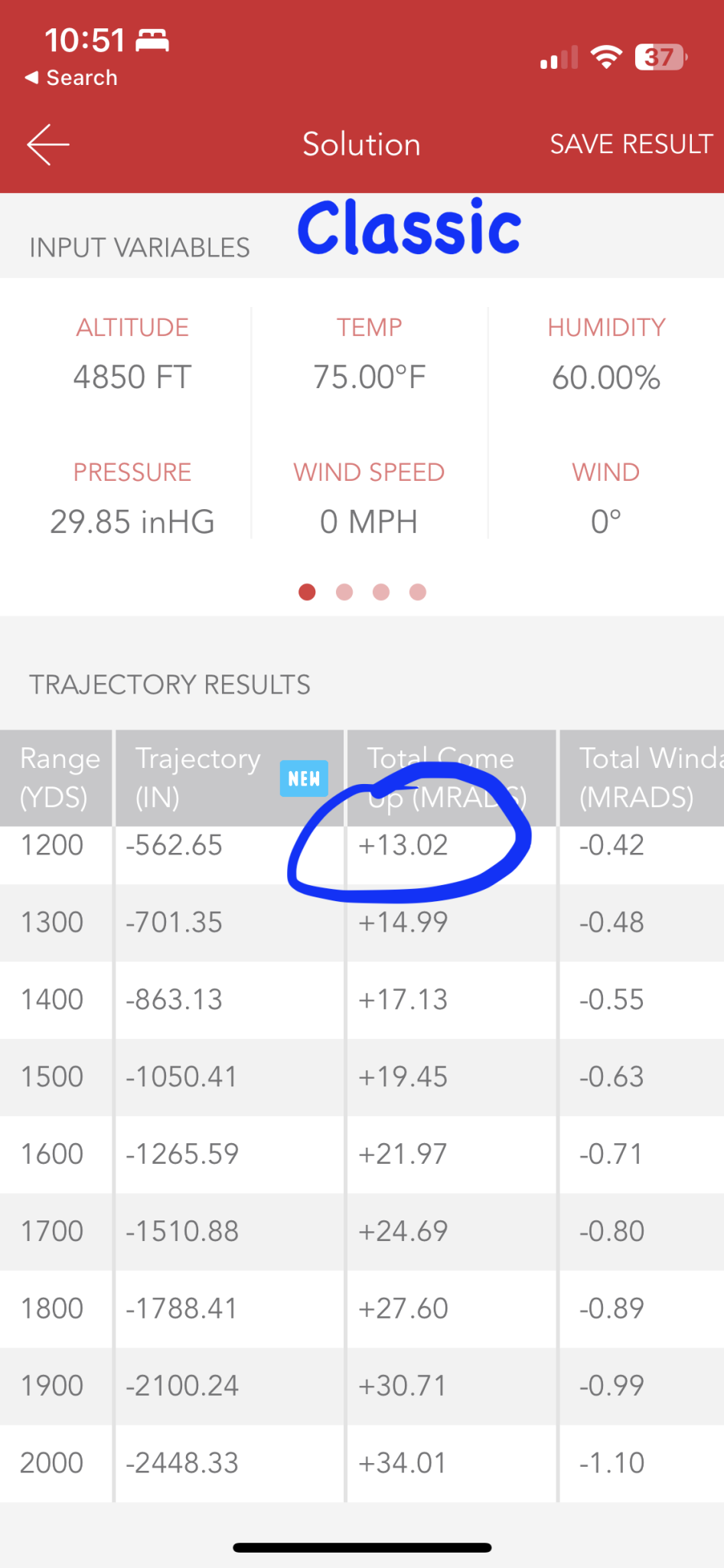

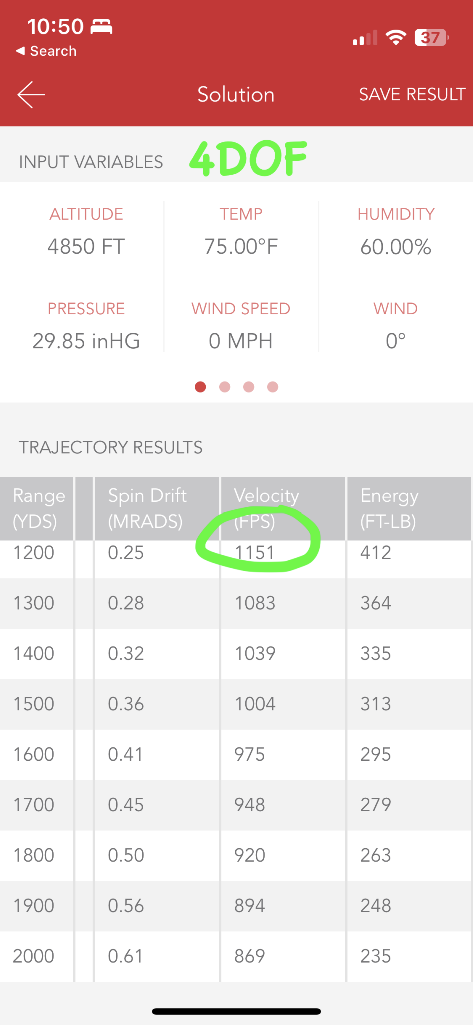

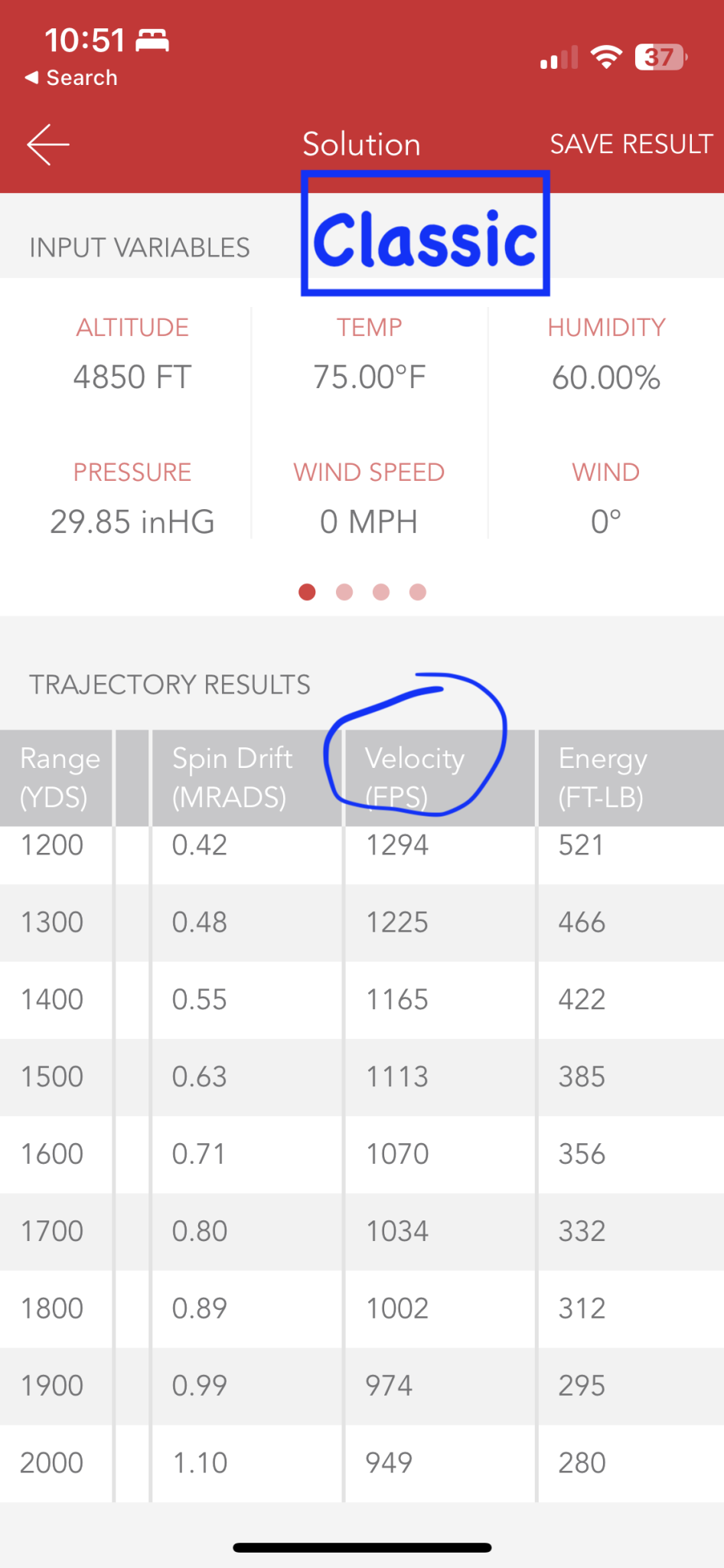

I would like to know when the bullet speed is really falling out of transonic range. I thought it would be fun to test and see if these ballistic calculators are really accurate with velocity at distance.
With the manufacturer BC and an actual muzzle velocity, you will get really close to the real range at which your projectile becomes subsonic.
Ok, thanks. Yeah, I'll try that first, but was curious if anyone has ever done this and what real world numbers looked like, compared with the ballistic calculators.

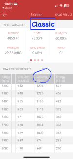

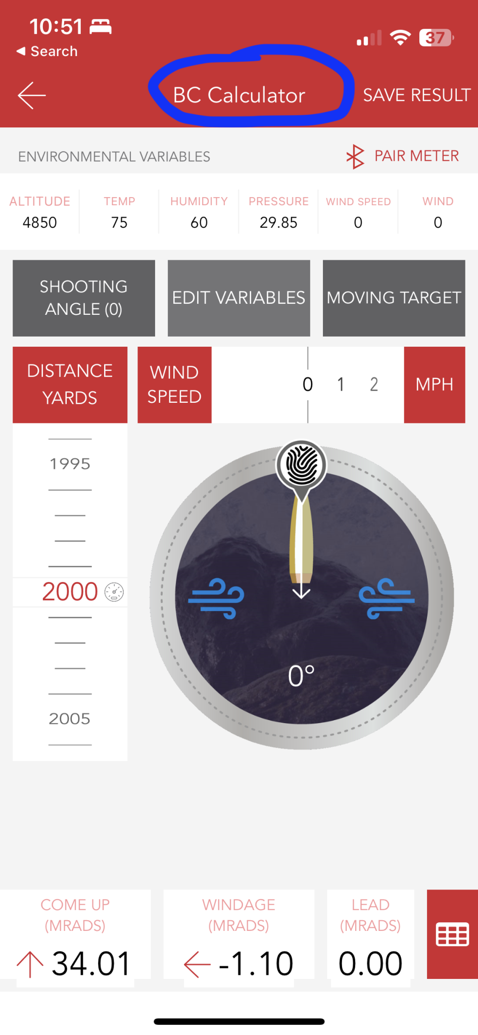

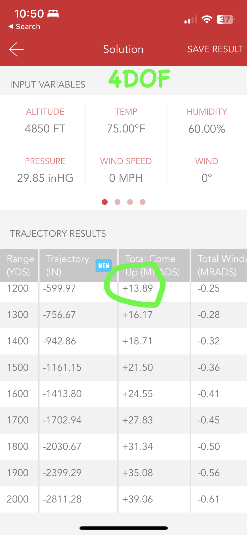

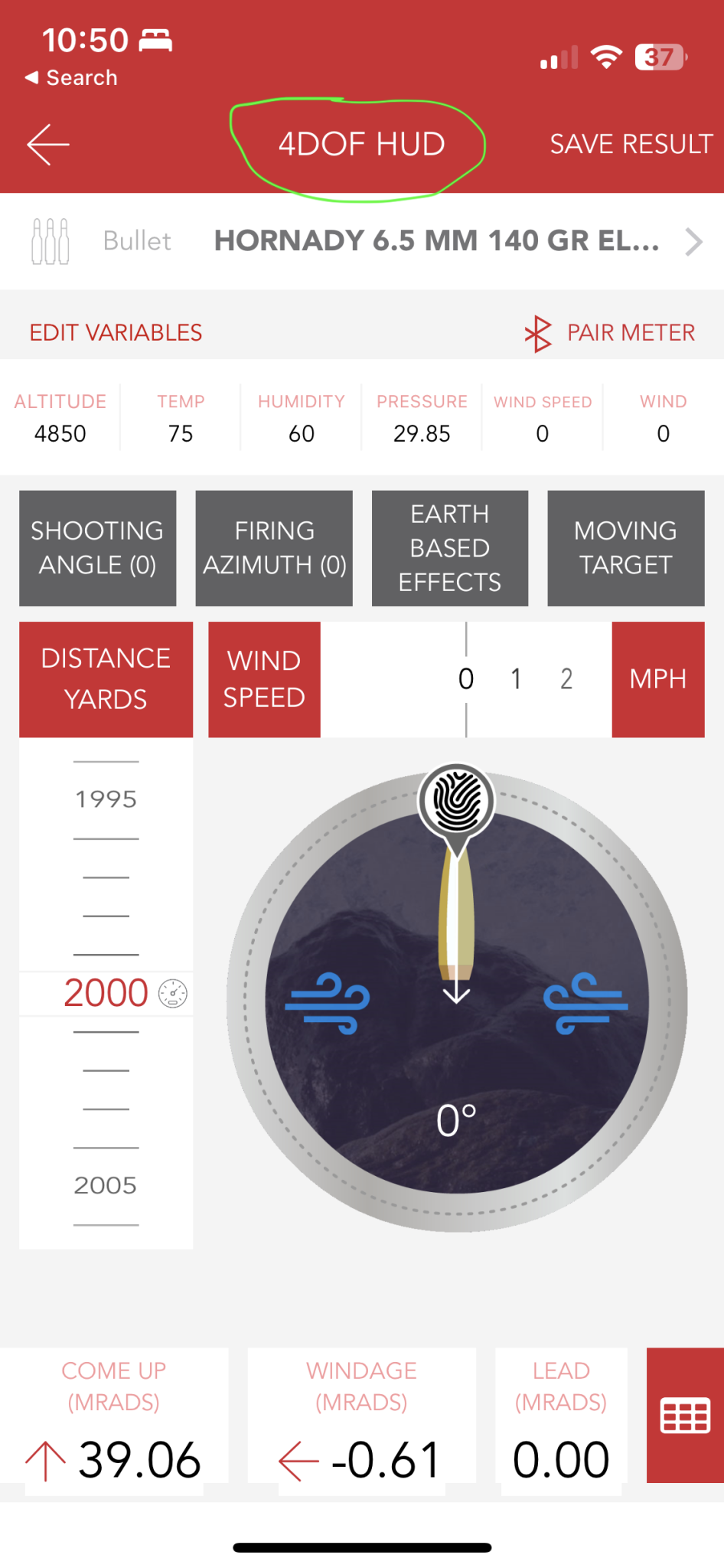

Oh, gocha. I was just using the Hornady calculators on their app. Tha basic calculator shows the bullet staying supersonic until between 1400-1500 yards. The 4DOF calculator shows the transition starting around 1200 yards. They both have the same data loaded, but 4DOF uses drag coefficients instead of BC's, apparently. Here are the screen shots.

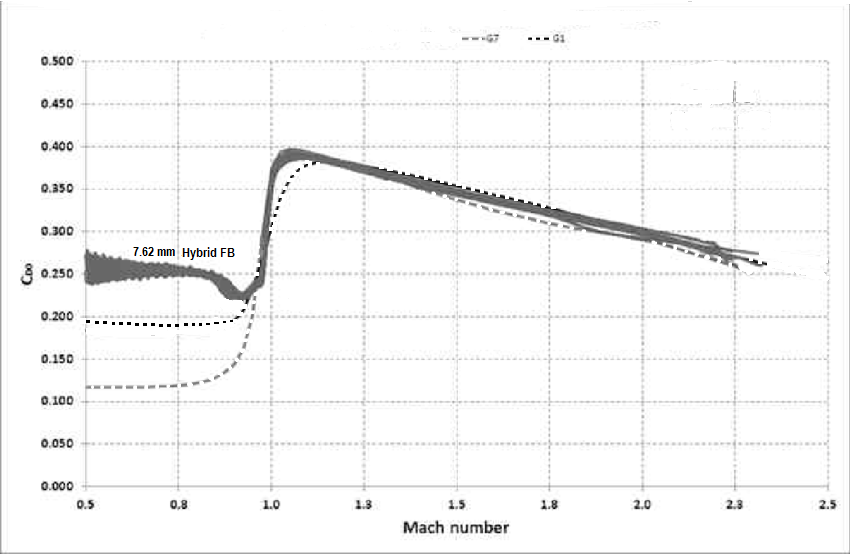

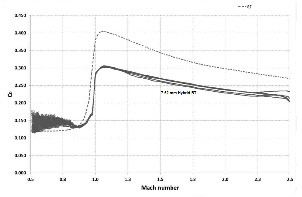

Specialized military radars of today. Here are reconstructed CDMs curves for two .30 cal. wildcats tested in France few years ago:
Drag-curve-for-the-130-gr-Hybrid-Flat-Base-and-fitting-of-the-G6-and-G7-curves-in-the.png
First is for flat base projectile, second for boat tail one.
TOF~12.5 sec and range for VLD is roughly 4000 yards.
10 shots. These were very preceisely manufactured projectiles.
It's normal phenomenon for VLD small arms projectiles in subsonic range what you can see there (and now you do understand what I was saying).Very unpractical shooting distances, but yes projectiles do get tested for various reasons that far.

Of course. The only point of showing these Cd vs Mach graphs was that for very long TOFs and the long boat-tailed VLD bullets, dynamic instability phenomena are likely to occur below Mach 0.8. Drag increases mostly due to precession and yaw of the bullet, and within the grey blurred envelope there's usually significant statistical split among average drags of individual shots. OTOH, flat base bullet fly subsonically with less precession and more predictable (but they are punished by higher drags levels overall)
