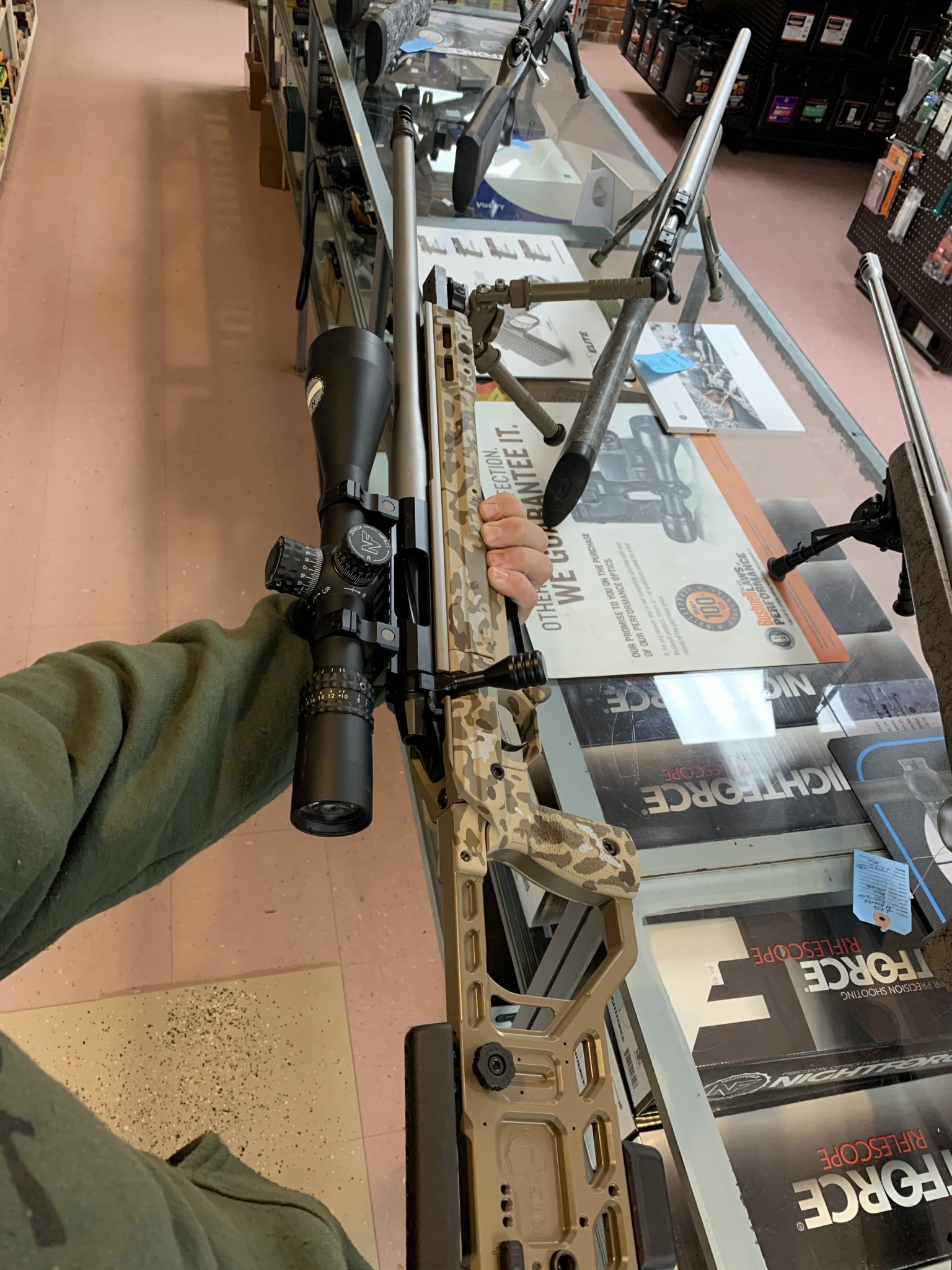

Is a medium Palma going to be heavy enough to shoot a match once in a while? I use my guns for hunting more than anything but I want the capability.
More than enough. I have most of my rifles in med palma now. I like the lighter weight and no issues with longer strings of fire.
Sweet thank you I ordered it Saturday and like most things about 1am last night I started sweating if I made the right call lol.
