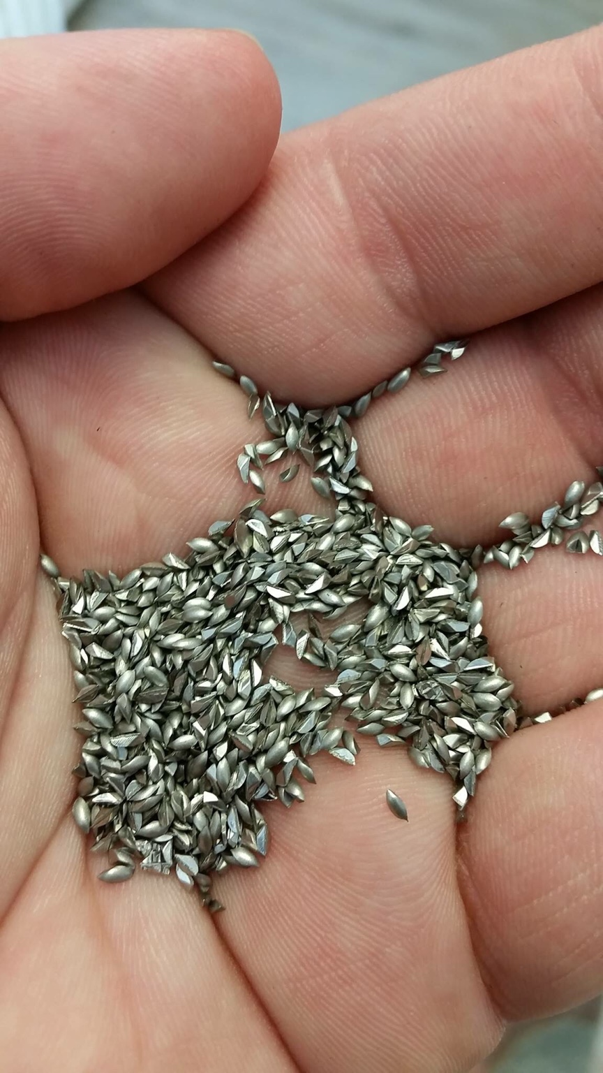

I wet tumble, but I also use stainless "chips" from Southern Shine Media. They're quite a bit smaller than pins, so nothing gets stuck in flash holes, primer pockets, case mouths, etc. I've been using them for a few years and I have yet to have a chip get stuck in the brass.
