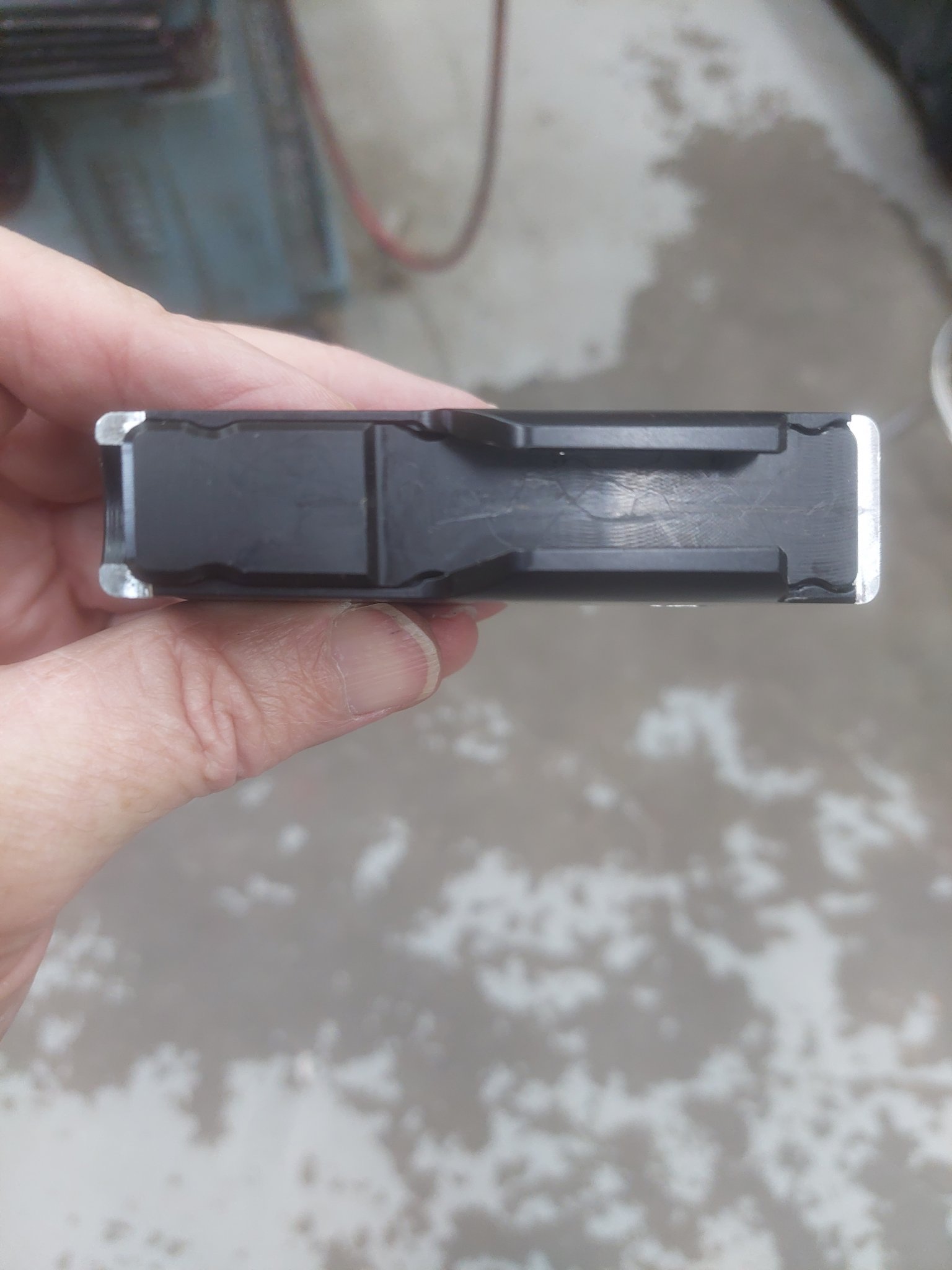

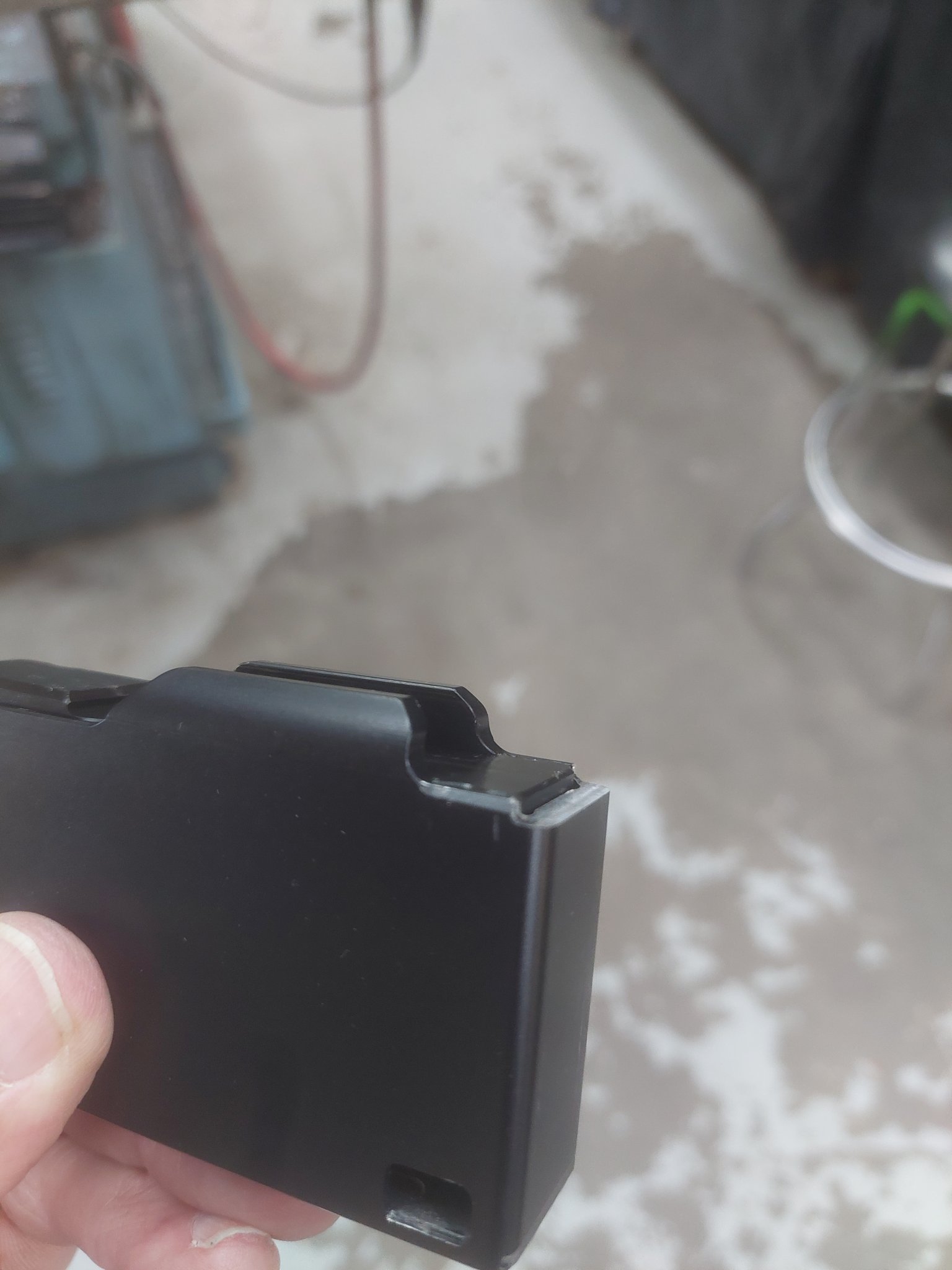

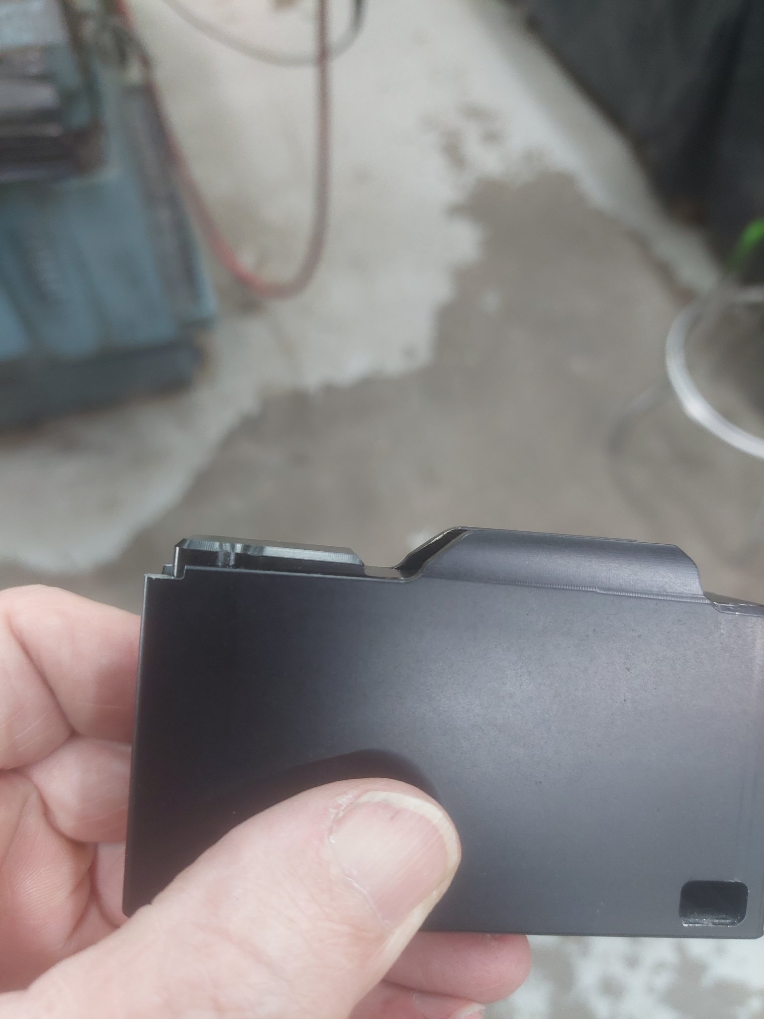

The bottom metal and magazine are both very well made, we had to mill off a bit from both the front and back of the magazine.
It feeds flawlessly, my only gripe is there is no taper in either the magazine or the magazine well and they have to be aligned perfectly for the mag to go in. Here are photos of the modification
