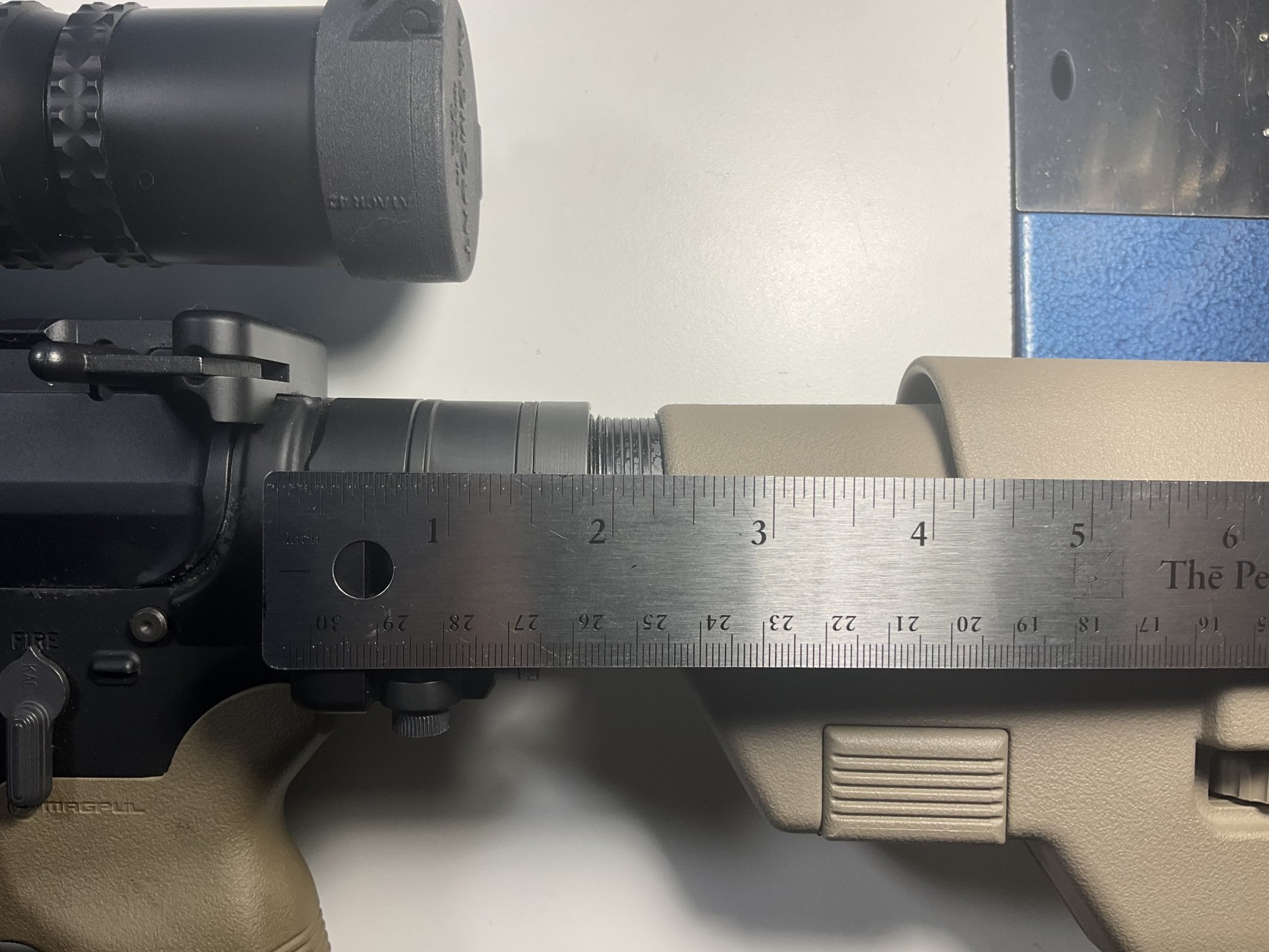

This is a "long" on an AR15 with a law folder. With the stock locked into the first position there is .5" of buffer tube showing. The measurement from the rear of the receiver to the front of the cheek rest is 4.25". On my Maten large frame the charging handle extends 4" past the rear of the receiver. I think you can do a "long".
