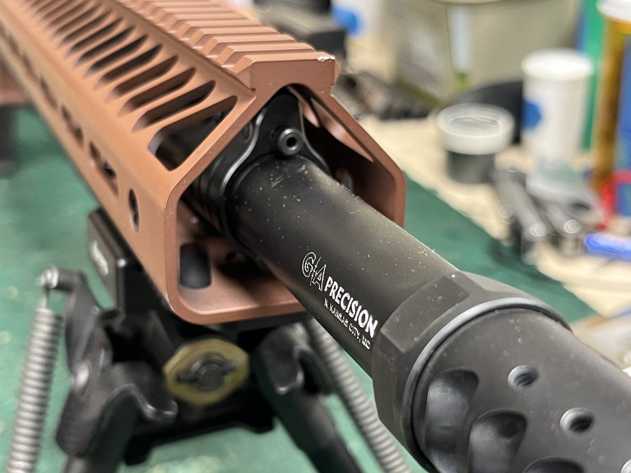

I’m gathering parts for a 6.5 Grendel and went with the Seekins SP3R,mainly because of the way they free float the barrel. The SP3R handguard has plenty of room for the superlative arms has block.
I just sold a rifle with the SP3R handguards that housed an .875 SLR gas block. It fit with no issues.
