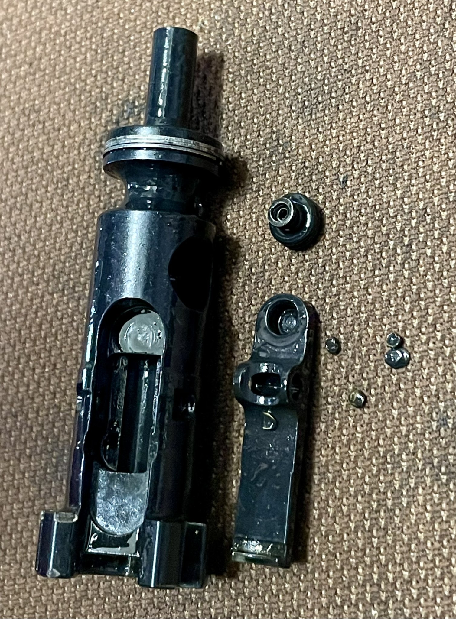

Metal fragments in bolt
Squad51
May 9, 2020
65
20

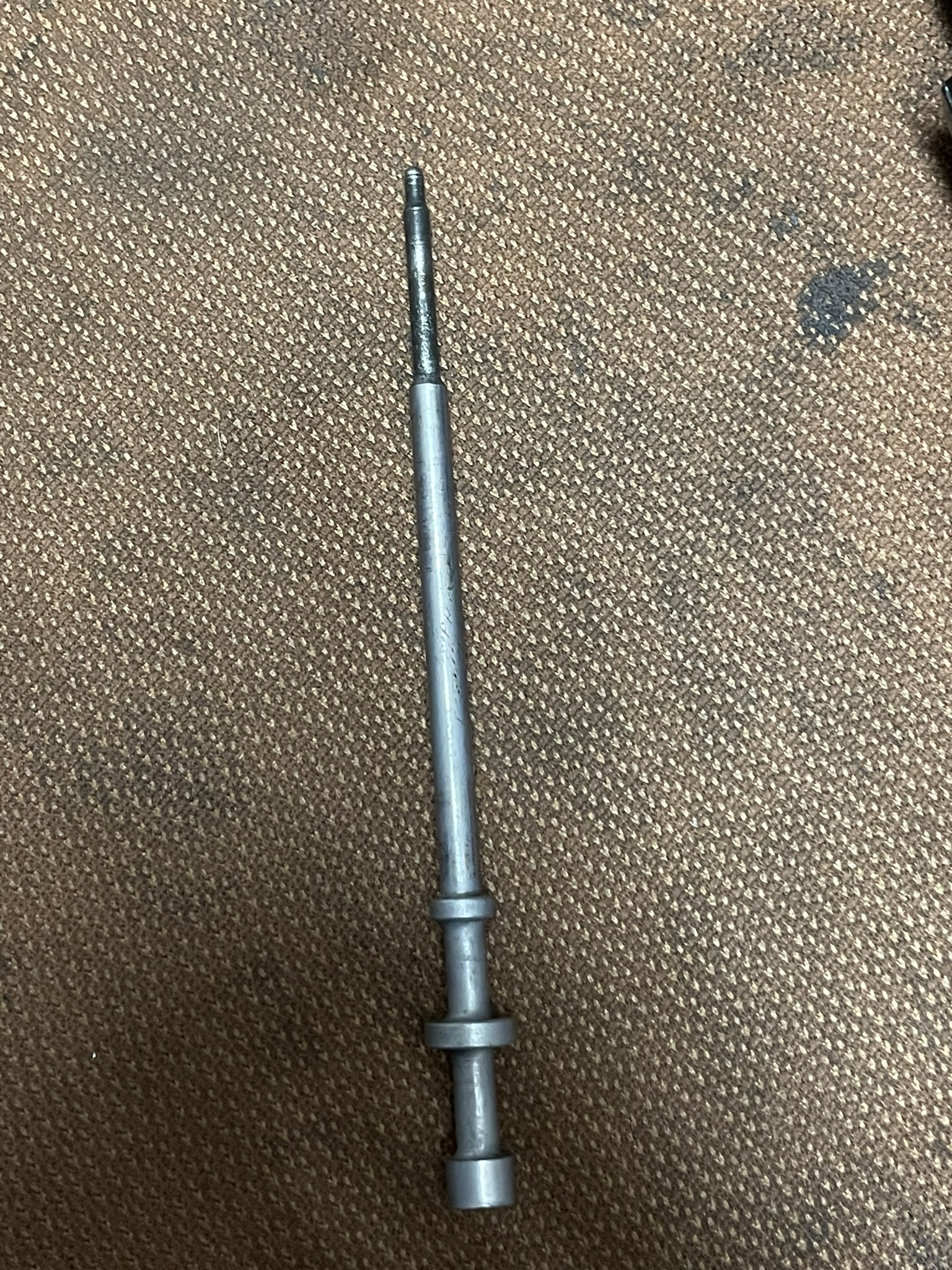

I found these little metal pieces inside my bolt today (right side of picture). Any idea what they could be?
Also, the spring/bumper came off the extractor. I can put it back in but it seems looser than in other rifles.
Aero M5

I haven't noticed any pierced primers, but I haven't been inspecting every round. I'm running factory ammo - Win 125 FMJ. Velocity is averaging 2840 out of a 22" bbl.
Firing pin looks ok. I have about 100 rounds through it and it shoots great - sub MOA.

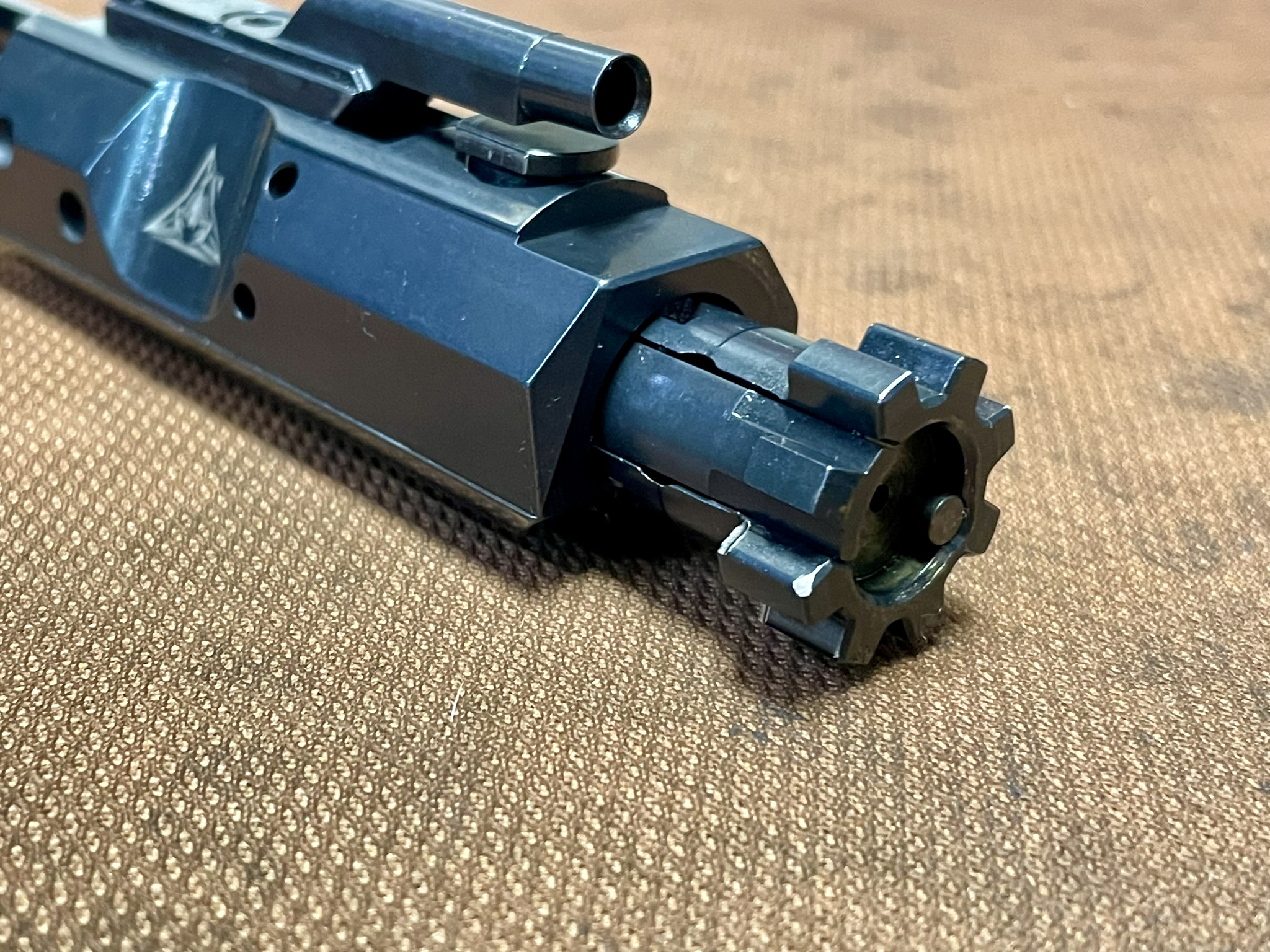

Here's a picture of the bolt face.
It is not a light weight carrier. I have a heavy buffer and the timing seems to be good. Ejecting at 3:00 and no ejector swipes.

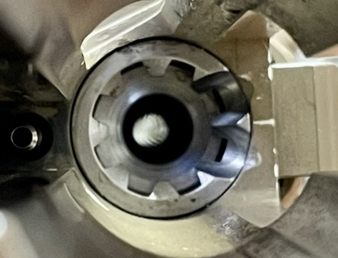

@tomme - what are you noticing that indicates clocked barrel extension? And how does one fix that? I know the barrel was properly torqued when installed.
FWIW, your photo shows a RISE Armament BCG... not a Rainer Arms one.

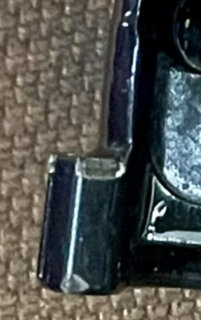

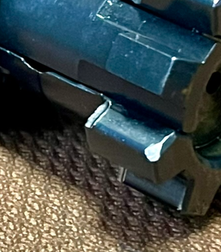

It is possible the over pressure ammo helped produce the bolt lug battering.
I wouldn't use that specific ammo anymore.

Do you have the means to measure your FP tip size, and the bolt face FP hole ( aperture ) ?
Sorry if I didn't notice, has this only happened with the Winc. 125gr ?
Any pics of fired cases ? Specifically the Blanked primer ones ?
