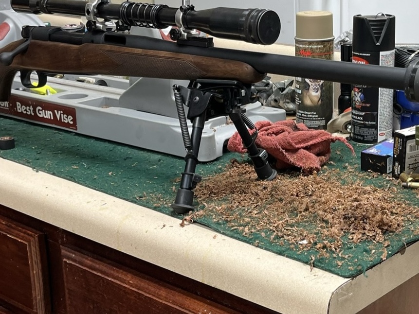

I'm going to install a Lilja 1.00" barrel in a CZ 457 Standard Varmint stock. My question is, do I start at the bottom of the channel with smaller socket/ sandpaper? Or, start at top of channel with final width of socket and sand paper needed. I just want to avoid the top finished edges from getting chipped or scuffed. I suppose I could tape off that top edges? I'm open to all suggestions / ideas! Thanks! (y)

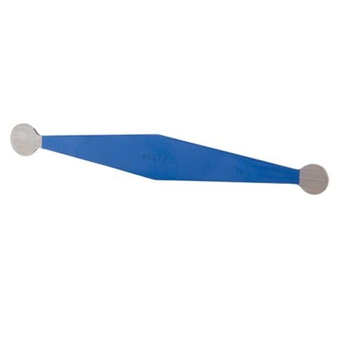

You can run yourself ragged with one of these Jerry Fisher scrapers as well. Nice even passes until it fits

I got the job done. It appears pretty even on the margin space all around the barrel. With the new Lilja, ammo feeds, fires, and ejects just fine. So, I guess it's headspaced properly. With the Receiver and shank measurements, I shimmed for .042" headspace. I wound up using a deep well socket and sand paper. Thanks for the help folks! 👍
