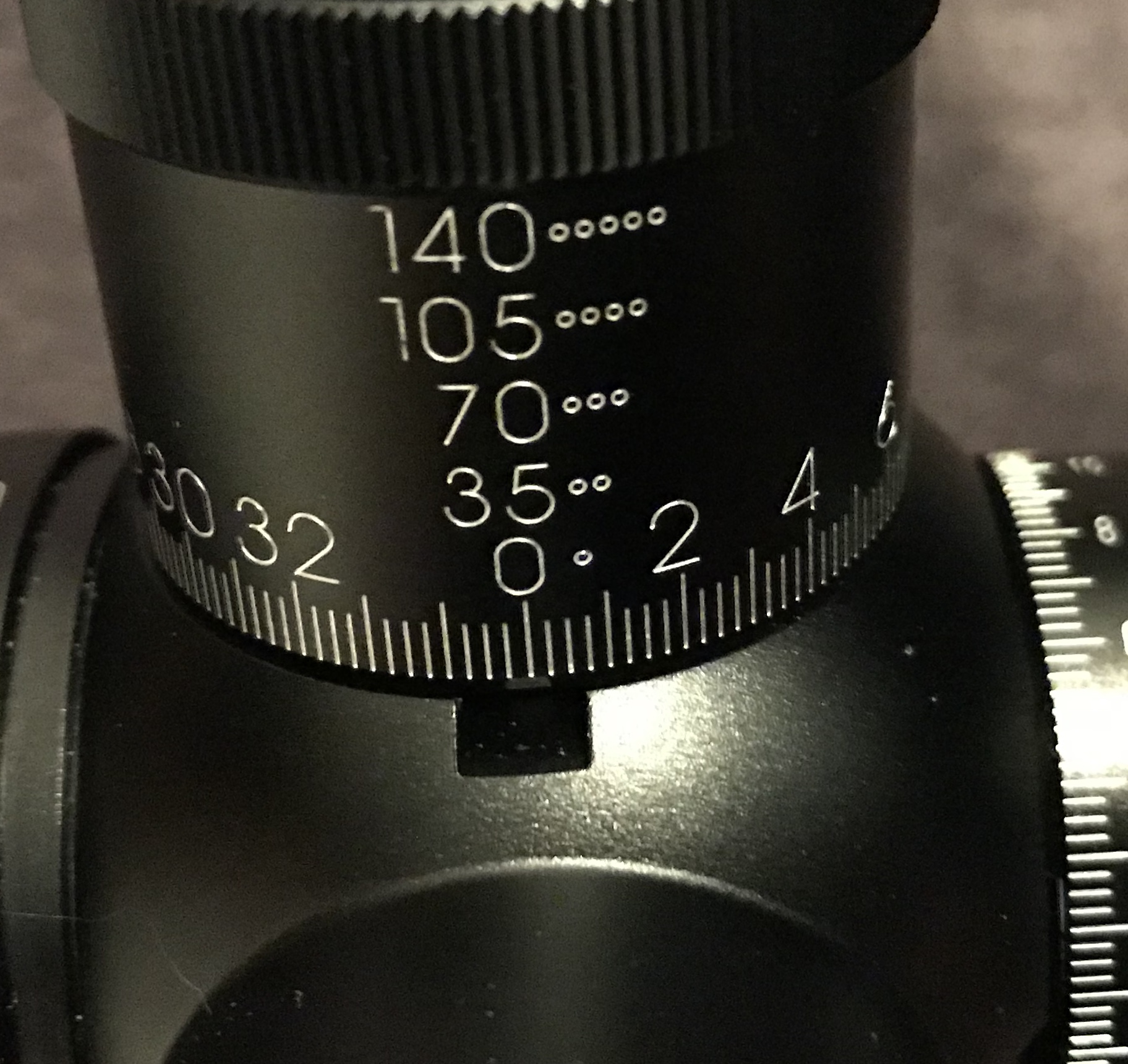

I have a S&B PM2 12-50x56 with 0.25cm turret adjustments.

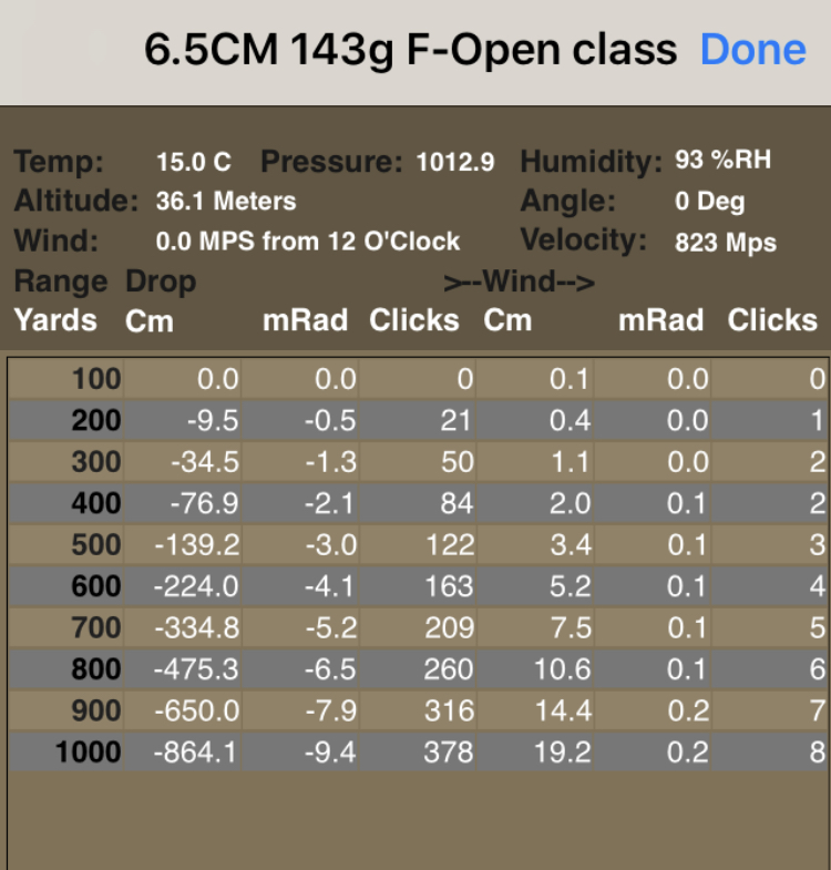

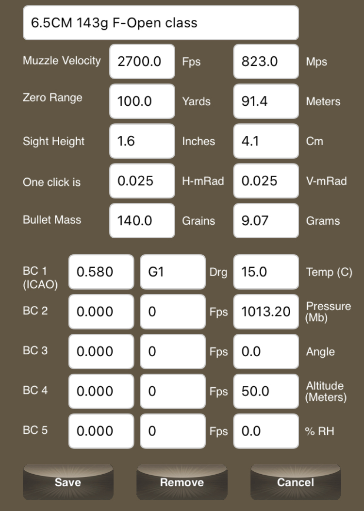

How do I relate the metric scope adjustments (in this scopes case: 1 click = 0.25cm) to MRAD or MOA? The reason I'm asking is due to the ballistic calculater apps out there. I am using the KAC Bullet Flight Level 2, version 4.6 app. I am yet to discover a ballistic calculater app that calculates in metrics.

Your software should allow you to input the turret value as .025 mil

Your turret should have every single digit labeled like
1 2 3 4 5, etc etc
Each of those numbers is the same a .1mil
Then it should have hashes for every quarter of a tenth or .025mil.
For PRS style matches, ignore the hashes or .025 and just pay attention to the labeled numbers and use the 10’s version as above. For more precise target matches, you can use the .025 clicks to make smaller adjustments.

The adjustments on this scope is 2.5 millimetres / click.
4 clicks = 1 centimeter.
Thank you for your expl, but I am still confused....or stupid!
Yes. So it’s either going to be labeled 1,2,3,4,5 or 2,4,6,8,10. With large hash marks at 1 3 5 7 9
1cm @ 100m = .1 mil = the turrets are in .025 mil clicks

So, if I set my calculater to .025/click then it should spill out the correct turret adjustment?
*Screen shots of the calculator I use and my
scopes turret.
