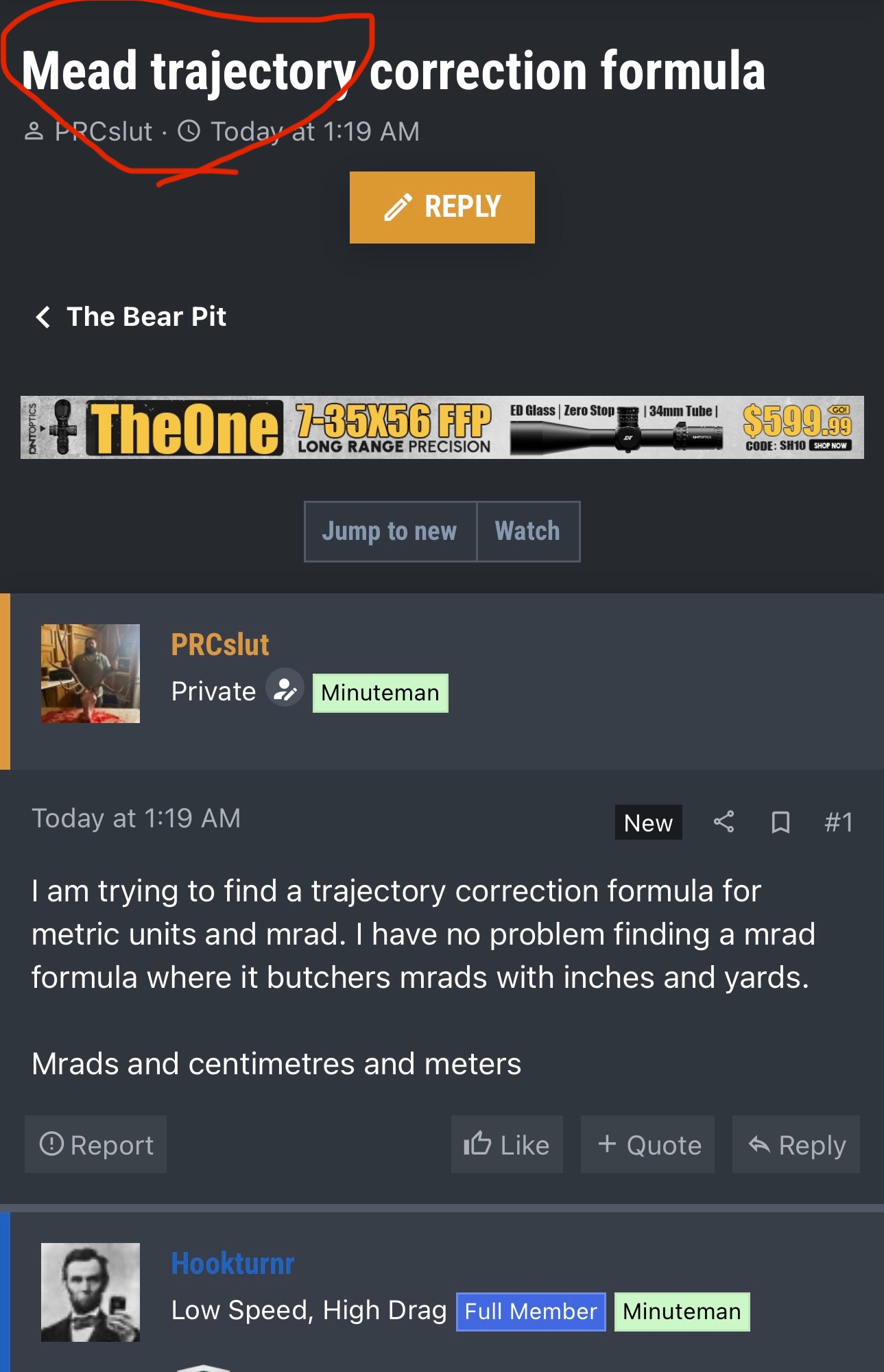

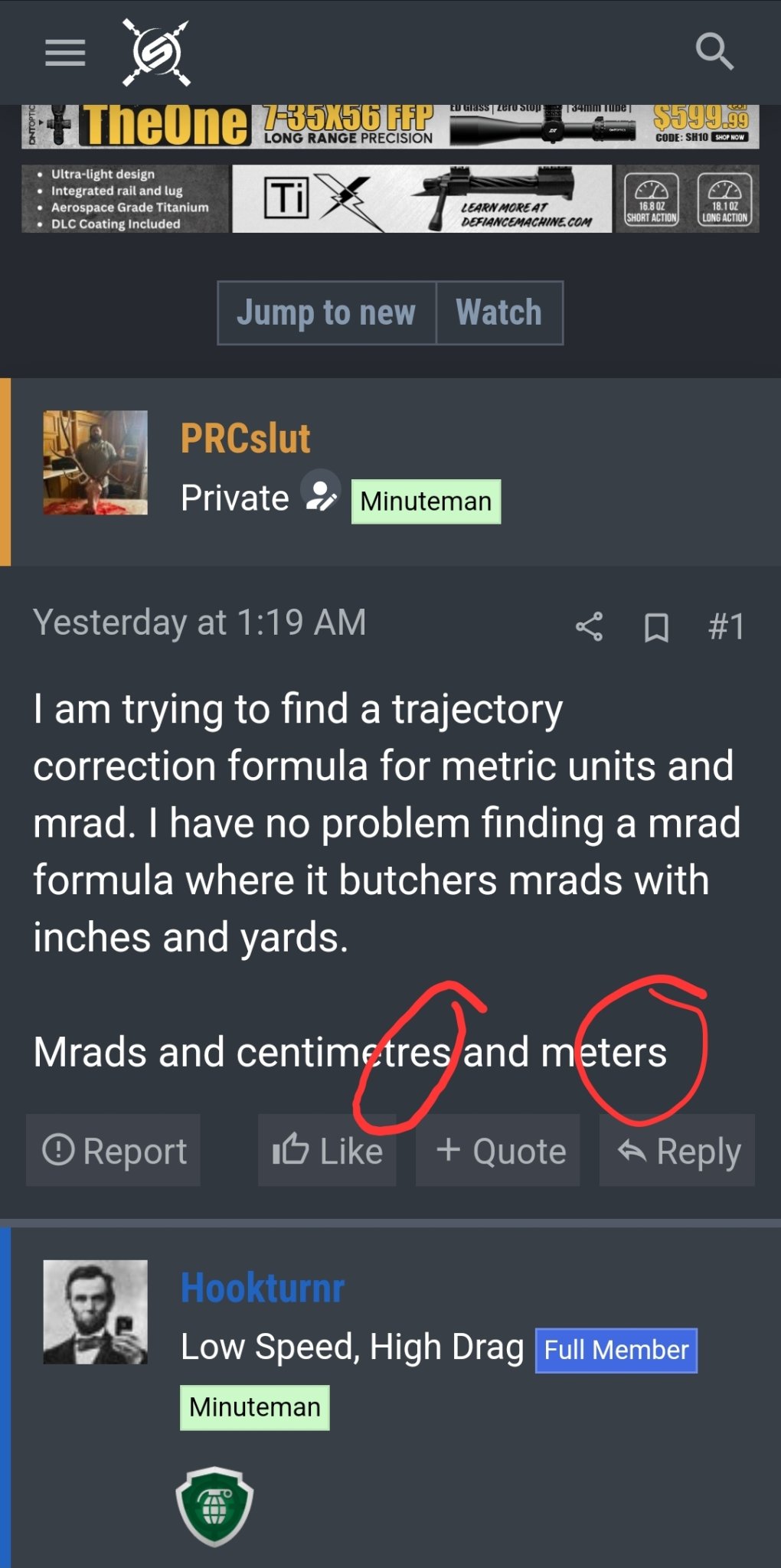

I am trying to find a trajectory correction formula for metric units and mrad. I have no problem finding a mrad formula where it butchers mrads with inches and yards.
Mrads and centimetres and meters

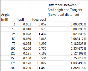

The error in % is indeed independent of distance.
Here are the numbers:
View attachment 8623353 View attachment 8623354
That pretty chart shows 1-200 mil. That's misleading to me. I'm not using artillery, I'm using a rifle inside 1000 meters.
That equates to 0 Mil (actual) at 100 meters (E) and 9 Mil (actual) at 1000 (D). That's the reason we use .1 Mil. Sooo, The relevant range is inside your first two rows and so are the angles (1/2 degree elevation). I can't close my eyes and move the rifle up 1/2 degree and nail it.
Same shit but with fractions. I like tenths (.1 Mil) - lot easier to work in my head. And the difference between Mil and MOA in scope clicks is smaller than the margin of error between the two measurements - 0.09825 inch. 4-scope clicks per MOA (1/4 MOA clicks) vs 10-scope clicks per Mil (.1 Mil)
All you need to know shooting Mil is one number .36. That is .36-inches per click at 100. The rest is sooo easy. Unless you cant remember one number :ROFLMAO:.
I purposely took this to the extreme to show what DocRDS said :"And for the astute among you yes, the arc length is not the same as the vertical distance. But its like super super close (I think at 100y the difference is in the 4th decimal point)."
In other words, for typical rifle applications you can save yourself the effort of using trigonometric functions and just go with the arc length, which is simple multiplication of mils times distance as shown in previous posts.
OTOH, artillery folks HAVE to get a little fancier with the math.
Reactions: JAS-SH
I purposely took this to the extreme to show what DocRDS said And for the astute among you yes, the arc length is not the same as the vertical distance. But its like super super close (I think at 100y the difference is in the 4th decimal point)."
