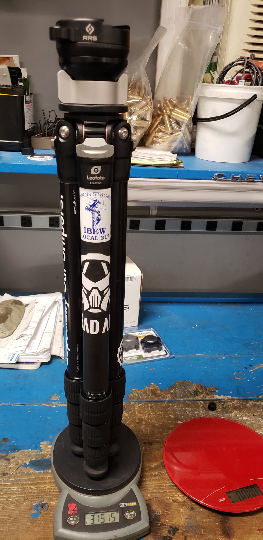

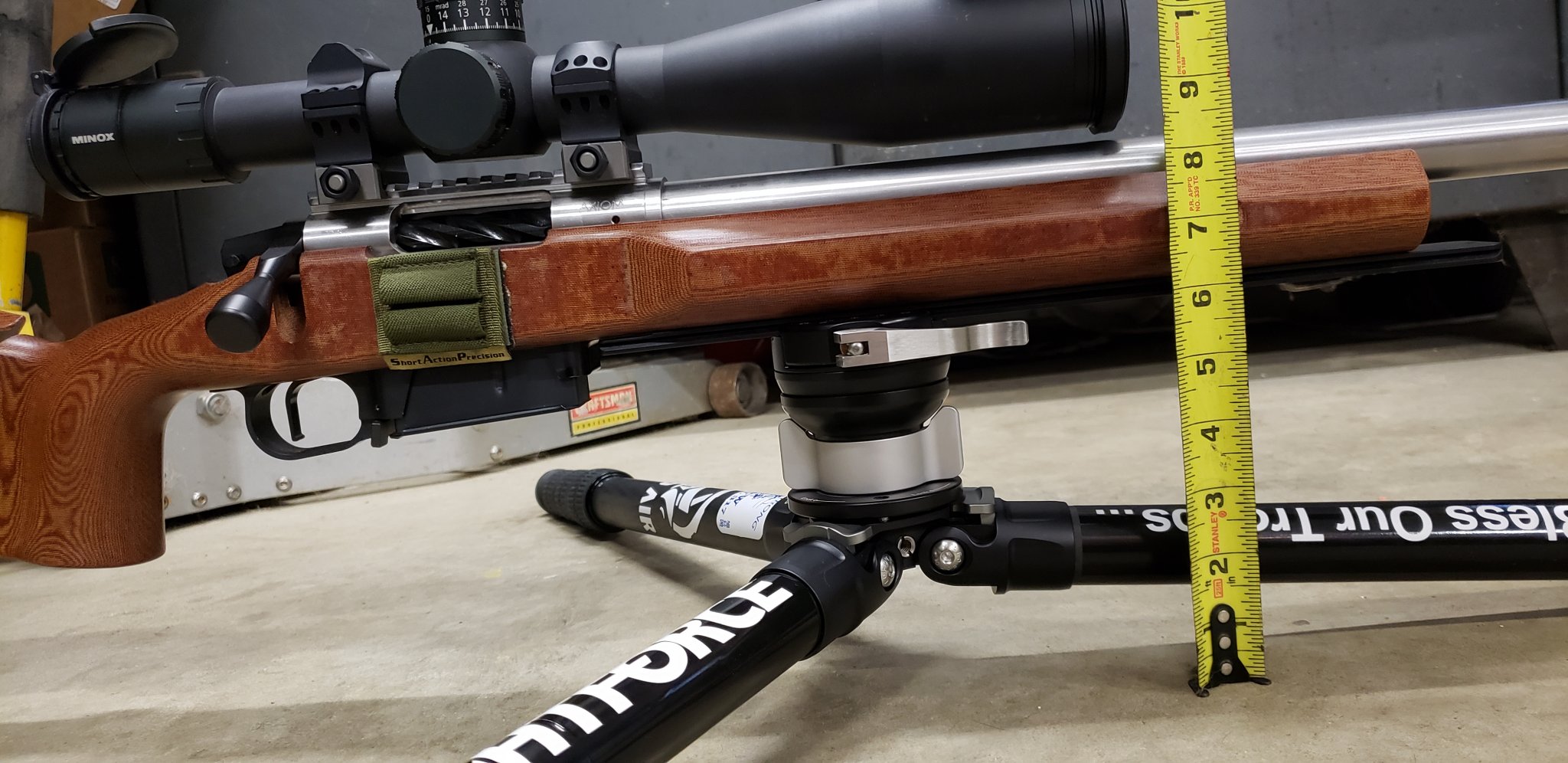

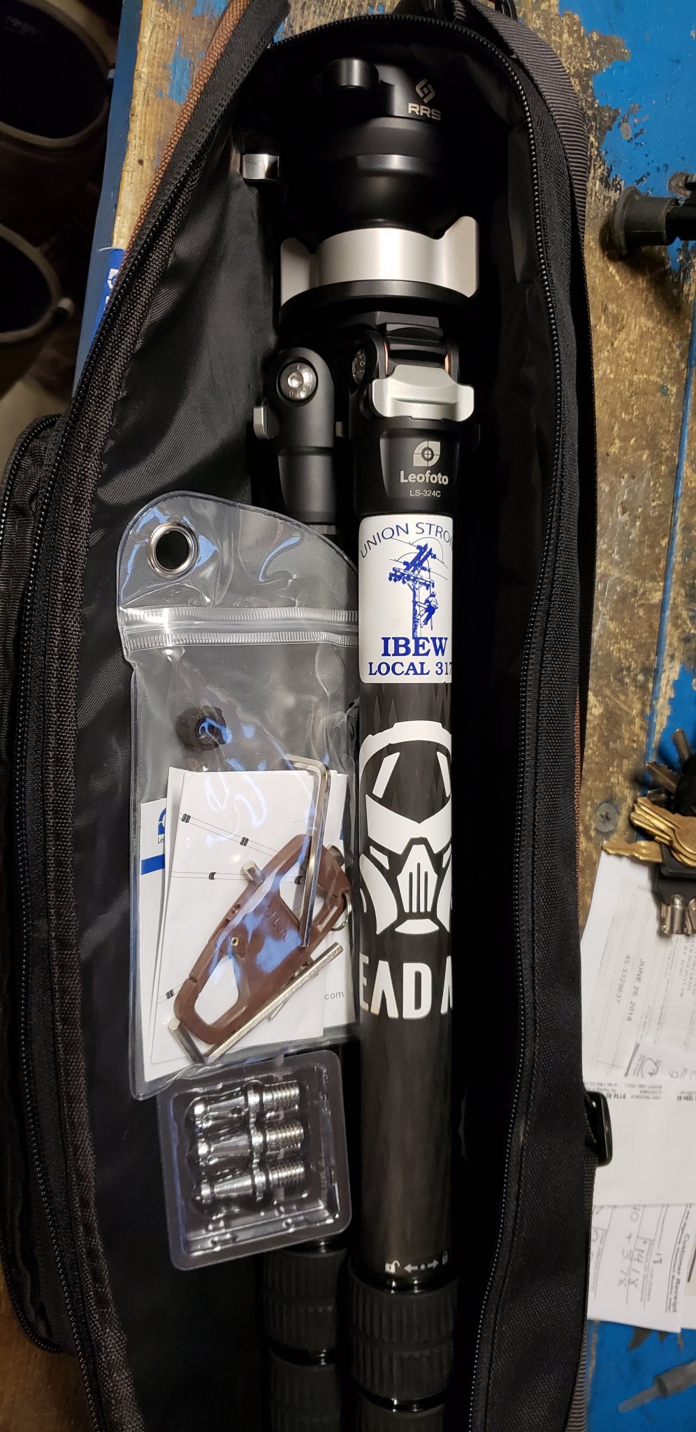

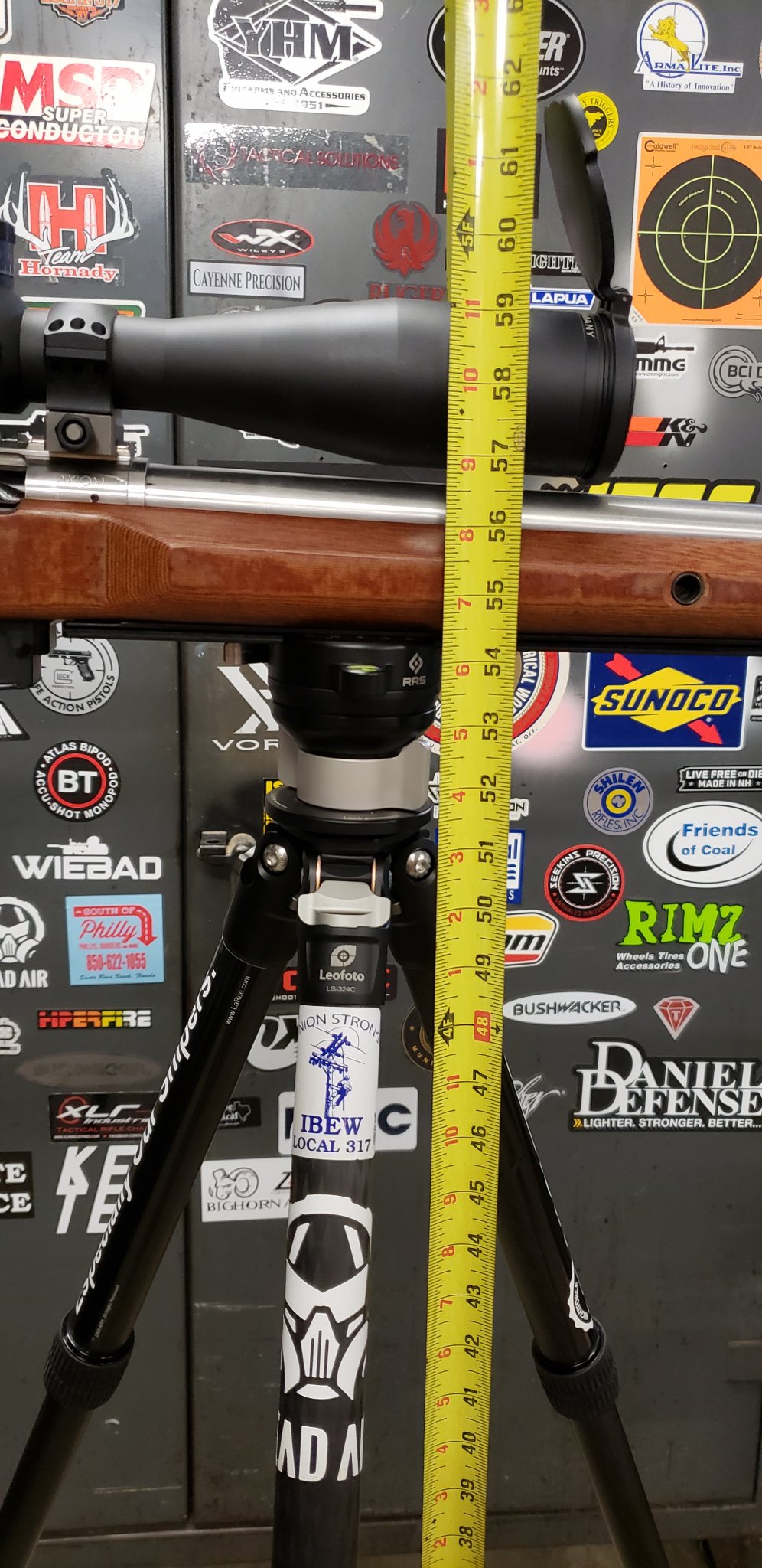

Tripods are a hot topic this year. Everyone lusts after that $1400 RRS setup, but not everyone can afford it. There is not yet alot of info out there on less expensive tripods for shooting. So this thread is another point of reference for the setup I've chosen. I consider this setup mid priced at $555. I did another thread on a budget setup with the innorel RT85c. I also believe that is a great setup for those on a smaller budget, as it includes a ballhead for $252.
What I want in a tripod is lightweight, compact, and steady. One of these requirements may be a detriment to another, so a balance is in order. I do not want a tripod with a "bowl" type center yoke for my use. These typically do not close down as small as I'd like. My main use is more for hunting, and occasionally in matches. I also don't need a tripod that raises above shoulder height, as this adds unnecessary size and weight.

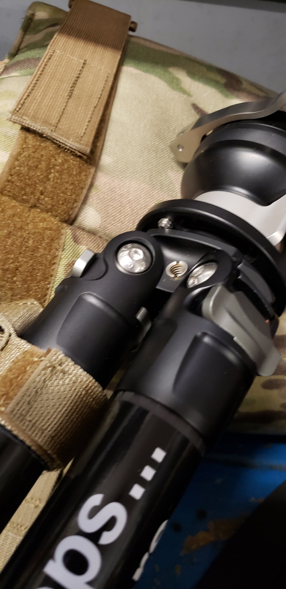

For the tripod, I chose the Leofoto LS 324c. Combined with the Really Right Stuff Universal leveling base, this setup is a few grams shy of 4 pounds. Folded up the total combined length is 22 inches and 3 inches in diameter. The combined LS 324c tripod and RRS head is a perfect fit in the included case. Extended all the way out, it seems to be a good fit for me to shoot from when standing. I'm 6ft 1inch and right at the edge of not having to bend over to shoot standing. If you are a giant, you may want to look at the LS 364c if you do alot of standing shooting. With the legs spread out and closed in, this tripod with the head puts the bottom of your rifle at around 6 inches (same as a low bipod). Perfect
The quality of this tripod is definately a step above the Innorel, but so is the cost. So, that should be expected. I paid $255 for the tripod. It includes a carry case and spiked feet. The leg can be adjusted with only about 1/8 turn of the collars. Very smooth and quick. The leg angle locks are also solid. Overall the fit and finish are great quality on the Leofoto tripods.
For the head, I want all out with the RRS universal leveling base for $300. I looked at some cheaper options, but in reality, nothing comes close. It was worth the premium to me. There are plenty of reviews on the base, And most everyone agrees. My only gripe/wish is that Id like to see this made dual purpose for both ARCA and PIC rails. I really like the butterfly tension knob much better than the bowl models with the handle that sticks down. This head easily locks my 20 pound rifle down solid, with a quick twist. I debated on this head vs an Anvil30 because I was worried about the limited movement with the leveling head. However, I quickly saw that 15degrees of movement is more than enough for my use.

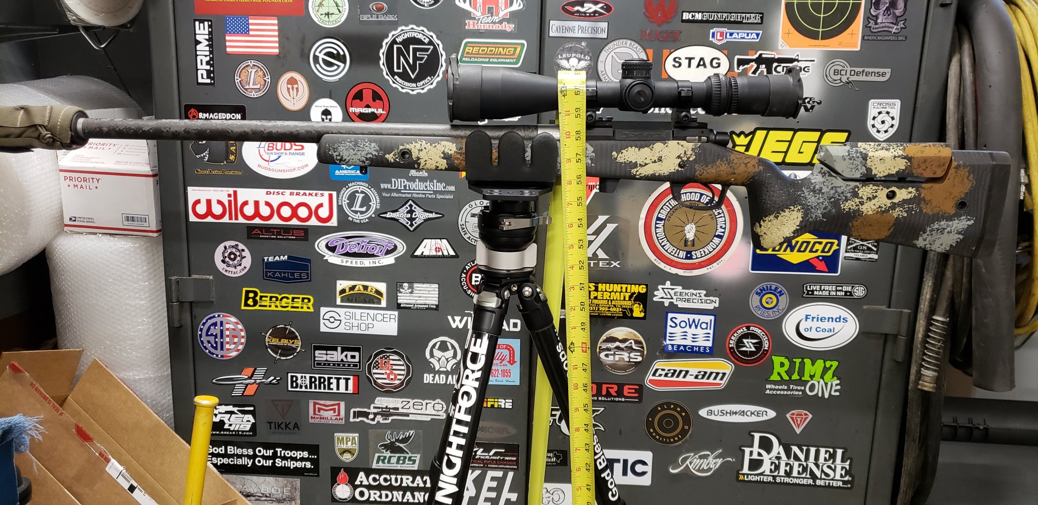

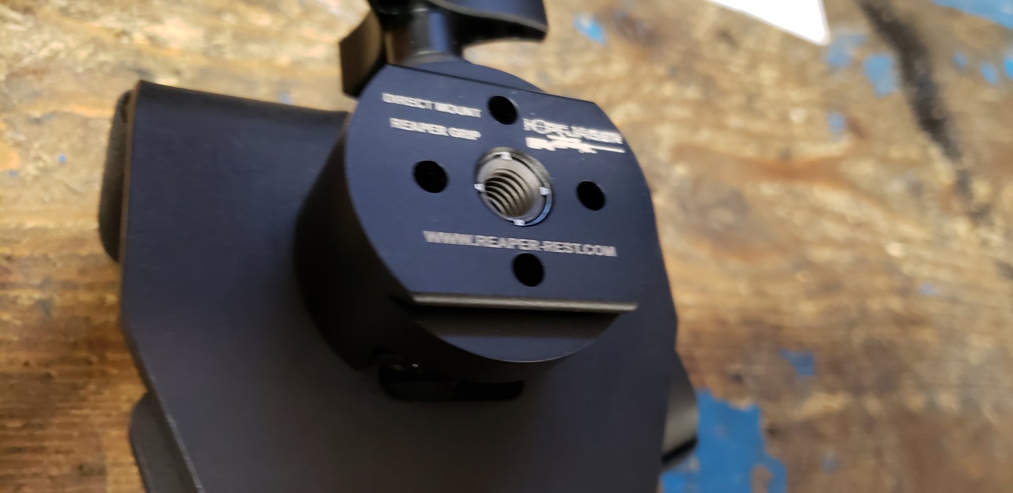

Not all of my rifles have an ARCA rail, as I dont want them to. In my opinion, a metal rail on bottom makes certain rifles uncomfortable to hold. So for these rifles, I wanted a vice head to use with the leveling base. I chose to use the Kopfjaeger Reaper direct mount rest. These have an Arca rail machined into the base, so we dont have to use crappy adapters. Very nice touch. Those guys are also an awesome company to deal with. I actually broke one of their older rests, due to my own negligence, and they went above and beyond to get it fixed. That's why I went with them again, when I decided to buy a direct mount clamp.

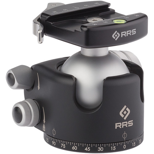

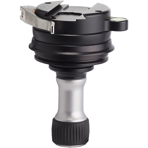

Keep in mind both were designed for photography/videography and adopted for use as a rifle support interface with a tripod.
Leveling base, as its name implies, is designed for create a level base between the tripod and whatever it is supporting. Its range of motion (tilt) is limited to 30 degrees (15 degrees in any direction - forward, aft, left, right). For most flat range applications, this is sufficient, and should you need more in any one direction, you can always change the length of one of the tripod legs. The leveling base passes through the tripod head, so it won't work on a tripod with a center post. You'll also need to ensure the leveling base diameter will fit in the "bowl" of the tripod. The leveling base is locked into position by a twist handle below the base, making it quick and intuitive to use. The leveling base can be partially tensioned allowing movement with tension that holds the mount in place, but my experience has been that with repeated left/right movement the leveling base will tighten or loosen. Leveling bases tend to be about half the cost of a ball head.
A ball head mount comes in two styles. The original photography designed version (BH-55 shown below left) and the recent RRS lever lock ball head (Anvil-30 shown below right). The original style offers more flexibility because it usually separates the panning movement from the ball head movement. So, you can lock the ball head in any attitude, then pan left/right with little to no drag. In my view this makes it a better platform for your primary use of mounting binos. The lever lock Anvil-30 allows nearly the same range of motion, but applies tension/locks through a single lever. RRS truly innovated with the Anvil-30 bridging the advantages of the leveling base with those of the ball head.
The ball head mount sits above the tripod head which allows 45 degree range of motion (tilt) in any direction. The BH-55 has drop notches which increases range to a full 90 degrees (vertical/straight down). The BH-55 ball head is the gold standard for photography for these reasons. Far more motion than you need for shooting or spotting, but for glassing it is a joy to use.
One note about the leveling base. Because it is tightened via a screw in the same axis as panning (left/right) - repeated panning can tighten and loosen the tension. This isn't a design flaw, it was never designed to move at all after being moved to level - it's original purpose. Nonetheless, it is an effective interface between rifle and tripod, just has its limitations.
