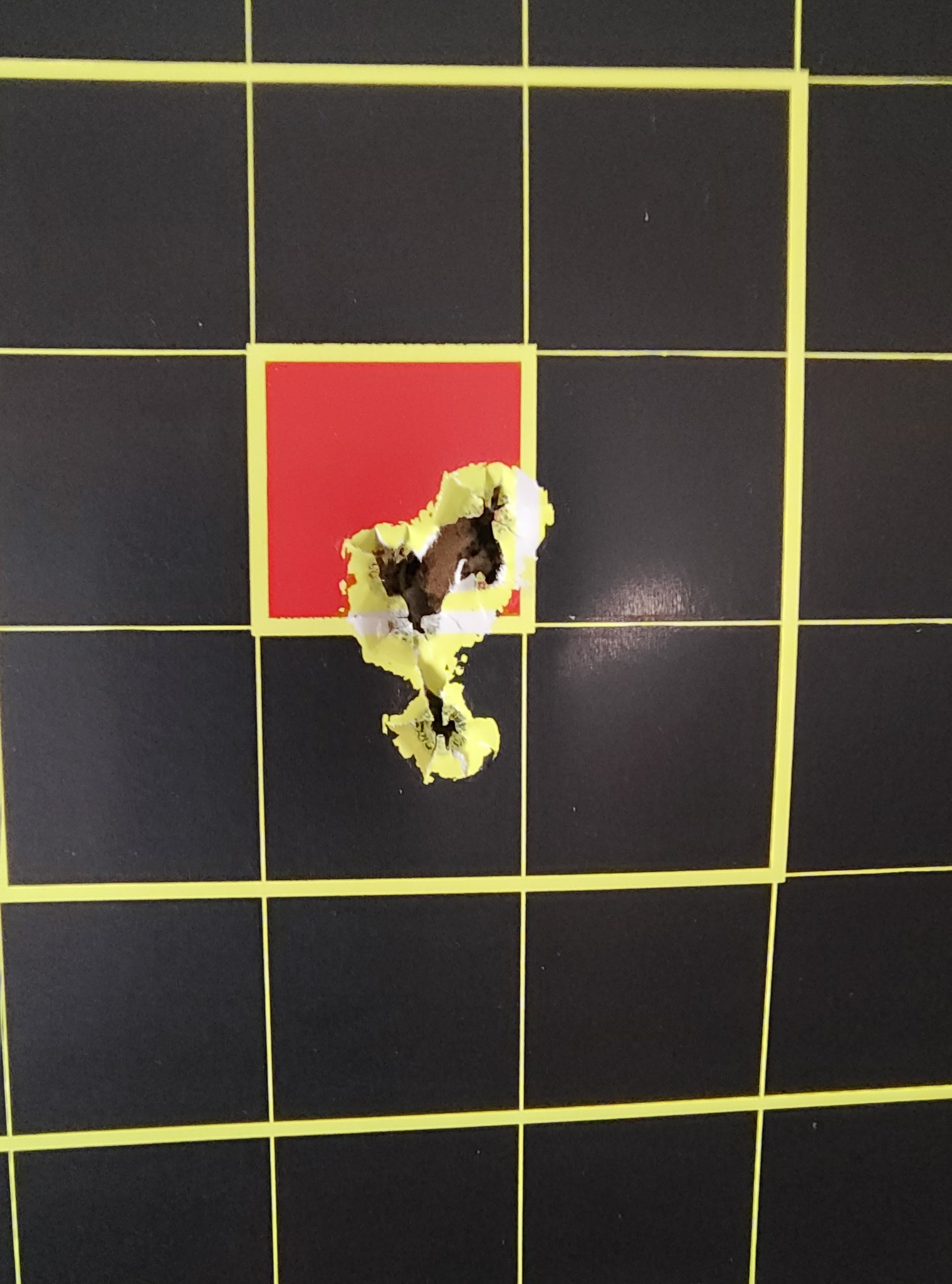

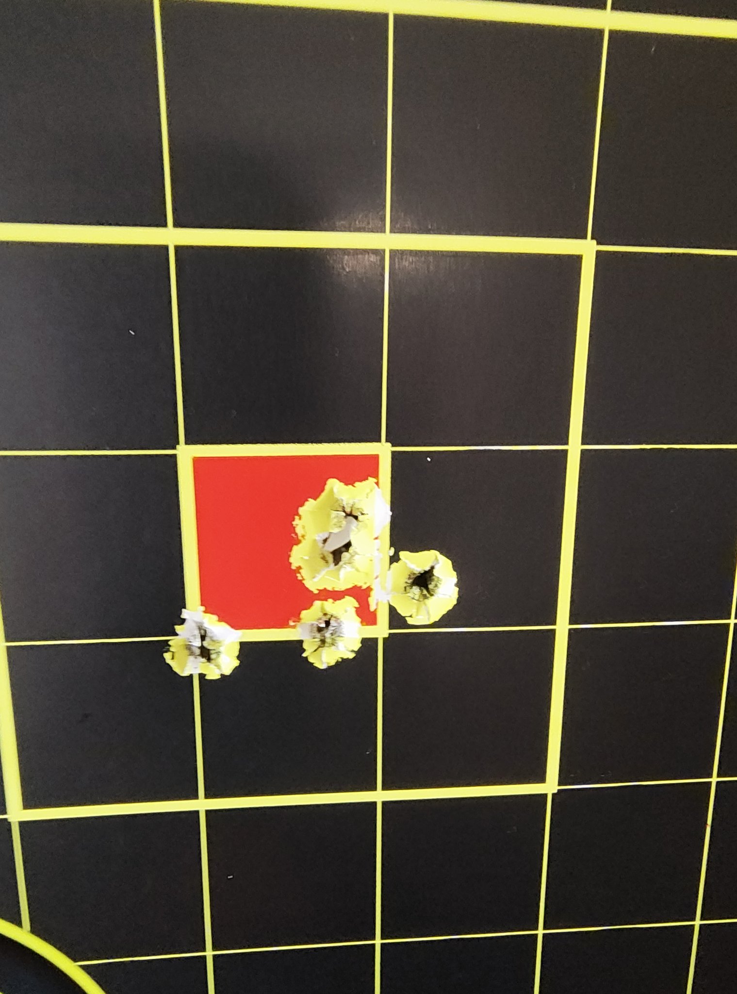

Well thanks to all who responded to the thread but I'm going to try some things before I cry rape. Start with rifle I know is dead on accurate, make sure of my mounting,try to zero at 50 yds try lower magnification then I'll let you know what happens thanks again
Well I mounted it on my model 93 wmr with new rings that I lapped, wanted to upgrade my rimfire scope anyway and I think it worked here is 5 round groups @ 50 yards I'll try farther out later
