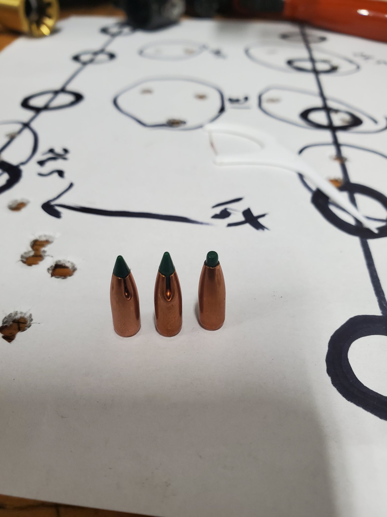

I have had good and bad. Mostly good though. I dug these out of about 700 39g 20cal bullets.
