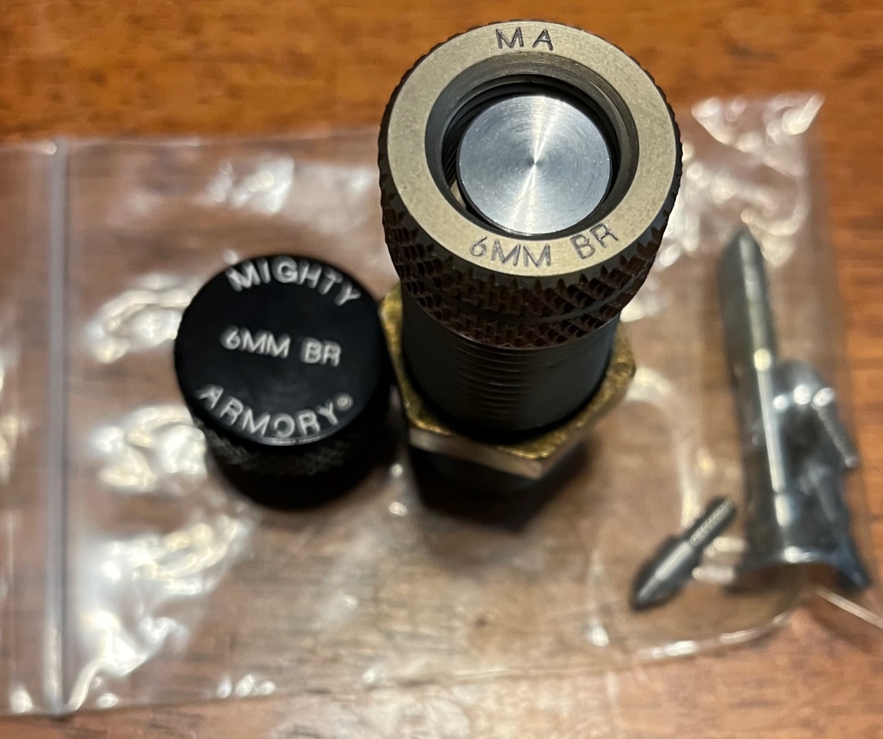

    Mighty Armory Gold Match 6mm BR FL Sizing Die
    Might Armory 6mm BR Gold Match FL Sizing Die in great condition with extra set of decapping pins
    This will run you approx. $135 with tax/shipping.
    $89 Shipped to you, PayPal F&F
