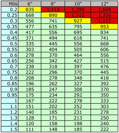

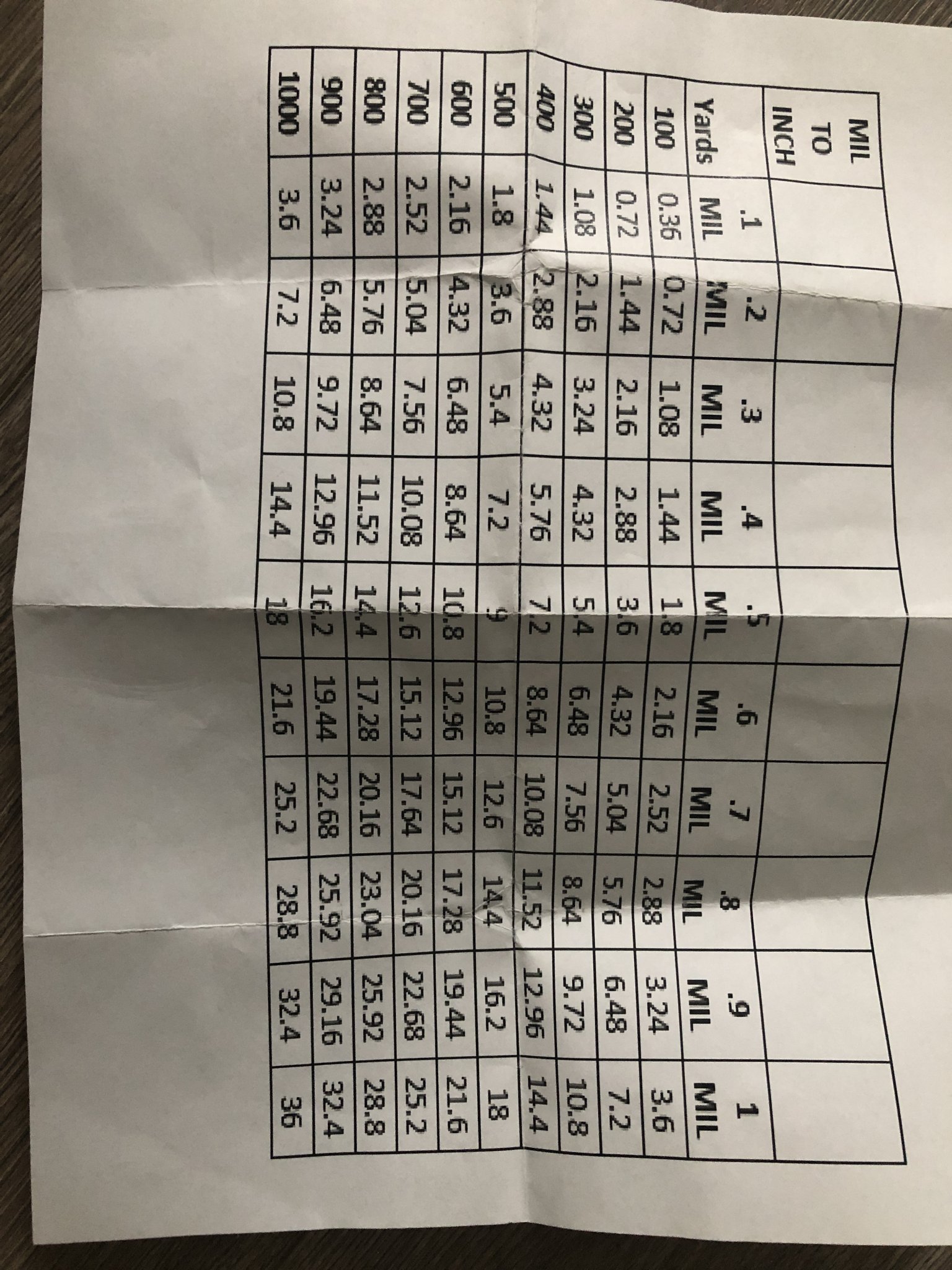

I'm not asking for an inch value. I don't think you understand what I am asking. I'm saying that if I know that something is 6 inches, how many mills would that equal at a hundred 200 300 400 500 etc.
Basically a way to quickly range a Target without a calculator.

Inchesx27.78/mils=distances in yards.
Since one mil is 3.6 inches at 100y then 1 mil at 200 will be 7.2 inches (3.6x2). To be 6 inches at 200 yards target the target would be between .8 and .9 mils.
A calculator or building a reference chart is your best bet. Lastly, as already said, this has no practical purpose besides just to know, or maybe just thinking about probability? I don’t see anything wrong with having a understanding with your equipment, if that’s what this is about.
Edit: just saw post above. If range is your thing then just make a chart. The further you get out and closer to your danger space the less accuracy a mil calculated range will work.

The short answer to your question is yes there are apps out there to do the conversions (turning your shooting time into homework). What Lowlight is trying to tell you is that your Mil reticle is a ruler. You measure in mils and correct in mils - no math required.
If you absolutely insist on doing homework there is an app call Mil Dot Ballistics that will give you HOURS of enjoyment converting target sizes to yardages and more. After spending time with this you will learn that it is a huge time suck even if the curiosity is worth it.
