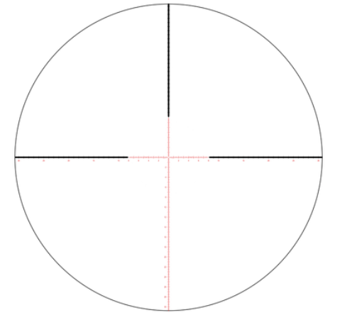

Since you never really posted a picture I am guessing you meant something like this (aka no X-mas tree):
Which happens to be a very popular choice on one of the most popular scopes currently (ZCO--reticle MPCT2).
Or the OG:
Or the OG:

The reticle is fine--As far as ranging, welp thats all on laser rangefinders. DOPE has moved to kestrels (*cough* cell phone *cough*) and such but there is not subsitute for actually collecting data.

Like others have said there’s nothing wrong with a mil dot scope at all. However, there’s a reason that almost no one that shoots professionally (whether at people, animals, or targets) uses one anymore. Using a more modern Christmas tree style reticle means that you can spot and adjust fire on your own when you miss, using the reticle as your ruler. Also, if needing to hold both wind and elevation it’s way easier. I would give one a fair chance and see what you think.
Sorry if this is the wrong place to ask this question—Is the mil turret/mil-dot reticle an out dated system? Would the above reticle in a 4-14 FFP, and the “mild-dot-master” be a contender in today’s world or a relic of the past?
Reticles are rulers
Mil dot reticles are difficult to read rulers
Hashmark-style milliradian reticles are easy to read rulers
Same units of measurement, one of them much easier to use than the other
