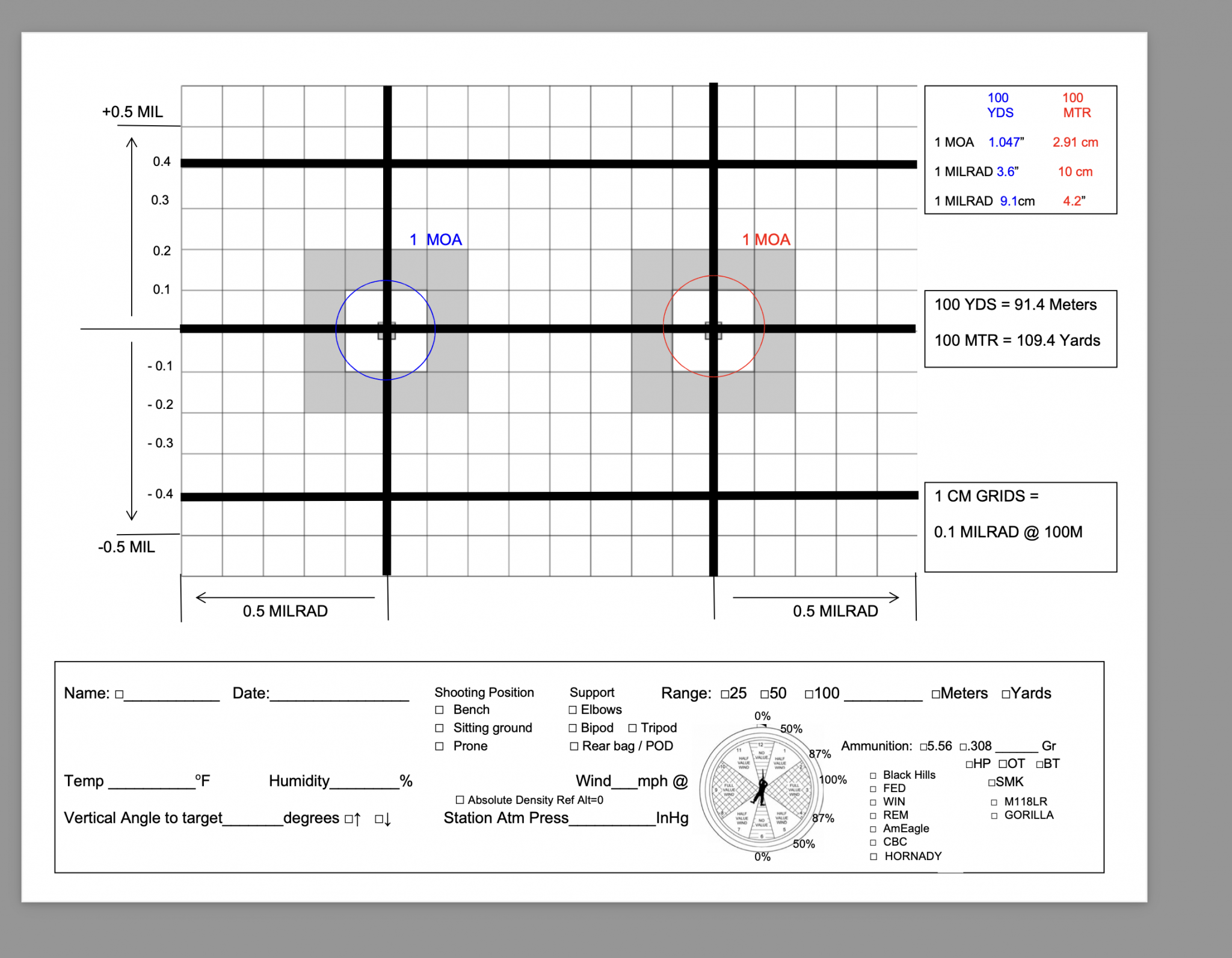

MS Excel
I configured this one many years ago. Print out the PDF on 8.5 x 11" ; the grids are 1 cm accurate.
  • LaRue Target Modified # 14 MJD Email SNH 2023 copy.pdf
