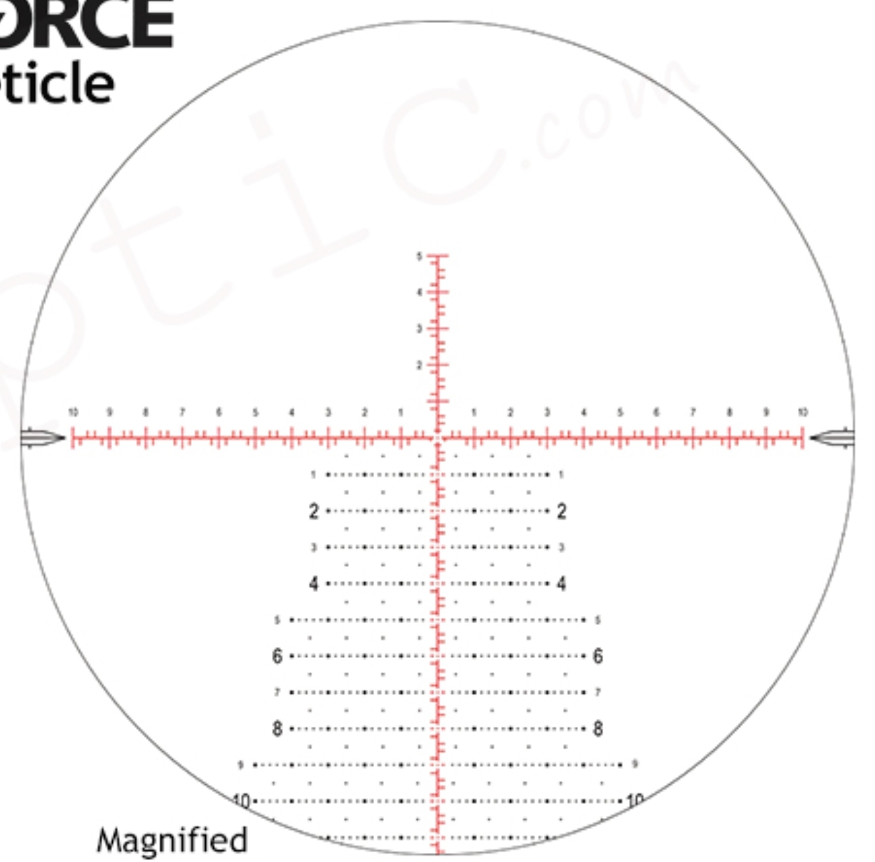

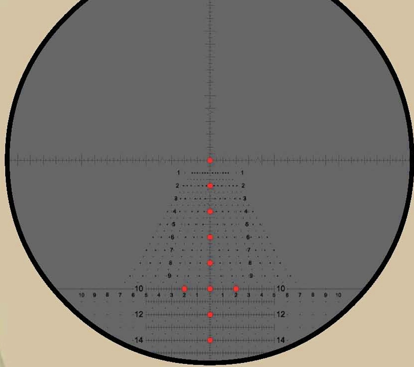

    I have both in 7-35 and I like both. I like how clean the mil-xt is to spot your shots. I like the tremor 3 for wind holds. I am still trying to figure out which one I like better. They both have their pro's and cons. For a hunting reticle the mil-xt would be less cluttered. The illumination on the mil-xt would be a lot better since it is essentially a mil-c that illuminates. The tremor 3 Illumination is just dots. As you can see in the pictures.

    I have 7-35's in both the Mil XT and Tremor 3. I was able to spot shots in the grass at 600 yards with the Tremor 3. It's not as cluttered or difficult to spot shots as some make it seem. Having said that I like the Mil XT more. The wind dots are not needed once you know the wind value of the cartridge you're using. I initially went Tremor3 because NF had very limited reticle options at the time.

    Mil-XT is where it’s at.
    Does everything the T3 does (obviously), but in a cleaner package. Even when money isn’t a factor (#StupidHorusTax), the Mil-XT wins in my book and I can’t see myself going back to Horus.

    I think both are great in there own right, but personally I much prefer using the MIL-XT. Plenty of intelligence without being overly cluttered. That's basically the gist of it for me.
    Similar experience as many above. I started with the T3 and ended up with the Mil-xt. My use is mostly 1k-2k shooting and the Tremor 3 was just too busy at magnification above 25x for me.
    I like the Trm3 more. But I can understand your side. There is no way these are "cluttered" if you are using the correct magnification. I think the more you shoot the more you like the Trmr3. Those wind dots are money the second you figure out the value for your rifle. Gone are the "lets hold left edge and hope and adjust"
    I like the tremor because you can learn it and then find it across scope brands, I have nf, vortex, and luepold scopes and they all have the same reticle. Each scope serves a different purpose on a different rifle. It’s a nice feature that maybe most people don’t think about about. You can have your 7-35 atacr on your mag rifle, and if you’re like me a 3.6-18 mk5 on your 16.5 shorty 6.5x47. It brings familiarity. But I guess you could just stick with nf across all your rifles too, lol.

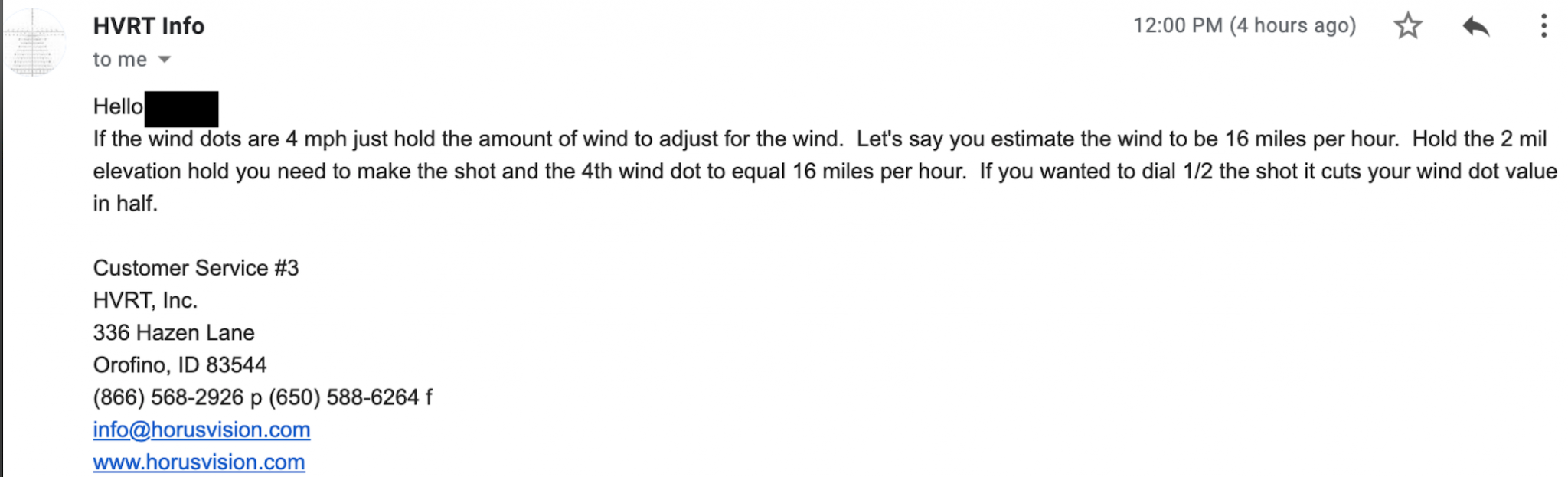

    Do the wind dots work the same if you dial instead of holding or do the values change? It seems that I read somewhere that dialing was not recommended, but don't see anything that states what changes when dialing. Thanks
    Do you hold or dial? If you hold 100% then tremor 3, if you only do part of the time or dial mil xt
    Yes the wind dots lose their value when you dial. I emailed Horus about exactly this when I almost bought a scope with a T3.
    Edit found the email

    And what’s the math if you dial for the full shot 1/4? Is this the same no matter how much is dialed as well. 500 to 1000 is a bit different. Thx
    I do not know. After I saw that email I crossed the T3 off the list.
    I was originally under the impression that dialing 5 mils you half the wind dot value (from 4mph to 2mph) and dialing 10 mils you quarter the wind dot value (from 4mph to 1mph). For example, if I needed to hold 7 mils I could dial 5 mils and hold 2 mils, but my wind dot values would be halved.
    However, from the email it sounds like it is shot-specific - where dialing half the shot halves the wind value.
    Can anyone clarify?
