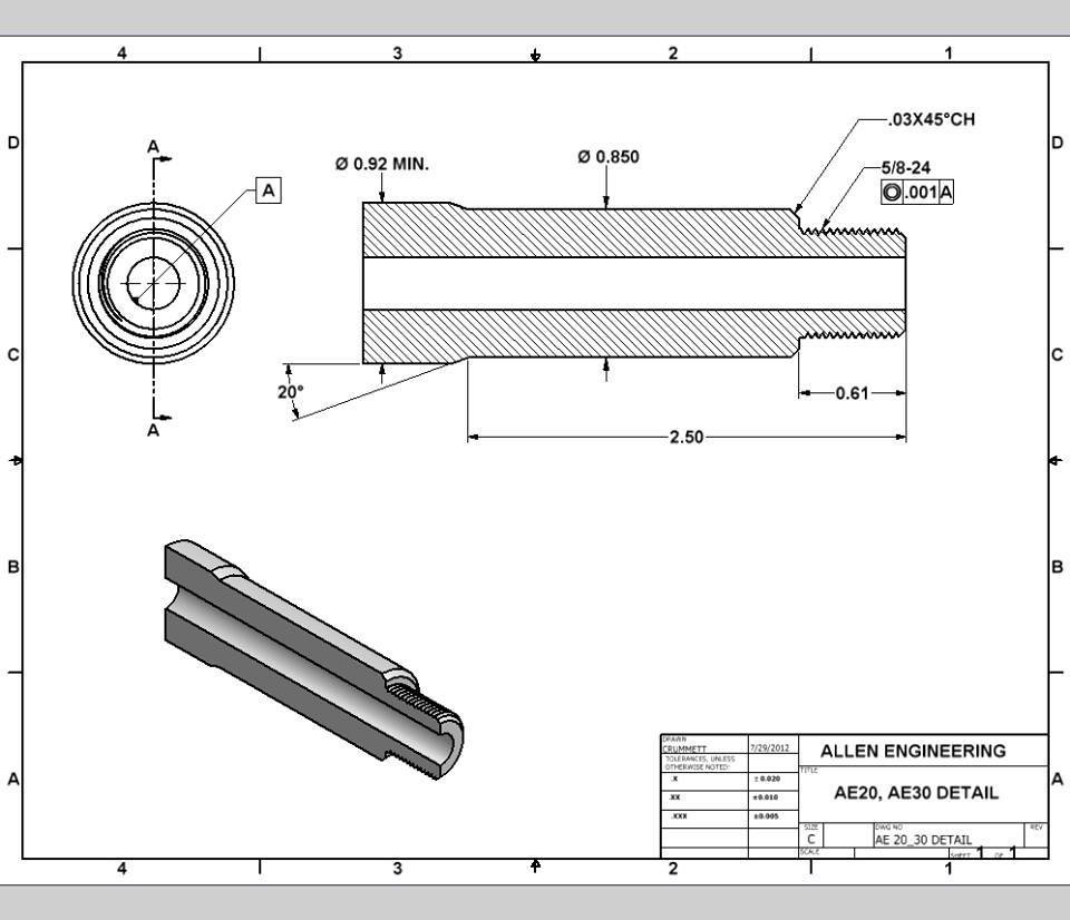

It’s a shame Ron turned over everything to the new Allen Engineering folks, they don’t have the prints up. What you ACKSHUALLY want is your barrel turned to AE30 specs, with the taper machined into the barrel. No collar at all so the can threads onto the AEMB and abuts the taper to locate itself. I did this with my 6mm ARC.

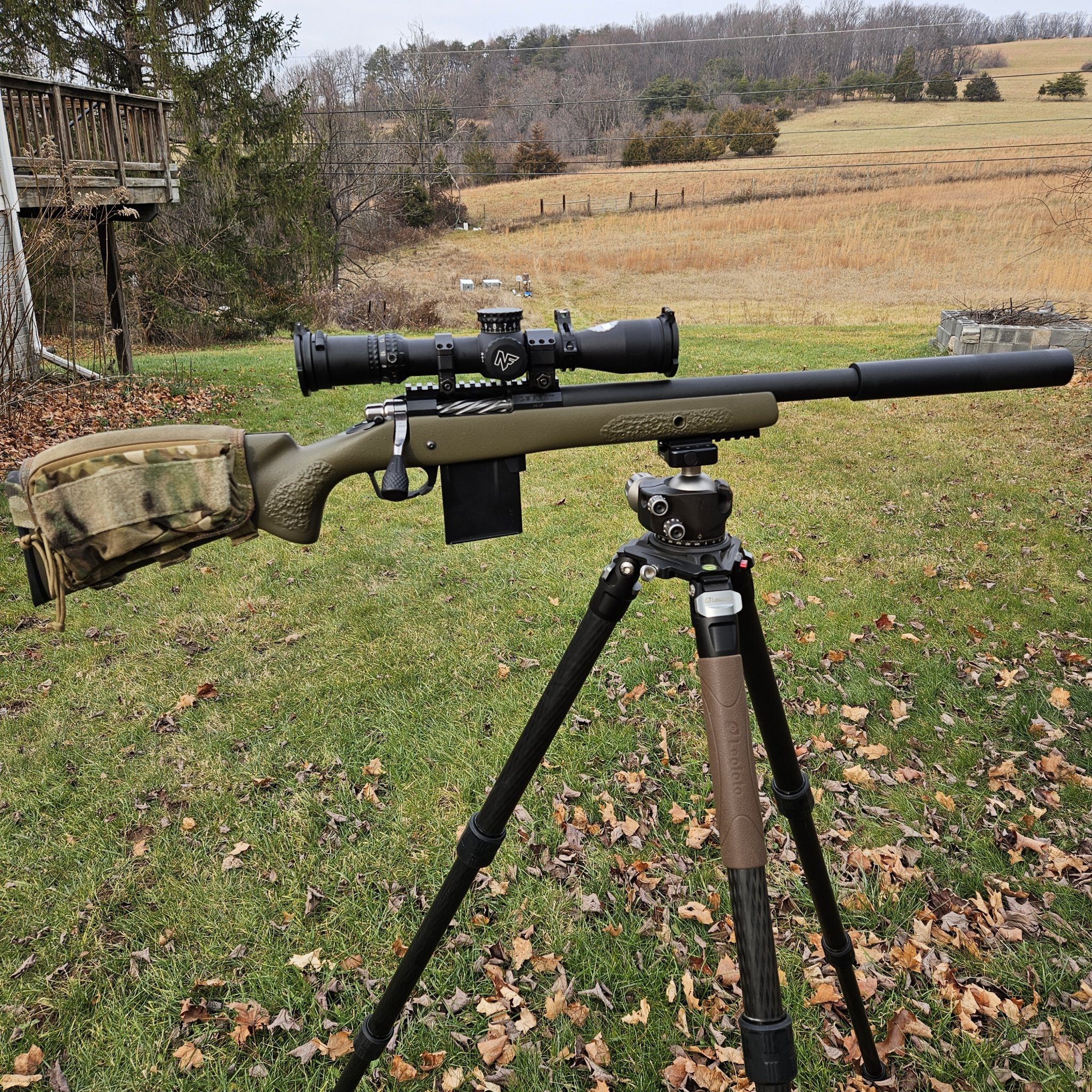

It's mine. Get ahold of Ryan and he'll do an awesome job.

There’s prints out there in the ether, this is a gap#7 profile barrel, it had plenty of meat beyond the taper. My cans are original ops inc though, may verify the newer cans are same specs as the old ops inc cans, I have no clue
You’re the guy that’s about to cost me a lot of money!!! I seen this on Reddit and was aroused.
As far as your questions go.
1: I have no idea on the 22 arc barrels if you are looking for pre-fit. Ryan does chamber barrels but IDK if he has a 22 arc reamer.
2: According to most prints I've seen .920" is the minimum diameter you need where the taper starts.
3: No issues for me yet
920 is perfect. I can make that work!
What’s your rifle weigh if you don’t mind me asking?
