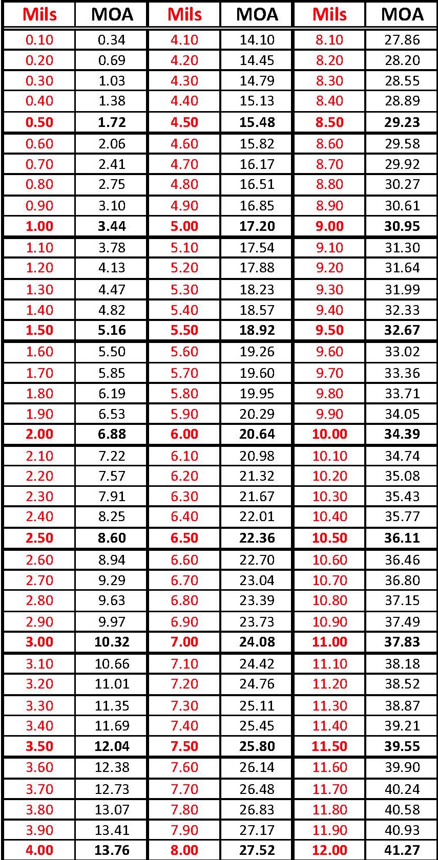

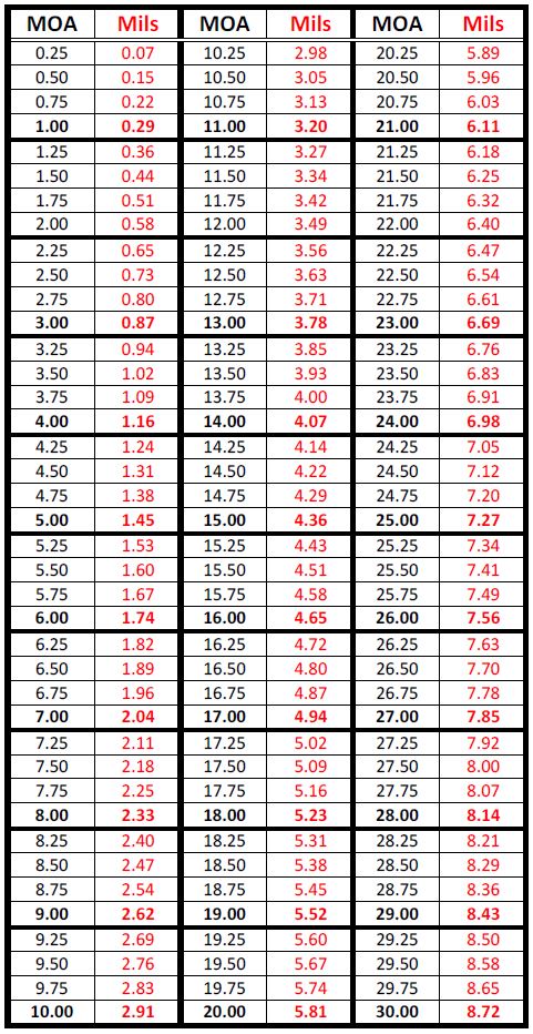

Q: I’ve seen most spotting scopes are MRAD/Mil Reticle, correct? BUT my 2 rifles have NF MOA turrets&reticle, so if spotter is calling adjustments from Mil reticle spotting scope what’s the math back to MOA scope?? I don’t need MOA to mil, I need mil to MOA.

Thanks brother that helps a ton. That keeps me from trying to go out of my way in spending money on a MOA spotting scope or conversion kit.
@ivillarreal Attached are a couple PDFs you can print for reference or save the jpgs to your phone. Or make your own. Or buy a table from someone else.
