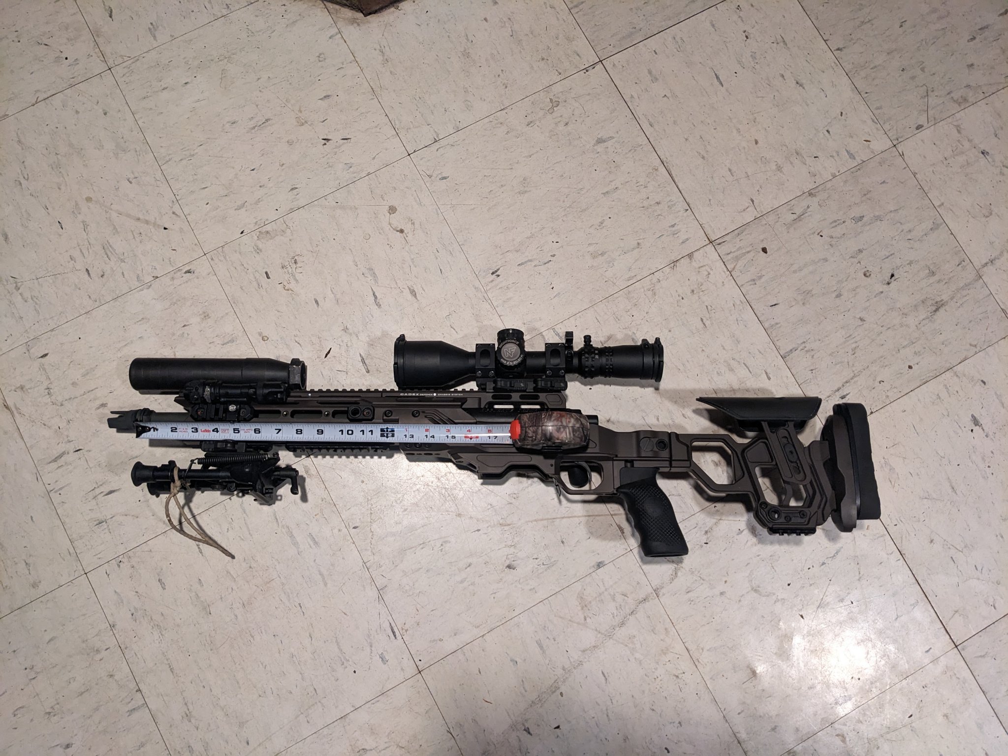

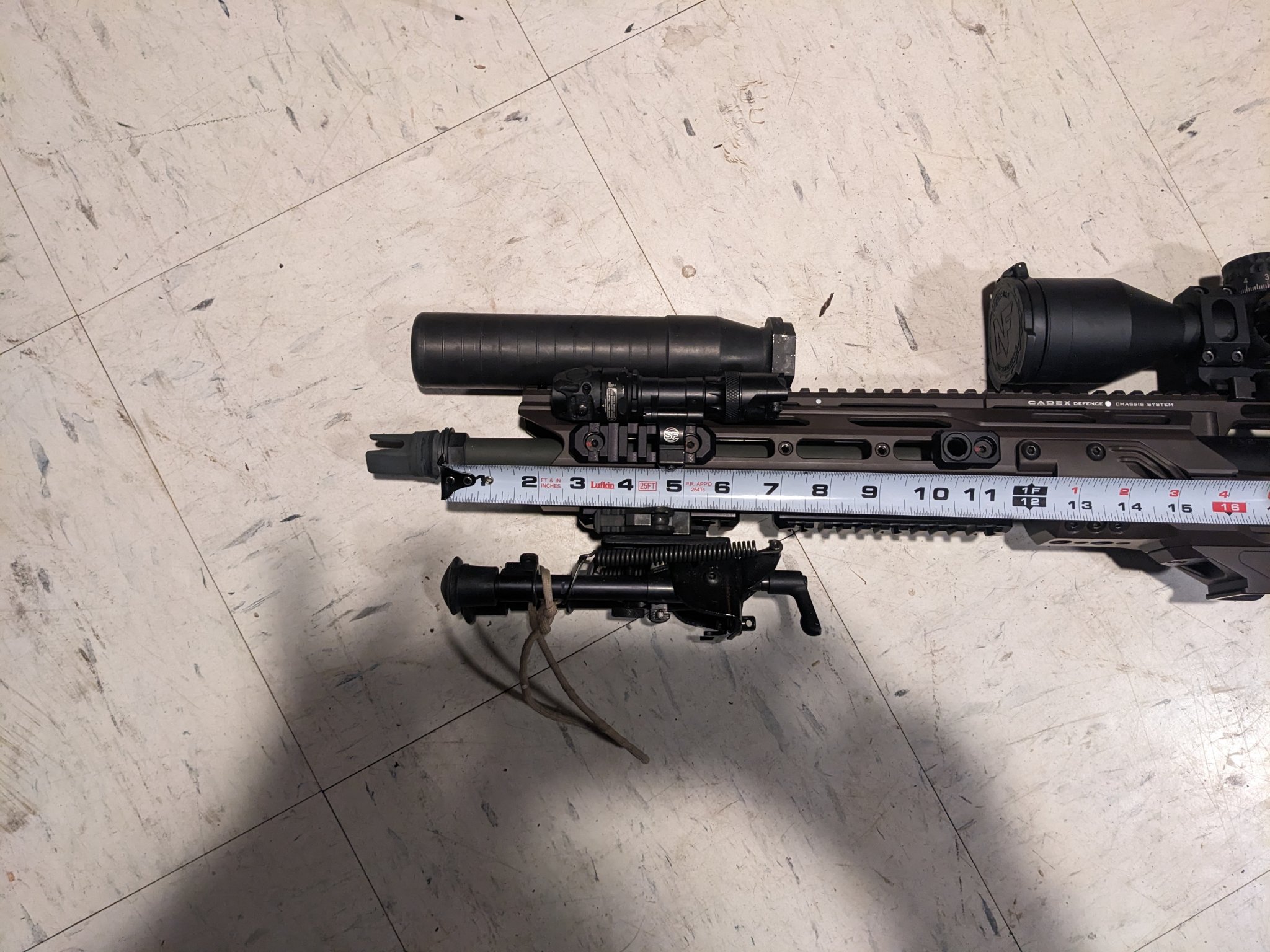

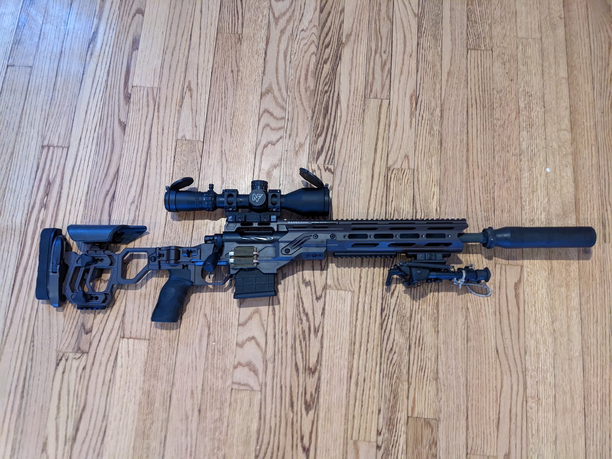

I found an Accurate Ordnance 223 action on here and had a 300Blk barrel spun up. It is a Stiller clone and I also see Stiller Tac30 actions with 223 bolt faces fairly frequently.
If the price hadn’t been so attractive (I think I was into the action with a trigger and a few mags for $700ish), I would have bought an action that can take prefits.
I love my 300Blk bolt gun. If I wasn’t so lazy and loading on a progressive setup (getting low teens for an SD), I think I could get repeatable hits to 600 Yards with subsonics. Right now I can get consistent hits to 400-450yds and then start dealing with elevation issues from my ammo. I am going to spin up a batch trickling powder by hand for shots past 400 yards and see if I can get the SD down to 2-4. I have a 20MOA rail on the Cadex plus 30MOA from the ADM mount. That leaves me with just over 28 mils of elevation travel inside the NX8 2.5-20 (34 mils of internal elevation travel) using a 50 yard zero.
It is a 1 hole 5 shot group at 5 yards kind of gun with a Wilson barrel. About to chop it down to 8-9” to tuck the can inside the handguard.
Shooting this gun is like shooting a bigger 22LR. Just as quiet and without the pain of wind deflection at longer ranges.

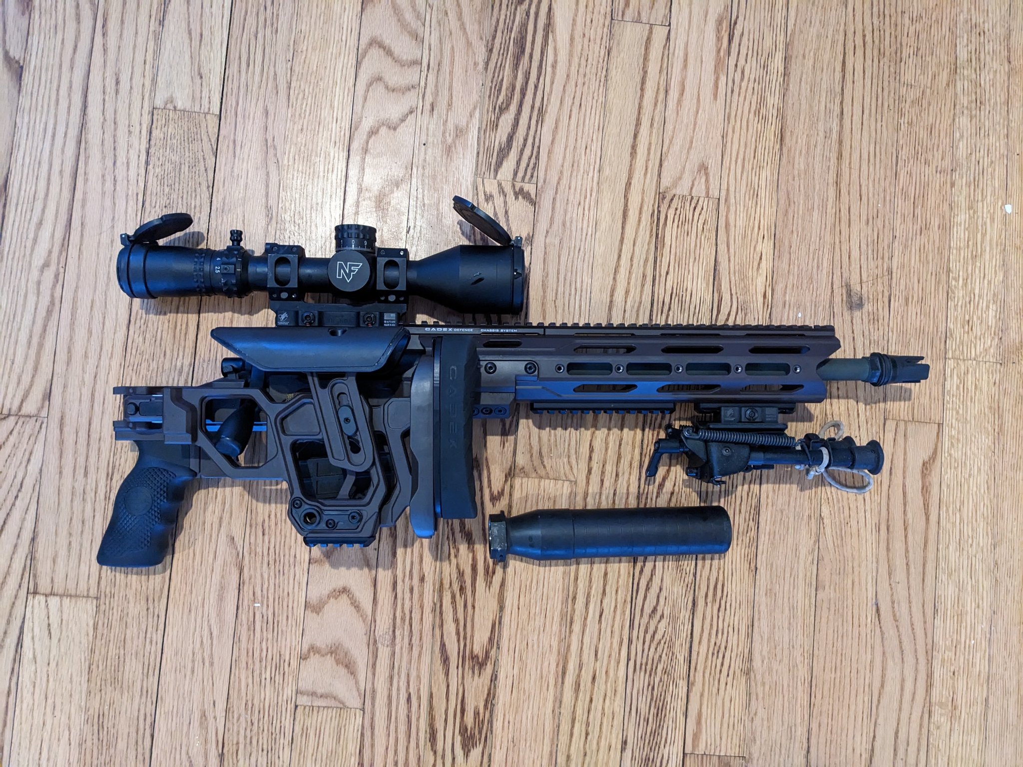

This is very very similar to how I want my build to come out. Going the direct thread version of the SRD762 Ti versus your QD, but that's pretty much the only difference. Great looking build and appreciate the ballistics datapoints.
Out of curiosity, what's the minimum barrel length you think that you need to clear the end of the handguard?
Reactions: NHPiper
Because I have the QD can, I will thread the suppressor on to the muzzle brake and then thread it on to the barrel. To have about 1/4 of an inch sticking out of the hand guard, I think I’m going to have to cut it back to about 7.5 inches. I’m worried that’s going to be a bit short, and may mess with the velocity consistency. I think the direct threat Ken might be a little bit shorter since it won’t have a muzzle device sticking out the back, so you can probably go with a barrel that is closer to eight or 8.5 inches. I can take some measurements when I get home and post the pictures.
it’s going to a 8.5 inch barrel resulting in better SD/ES, I would probably take that trade off.
let me know if you need the load data, I can pass it along once I look it up. I guess I’ll probably have to bump the powder charge by 0.5 to make up for a short barrel. I buy the bullets from the Nosler surplus store and get a bunch of factory seconds for something like $.20 per bullet.
Reactions: overmatch

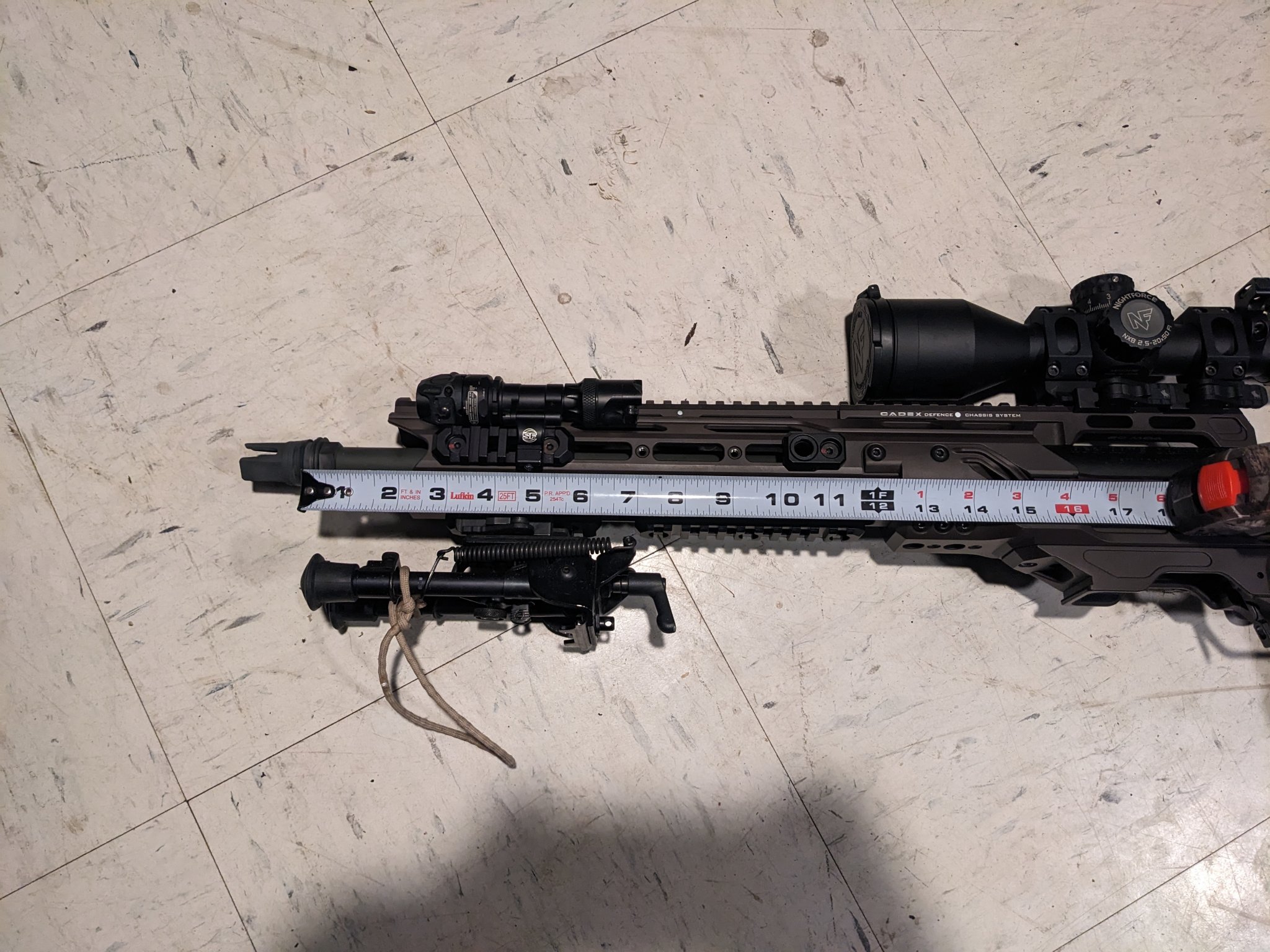

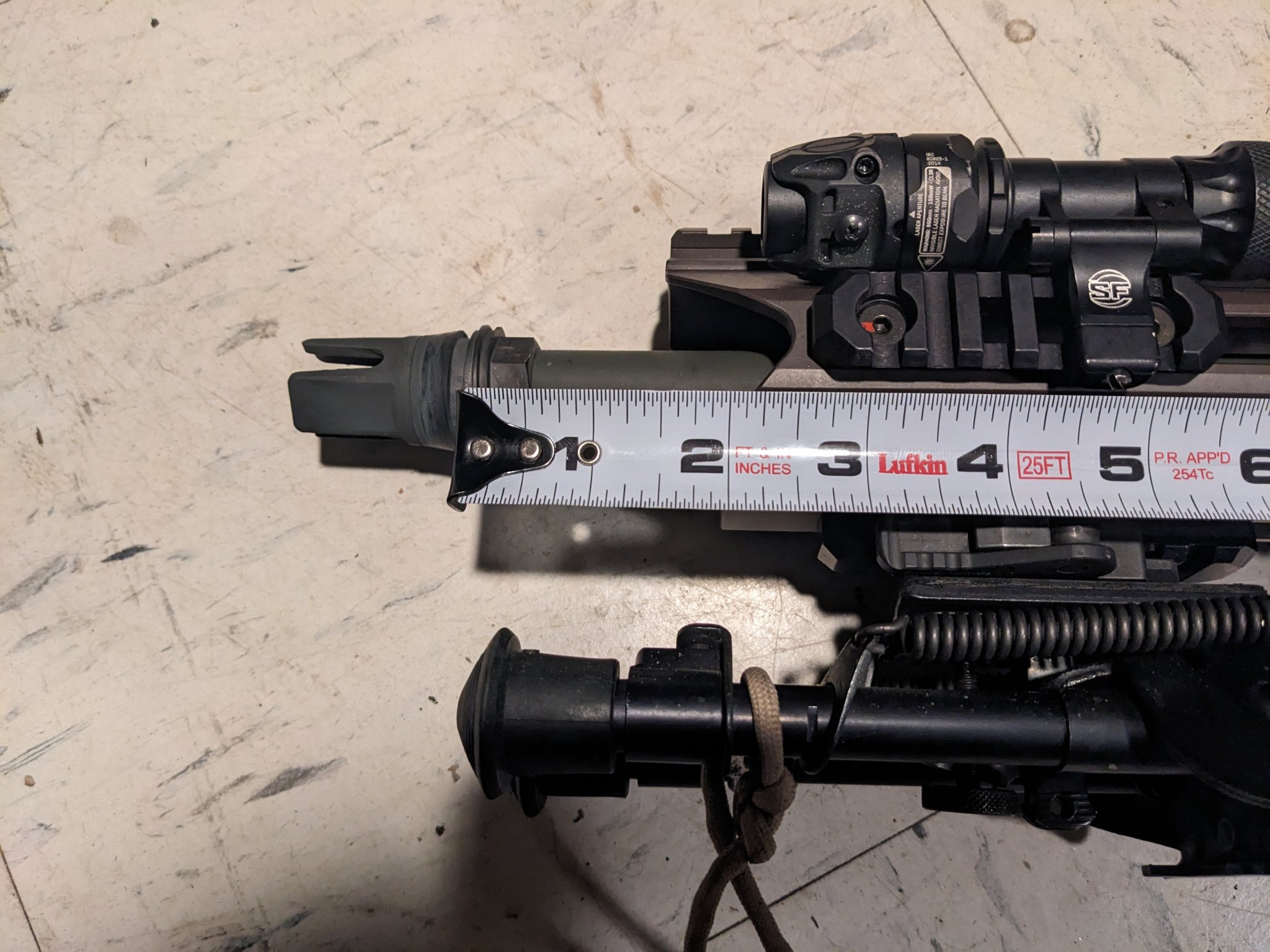

Sorry, should have clarified. On the Dual Strike with your action, how long of a barrel do you think you'd need to clear the end of the handguard without any suppressor?
This is a 16" barrel. I wouldn't go shorter than a 15"
If your threads are 5/8" long, then the threads will go back to about 14.5" on a 15" barrel which is directly under the top of the handguard. So the back of your muzzle device, once screwed on, would be directly under the top of the handguard.
If I cut this to an 8.5" barrel, the barrel + suppressor will be just under 16" in total.
