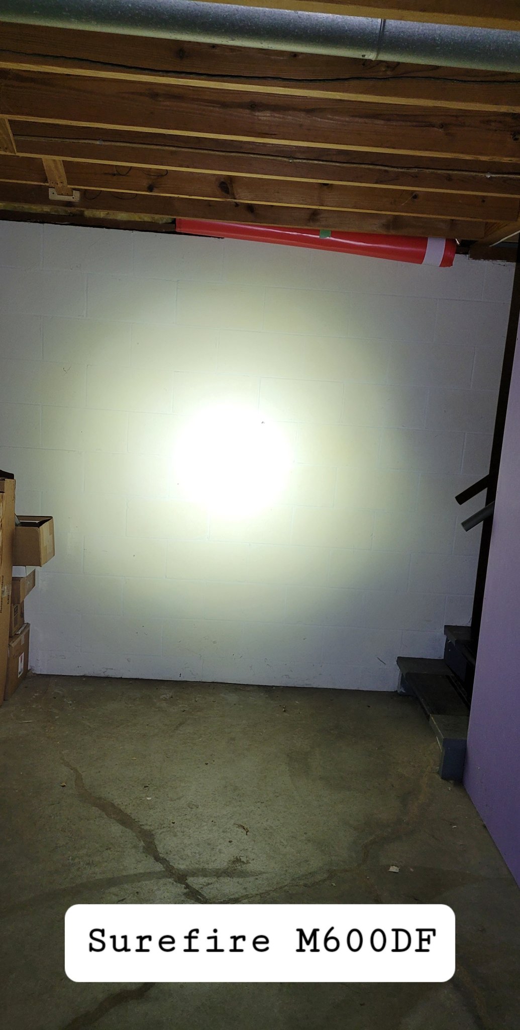

In my experience Modlite heads have a smaller hot spot but give a wider halo around it. I prefer the Modlight head to the surefire.
Don't forget the Cloud Defense.
I like the CD because they are duel fuel and will accept both protected and unprotected cells in 18650 as well as CR123.The REIN Micro can use 18350 protected or unprotected and CR123. Modlight reccomends protected only. The full size REIN is a power house with a combination tail and tape switch.
