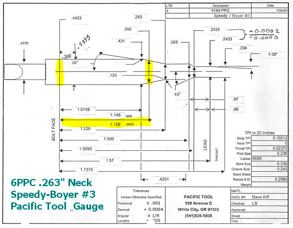

A rifle with "minimum head space" is only necessarily tight in that one dimension: the distance from the bolt face to the shoulder datum highlighted in yellow. Its controlled by how far the reamer was run in/how far forward the shoulder of the barrel was cut.
A chamber could have plentiful head space and be tight or loose in many/all other dimensions . Base diameter, shoulder diameter, neck diameter, neck length are all things dictated by the reamer itself, not just how far it was ran in. As an example, if someone was going to put brass in the ppc shown above they would have to turn the necks, factory brass wouldnt even chamber in it, because it has a tight neck. Typically when things are tight like that it is noted in the barrel markings along with the caliber to alert people to the potential issue.
So when someone says a "tight" chamber: tight in what way?
The minimum head space you are looking at could still have all of those other aspects of tight, it could also just as easily not. I would ask for some more detail into what it was actually cut to or with if you are concerned about its function for you.
