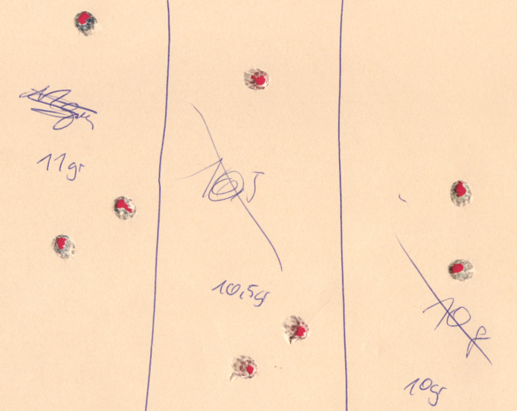

I was on the range today an I tried 220gr Sierra round nose bullets loaded for an OAL of 69mm (2.7165").
Rifle is a Ruger American Predator with 18" barrel and 1:10 RH twist.
(Smallest volume ratio was 65% due to quickload)
I did not shoot suppressed, because I was only looking if the bullets do "key holing" (or whatever this is called.)
Beeing no expert in this I at least was able to see that the bullets with 9.5 grain an 9.0 grain were not stabilized.
I also tried 10.0 grain; 10.5 grain and 11.0 grain.
That's how it looked at 50m (~55 yard).
Is this stabilized enough for shooting with suppressor, or is this still too bad?
(I did not shoot groups, I aimed for each shot somewhere else (looking back, I don't know why I did that...).

I don't think you have to worry about the 9gr keyholing... Did you run the 11gr over a chronograph? I'd say you are probably still a bit slow. My 16" AR took 11.3gr for 1057fps, and my 22" bolt takes 13gr, both with the 220gr Hornady. (COAL 2.752")
The 11r pics look uneven to me (not good). I'd try another set without can and make sure they are going straight... Uneven smears around the high and low and an uneven tear on the middle one give me doubt. Your call, but a can is an expensive thing to shoot...
So, after I was at the range I found out that my previous loads were much weaker as necessary. Quickload caluclated round about 50m/s (165fps) too fast. With this knowladge I could add some grans and was able to get a load Ratio of 80%+ with 12gr up to 13 gr.
YEAH!
To be honest, I feel much safer now with 80% instead of 65%.
