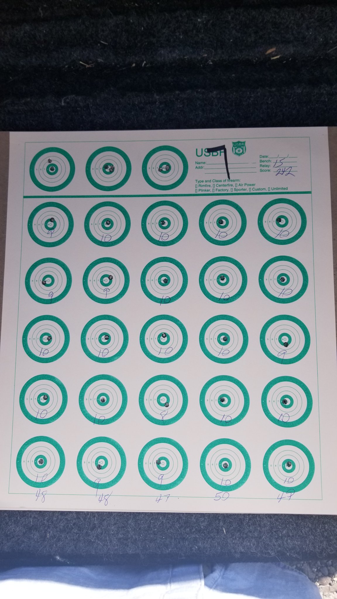

This target was shot @50 yds with a PST Gen1 4-16x50. So I can be done but definitely not ideal, agree with most others that more magnification is better. Currently using an Optika 6 5-30x56 and looking for more. Most benchrest guys use SFP scopes in the 40-60 range but I like FFP scopes for multi use. 0D99798F-E973-491E-9900-7695E58A3901.jpeg
Nice shooting AMTGMC. You are right more is better. When your trying to hold off of center by a 1/16 just to keep it in the center of the bull, you need to see it and realize that amount. Enjoy
