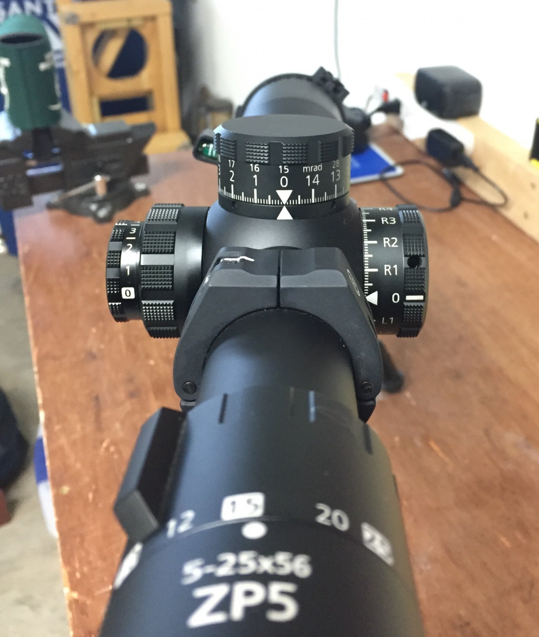

    Turrets - The knurling on these is very aggressive and takes some getting used to. I would also call them “low profile.” The clicks are very definitive and audible. There is no over-travel or back-travel. Although they are stiff, and require a good amount of force to turn, they are easy to use once accustom to them. The spacing is sufficient enough to tell exactly what tenth mil you are on. I do wish they staggered the heights, much like a tape measure, for easier use. I do think the turrets would be easier to operate if the turret was a little taller.

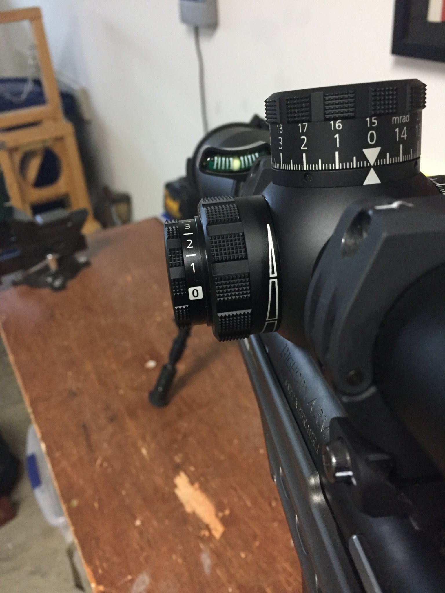

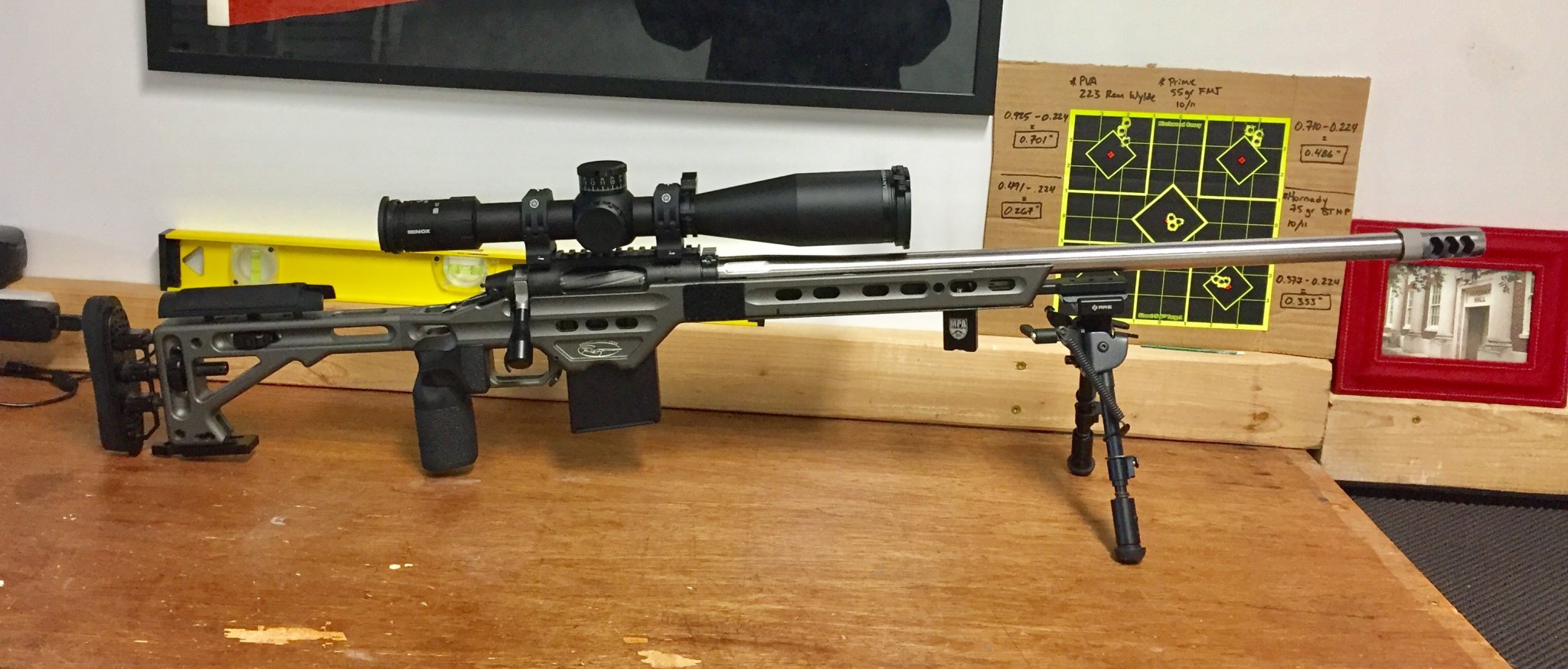

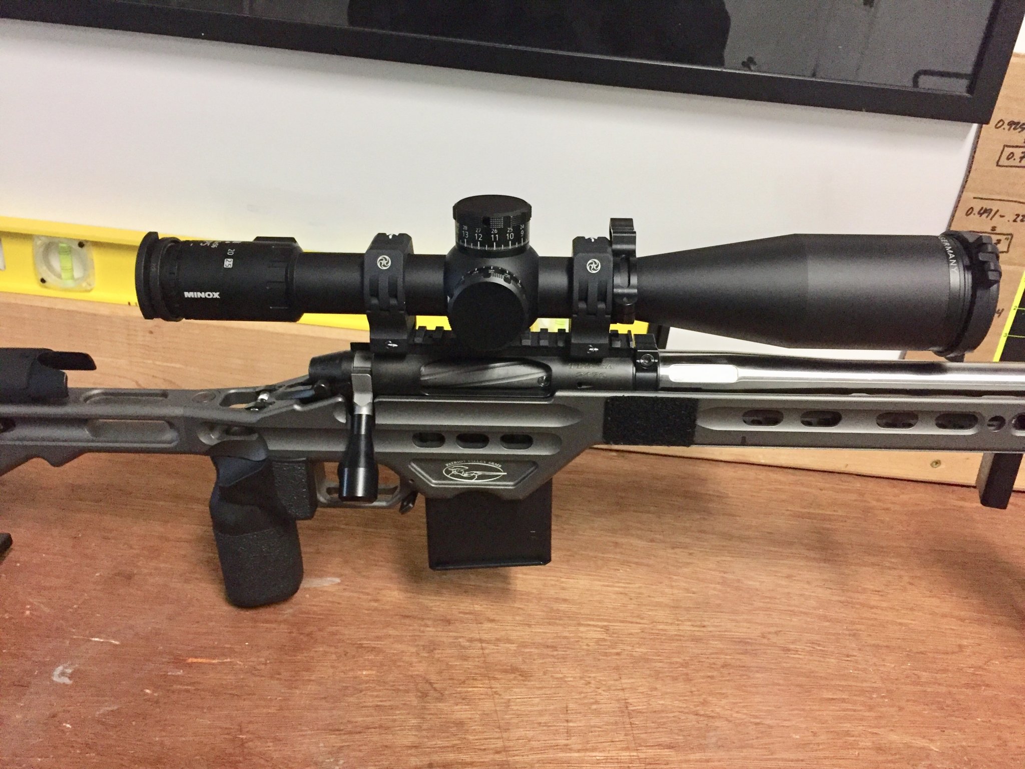

    Second Revolution Indicator - Two little boxes below the elevation turret turn white before you get into the second rev. I have a second gen model and the turrets are exactly how @CSTactical YouTube video shows them.
    Minox ZP5 Gen2 second rev indicator
