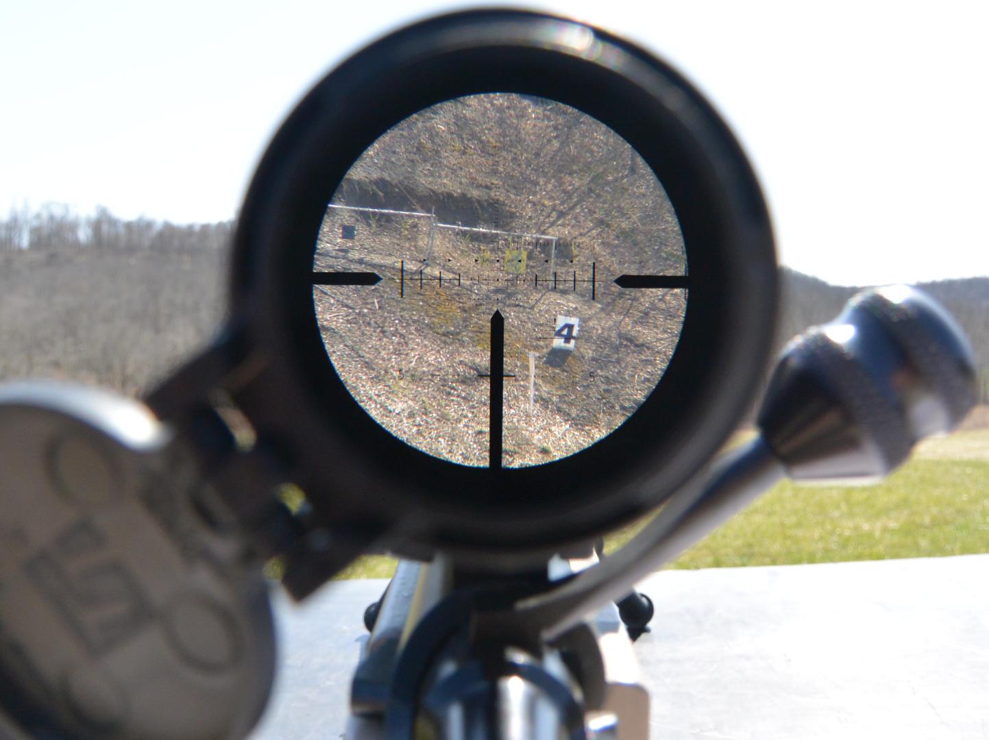

Hi guys! New to the forum, but have been reading here for quite some time.
Just want to share this as it seems this fellow countryman of mine has developed a new reticle for the ZP5 called “Hybrid”. Have anyone had a chance to play with it yet? I was set on getting this scope with the MR4 when I came across this video. Now I’m having a second guess.
Not comparable to anything I’ve seen elsewhere included S&Bs reticles as mentioned above. If anyone has tested it I would really appreciate some feedback. I’m confident it will be a brilliant reticle choice with regards to hunting, but I’m curious how easy it is shooting 600-1500 yards with this.
Interesting reticle and seems like you could do a lot with it. Better than MR4 for low power/hunting scenarios since the MR4 disappears on low power like most FFP thin/fine reticles. I would consider it if it was for a hunting rifle but for target shooting it's MR4 for me.
