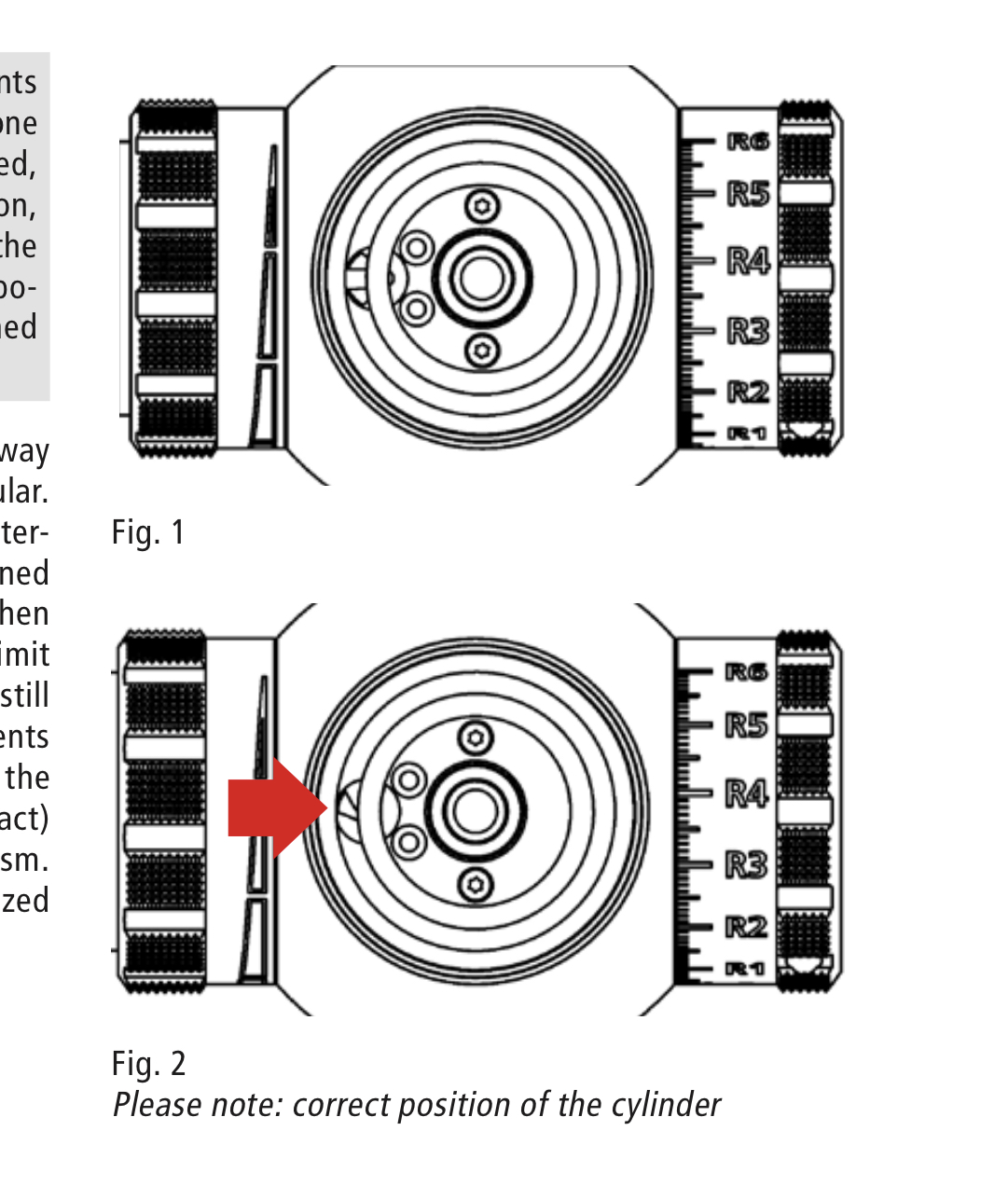

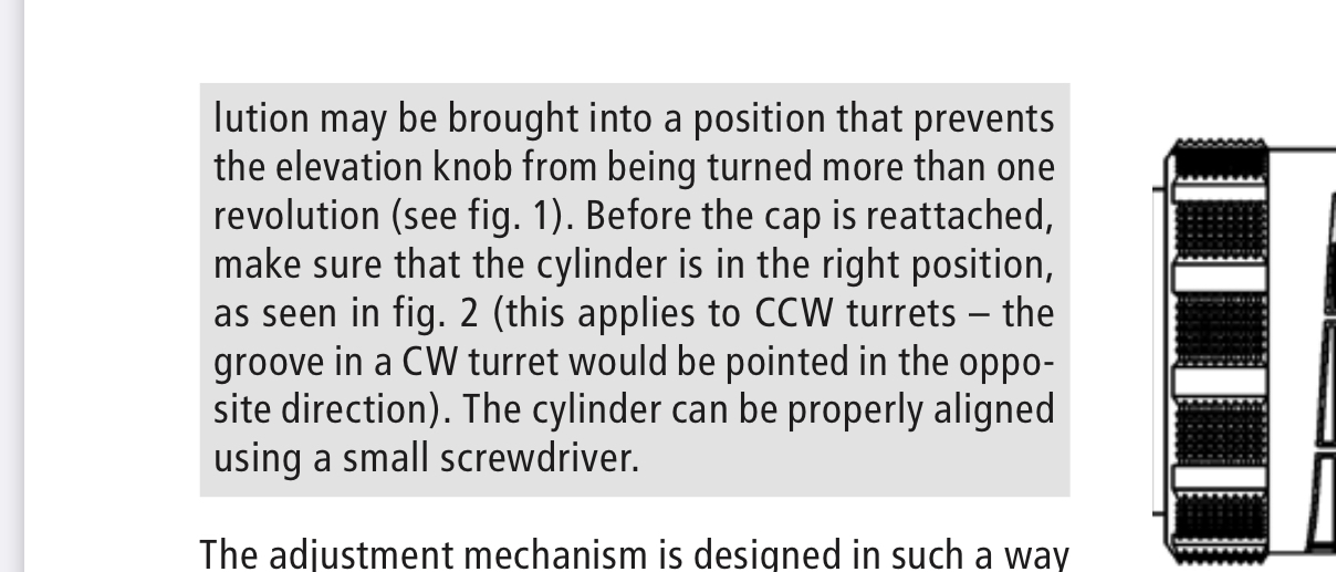

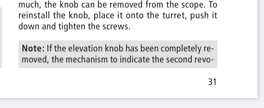

    On my scope, there is a little half moon shape lever in the housing, this has to be in the correct position to make the second rev indicator "go away". It is actually explained in the directions on the scope, complete with a diagram. It says to use a little screwdriver to adjust, but I just used the small knob in the turret cap to get it in the right position. You can only move the lever one way, the turret will stop if you are on the wrong side of the lever. Should be all good to go.
    The second rev indicator lever inside the turret needs to be tripped or turned off. Can’t remember exactly what needs to be done to it. But that’s your issue.
    See these.
    This worked for me also. I tried a small screwdriver, but it felt like I was going to break something.

    Did this after I got the rev indicator in the right position. Looks like i should have close to 22.5 mils for my little 22BR and 6.5 Creed switch barrel.

    It’s a QC check to ensure the 2nd rev indicator works. They don’t reset it though prior to shipping. I had to reset mine. Many others in the hide had to as well. It’s why there are directions in the manual on how to do so.
