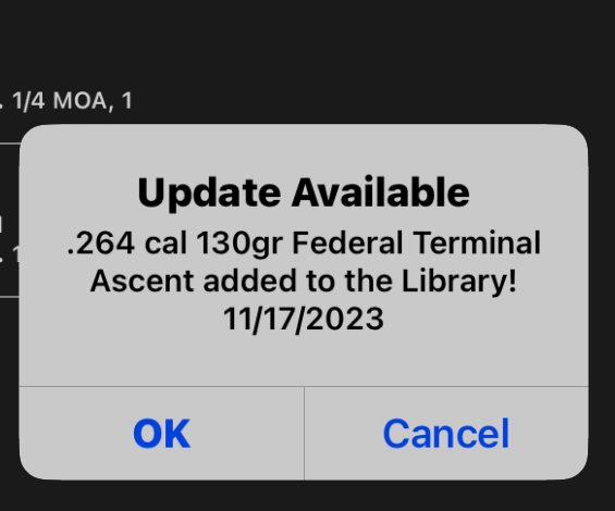

I've been running the Garmin on every session, 2-3x/week since late October. Today is the first time I ever had it miss recording a shot. Why? Because somewhere between the 2nd and 3rd shot on the string, it decided to pause the session and ask if I wanted to update the software and I didn't catch the prompt because I was on the rifle. To me, it is stupid to interrupt an active session to ask if you want to update. If you are concentrating on your shooting, you aren't going to catch it. I appreciate the opportunity to update, but I think if you are in an active session, that is not the time to execute an un-commanded pause for an opportunity to update. Perhaps we need ANOTHER update so that it won't stop recording shots in the middle of your session to ask if you want to update? There are plenty of opportunities for it to ask for an update other than when it is in "capture" mode.

I have a question ... when this happened, were you plugged into a computer and running "Garmin Express" ... or was the unit disconnected and standing alone? I tried to simulate what happened, but the only time I could do that was when I was USB'd in to my laptop and running the Garmin software.
Reactions: LastShot300
Could be wrong but I bet he was bluetoothed to his phone.
That was my next question ... the app probably initiated the upgrade request.

Yeah and what I about the freakin AB mobile app constantly asking to update PDM (Personal drag models) or CDMs when you open it.

I lost an entire shot string for the same issue. I hadn't hit the finish button when the update popped up. Once the update finished, the string I was in middle of was gone. Pretty annoying if you're doing work on customer ammo or anything else important.
But, shit happens and it's an amazing piece of gear for $600. We have two and I'll probably just keep them both running and hope they don't ask to update at the same time.
If your pussy actually hurts that bad over this, and you HAVE to have the unit connected to your phone, put your phone in airplane mode. Bunch a fucking bitches who need to be handed a solution instead of just thinking about it. How’s it gona know there’s an update if it can’t talk to the interwebs…or is going off-line when you’re shooting too terrible to contemplate? I hate this thread. I’m disappointed.

The bullet library updates go quickly ... it's the system firmware updates every few months that I start when I go to bed, and check progress in the morning. (OK, it's not "that bad" ... but it's close.)

I complained about the interruption of a session for an update to Garmin and this is how they responded:
"At this time, that is how the device, and all xero devices I believe are set to work by design. If the device is asking a question, it will need a response in order to either proceed with the next step in updating, or deny that update and move on to continue your session. Without it being ready to pick up shots, it is not going to collect data.
At this time, this is how the device is designed to work, and not a device flaw."

I had a similar experience on my first time out with the device yesterday (mind you, I'd already updated the firmware at home several days prior after unboxing).
For me, I actually caught the update request and declined it, only to have it immediately reprompt as soon as I got behind the gun. So I just accepted it. But yeah not only was I annoyed that it essentially broke the primary function of the device, but it was (in my opinion) entirely too insistent that I accept the update.
Seems to me that one way to improve this experience is to keep catching shots in the background, even if the prompt is on the main screen; it should also not ask again about the update until powered off and on again if the user declines. Or hey, just notify the user that the update is ready, but then the user has to go activate it manually. Lots of ways to fix this.
Same thing happened to me. But in my case, I had read this thread and decided to wait a couple minutes after turning on the Xero and also checked the app on my phone to see if the update prompt would appear. It did not and so I started shooting.
After the 2nd shot, the update prompt appeared and the last 3 shots were missed. I had the Xero sitting in a position on the right side of my rifle where I could not see the screen unless I lifted my face off the cheek riser.
I understand Garmin's position on the prompts and that action "may" need to be taken. That said, they need to rank the prompts so that something like a version upgrade would not be triggered during a firing session.
I guess the rule going forward is to check for an update before going to the range. But even that won't catch an update that gets pushed while you are at the range and have the Xero paired to your phone.
