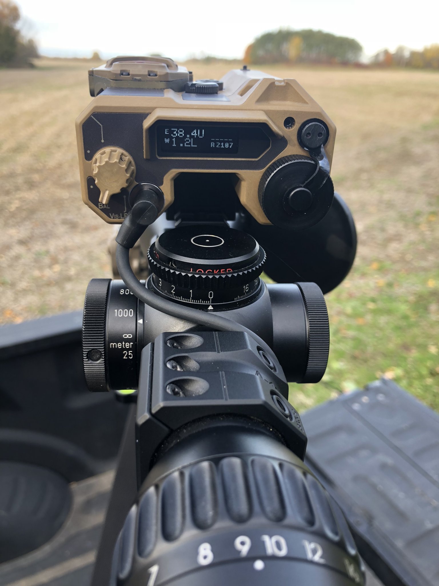

You should be able to find plenty of pics of the RAPTAR out there. Here is the display of the VSO
It shows the distance, the elevation hold, the temp, the wind, the heading, the pitch and roll. Has lots of config screens for setup.

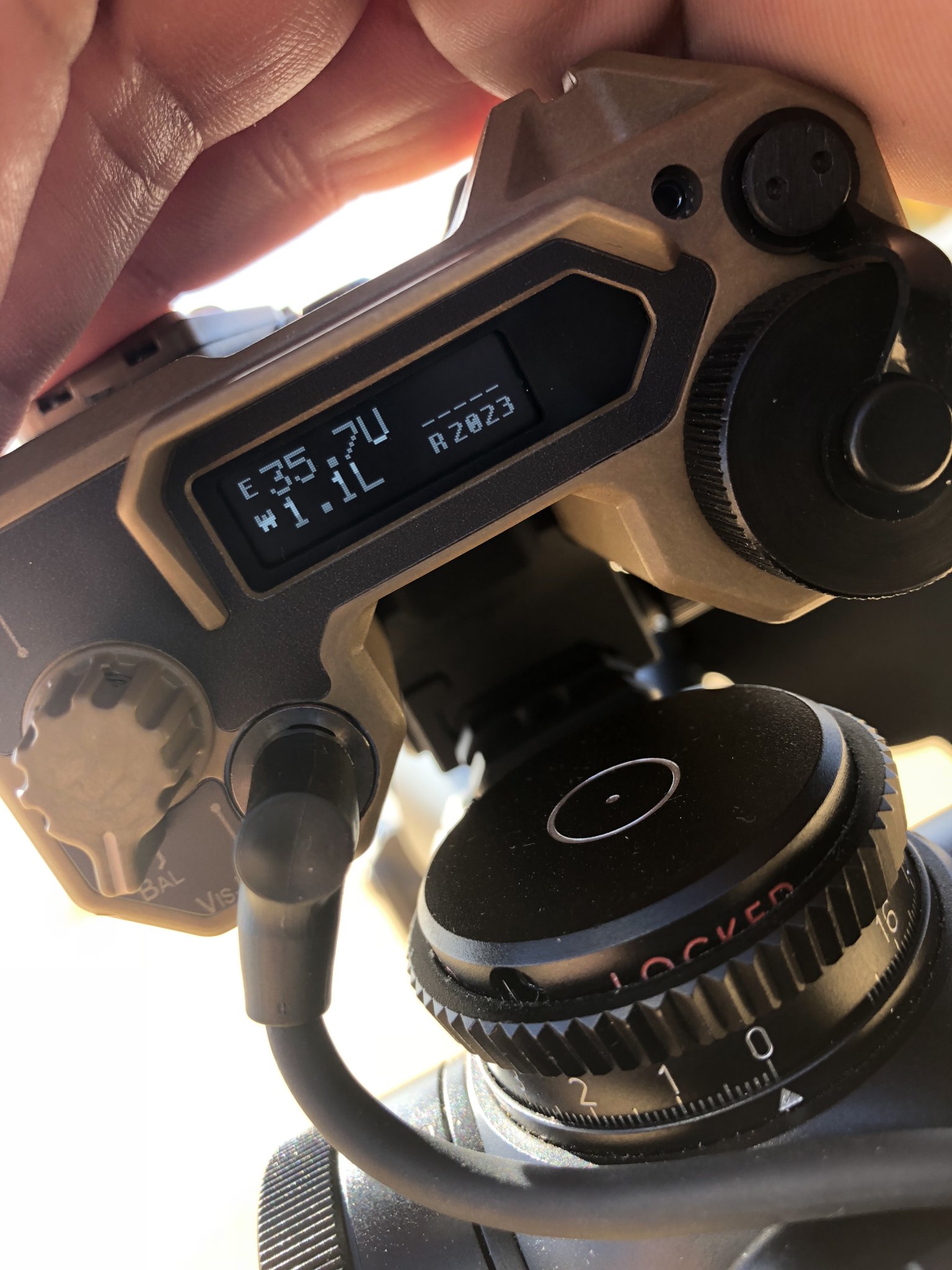

To the OP , the explanation by Wig above is spot on as always! I just wanted to chime in with a good word for the S/ES version. I’ve been running one for the last two weeks and I’m very impressed. I’ve been able to range a cell phone tower at a little over 2000 yards in bright sunshine. I’ve used it at night but didn’t reach past 1000.

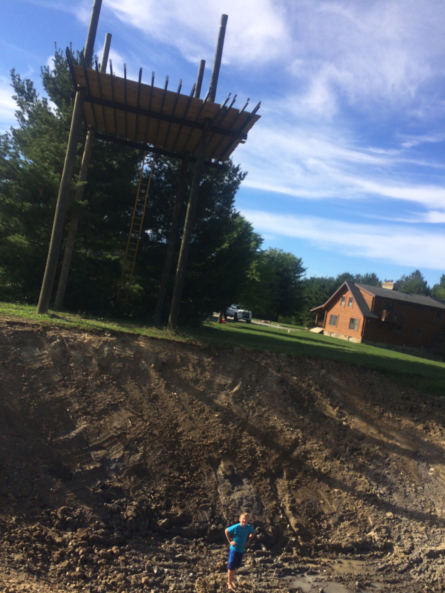

What the heque are you building in your backyard there NightAssassin !! :D

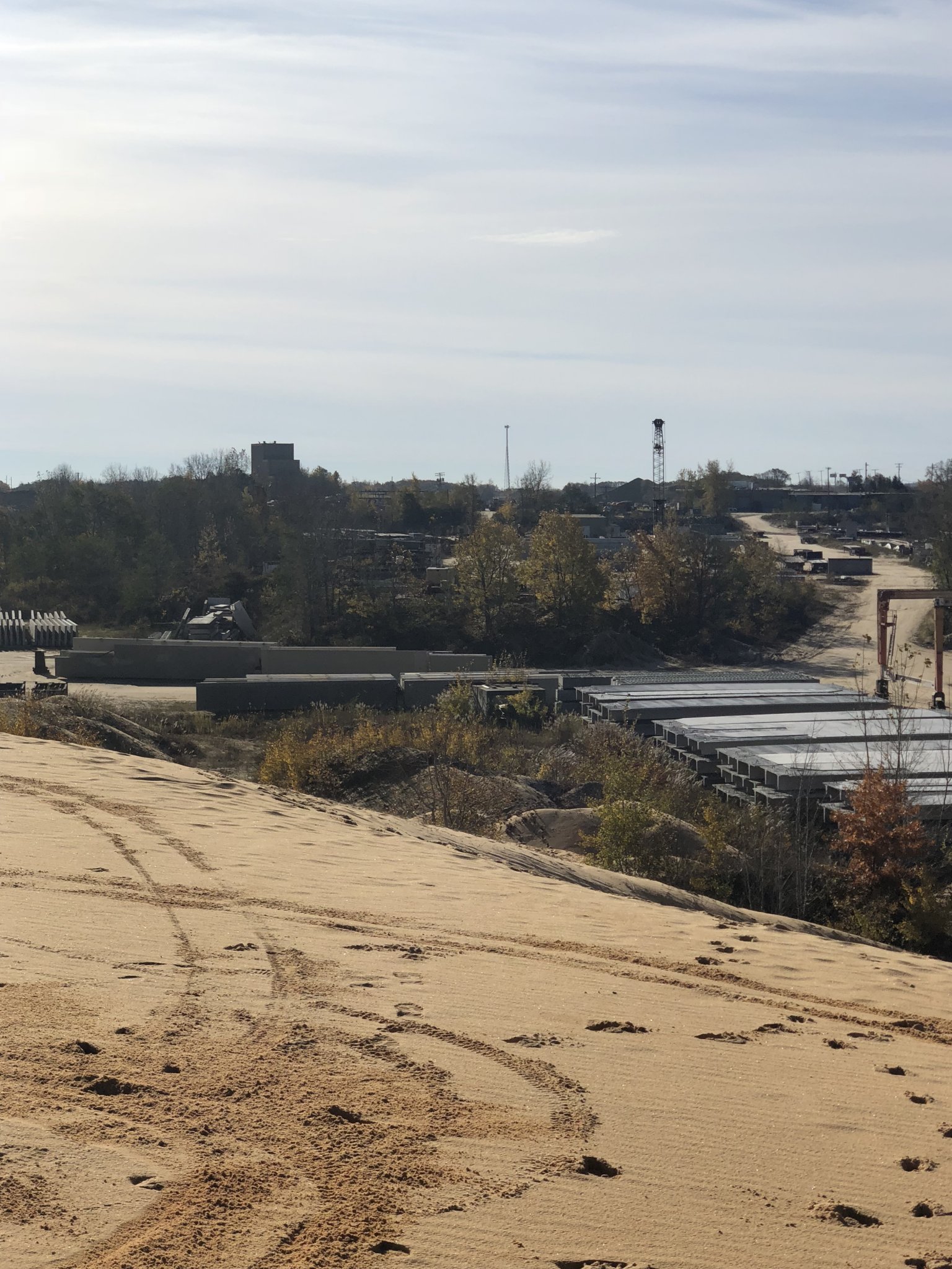

LOL thats a cement manufacturing facility that i have access to, we were up there playing with the RC cars on the sand dunes. I don't leave home with out my rifle so i was scouting and ranging things. they have about 1500 acres of fields, corn , soybeans, wheat, and lots of Coyotes !
