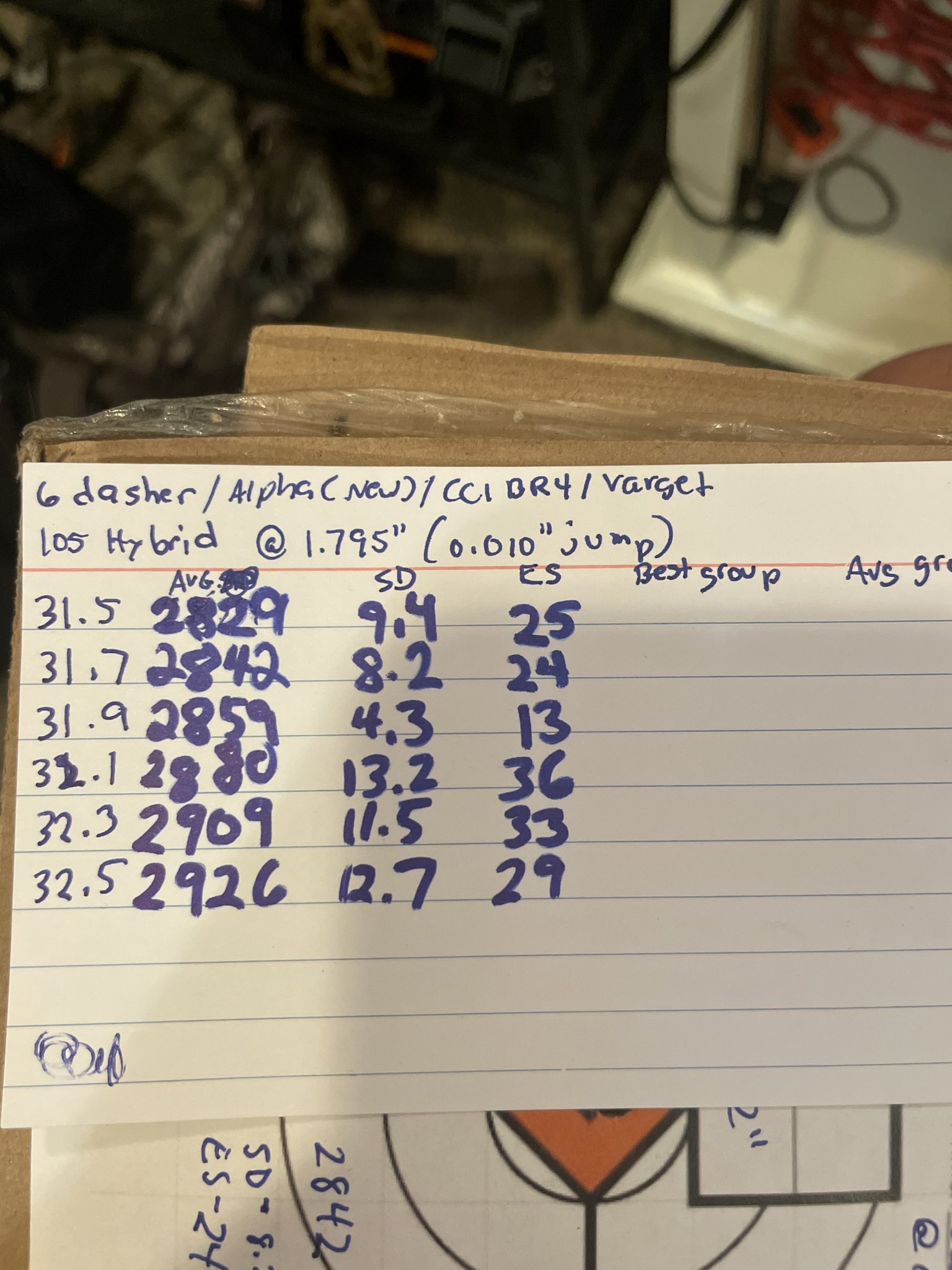

Ok check these numbers out from the mixed lots of varget. Just for context.
*6dasher
*Mullerworks barrel. 10 rounds prior to today
*105 bergers seated at 0.010” off the lands
*new alpha ocd brass-just hit em with my giraud to give a little inside chamfer
*br4 primers
*mixed varget. 31.5-31.7 (.2 increments) using rcbs chargemaster
Sd and Es not great. I know of people with great results on new brass. Groups were decent though with .178” avg group between 2-3 shot groups.
Do you think the high sd es are from mixing the powders. Or just the fact its new barrel and new brass.
It’s doubtful, I’d look at your reloading steps. Did you at least measure your new case necks? Many times they may not be completely perfect coming out of the bag or box. Thus far I’ve always neck sized any new brass.
