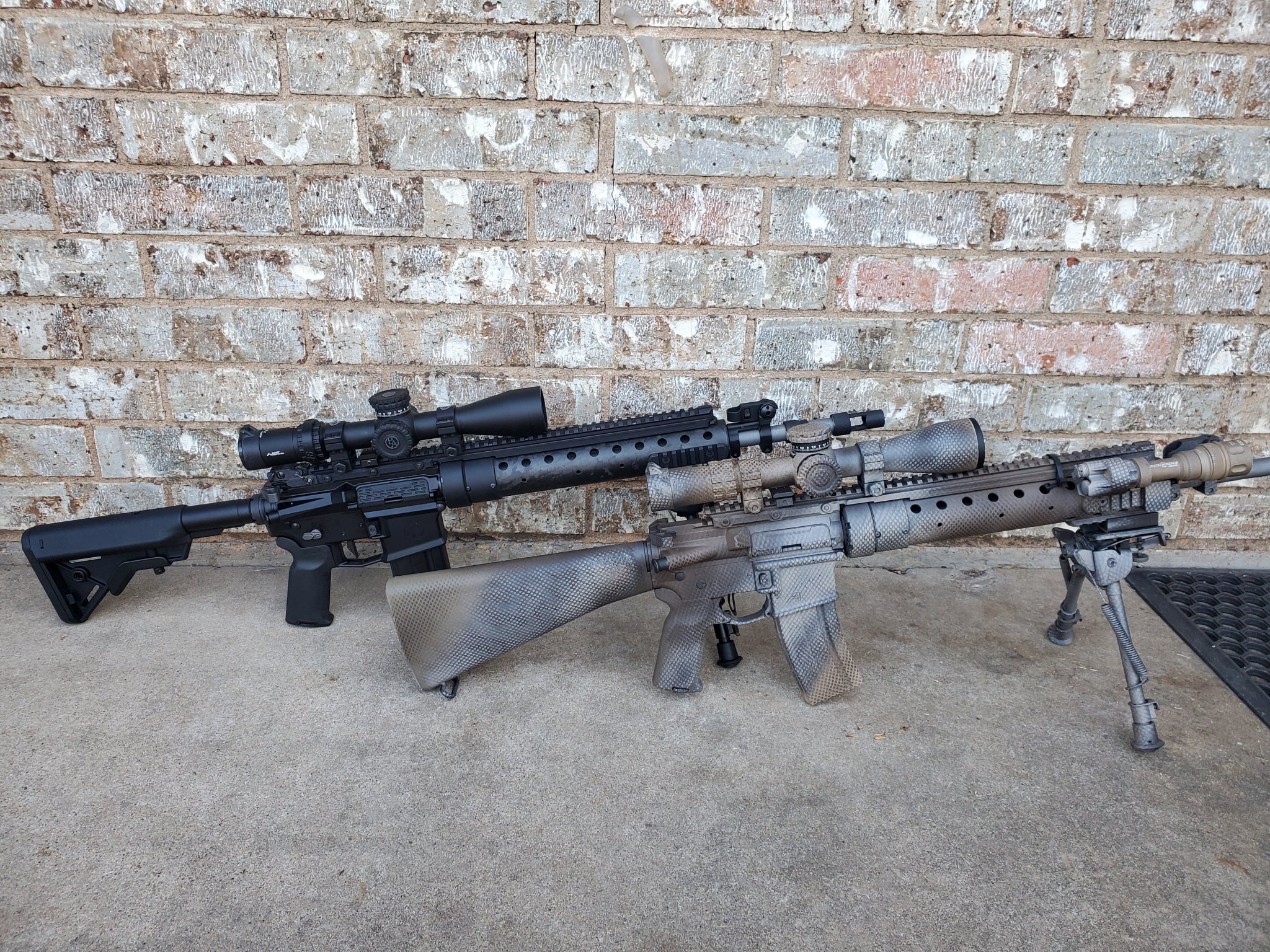

That's the problem I've found with the correct scopes. So this will look fairly close with exception of the optic.
I live in CA, so building a Mk12 meant that it was never going to be truly clone correct, so I decided I might as well build something that was lighter & had more modern components, without compromising on accuracy. I really liked that gun, but I still found myself wanting a Mk12 despite the supposed "technological advancements". This year, I finally got around to building a "Mock 12 Mod 0" exactly the way I wanted - not to get approval from keyboard commandos - but because I always wanted one.
It's definitely NOT clone correct by design - I skipped the SWAN top rail, used a 3-9x40 Leupold VX-R Patrol in a Warne cantilever mount that I already had, and built around a PRI Bergara SPR barrel to save some cash - and I am 100% happy with how it turned out. Sure, it's not clone correct, nor is it the "latest & greatest" but it runs like a champ, and it's close enough to the real deal that I'm absolutely satisfied.
If you want to chamber yours in 6mm ARC, it will be even more potent at long range, so I say go for it. When it comes time to re-barrel mine in a few years, I may go the same route.

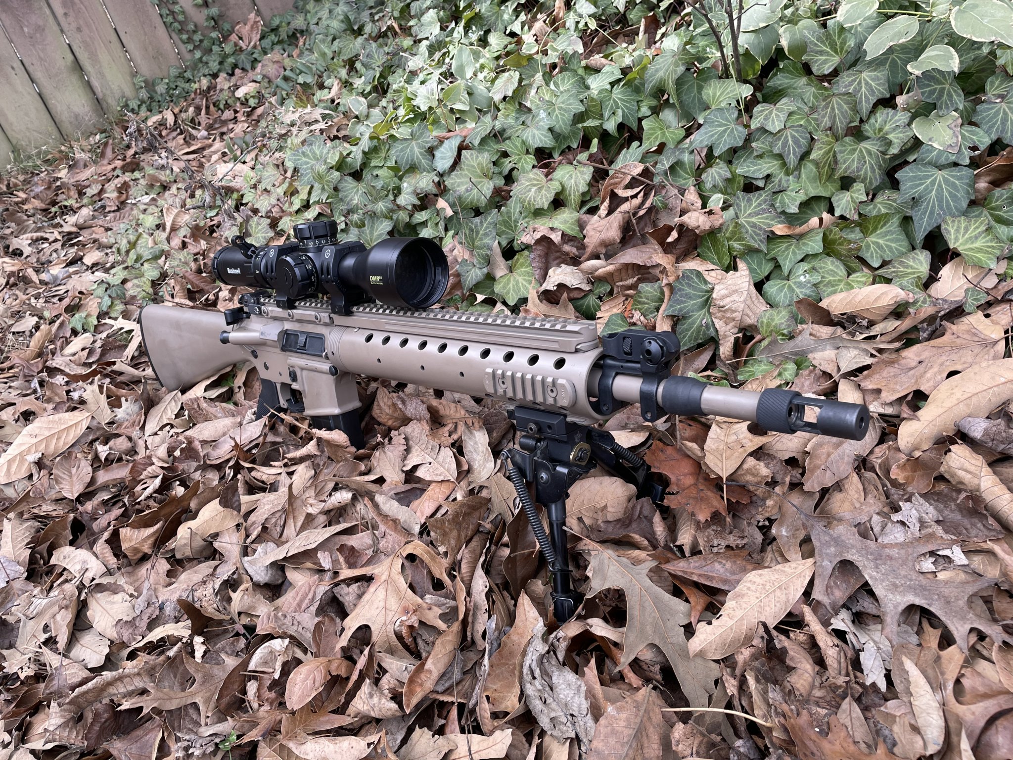

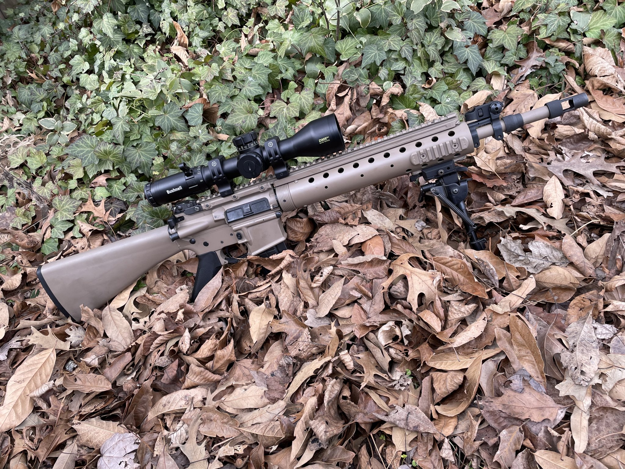

So here is my mark 12 ish 6 arc. PRI was out of the 6.8 AEM brakes. I took a 5.56 brake and re-cut the threads to 5/8-24 and increased the exit hole size to accommodate for the 6 mm bullets. I used a SSA-E trigger, Knights trigger guard and bipod adapter.
I went out and got it roughly sighted in with factory 108 eld’s. Functioned flawless with PrI 6.8 mags and ASC 6.5 mags..

Looks fantastic and more potential = 👍👍
