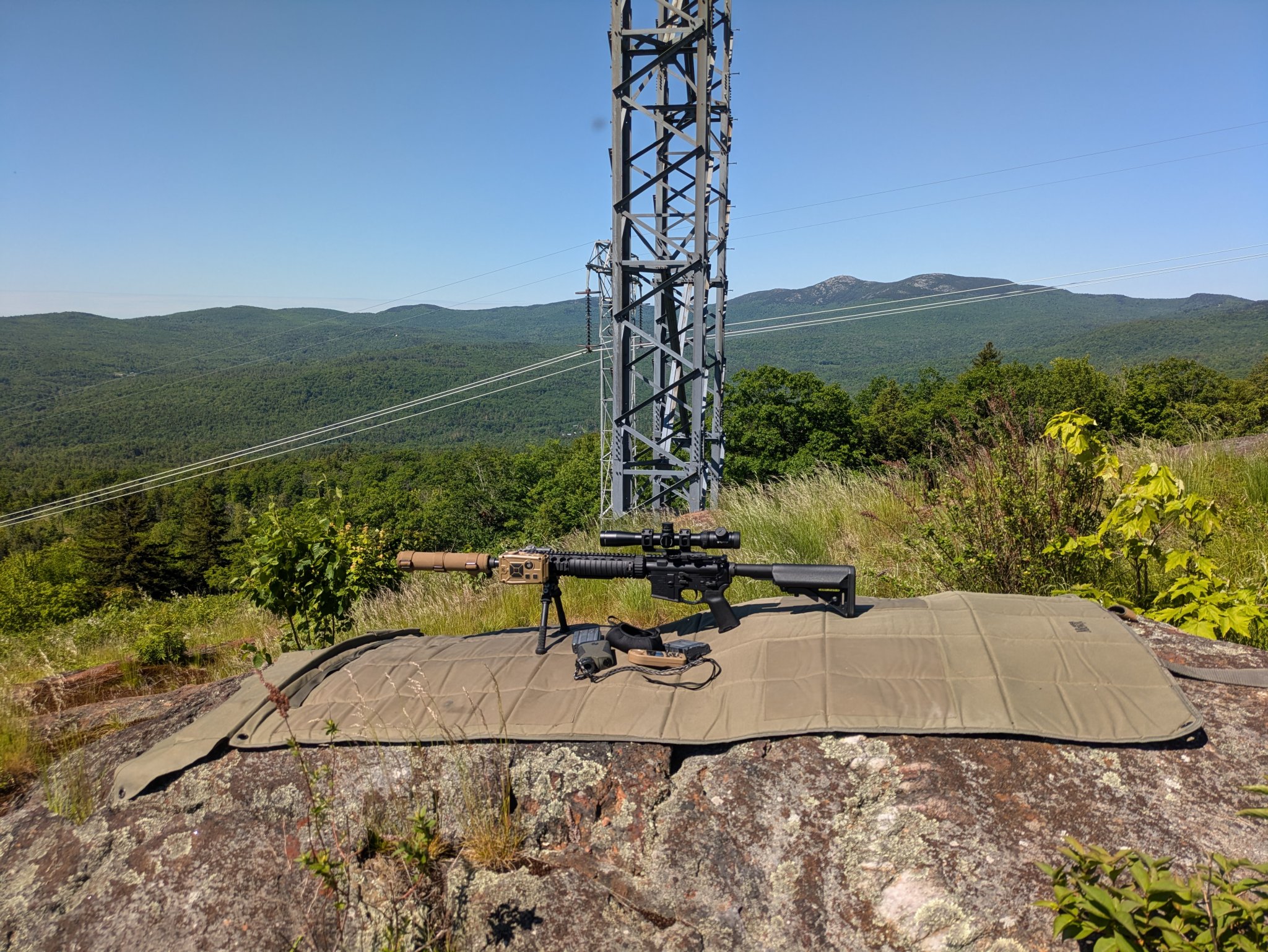

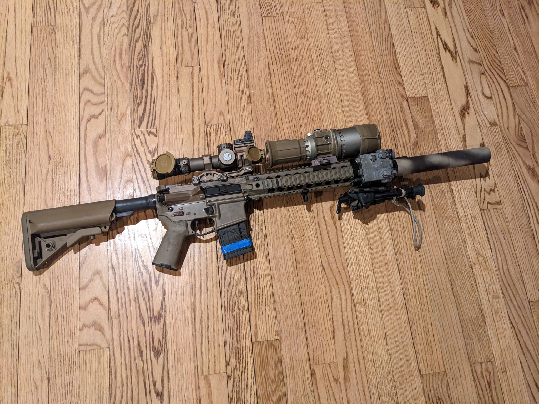

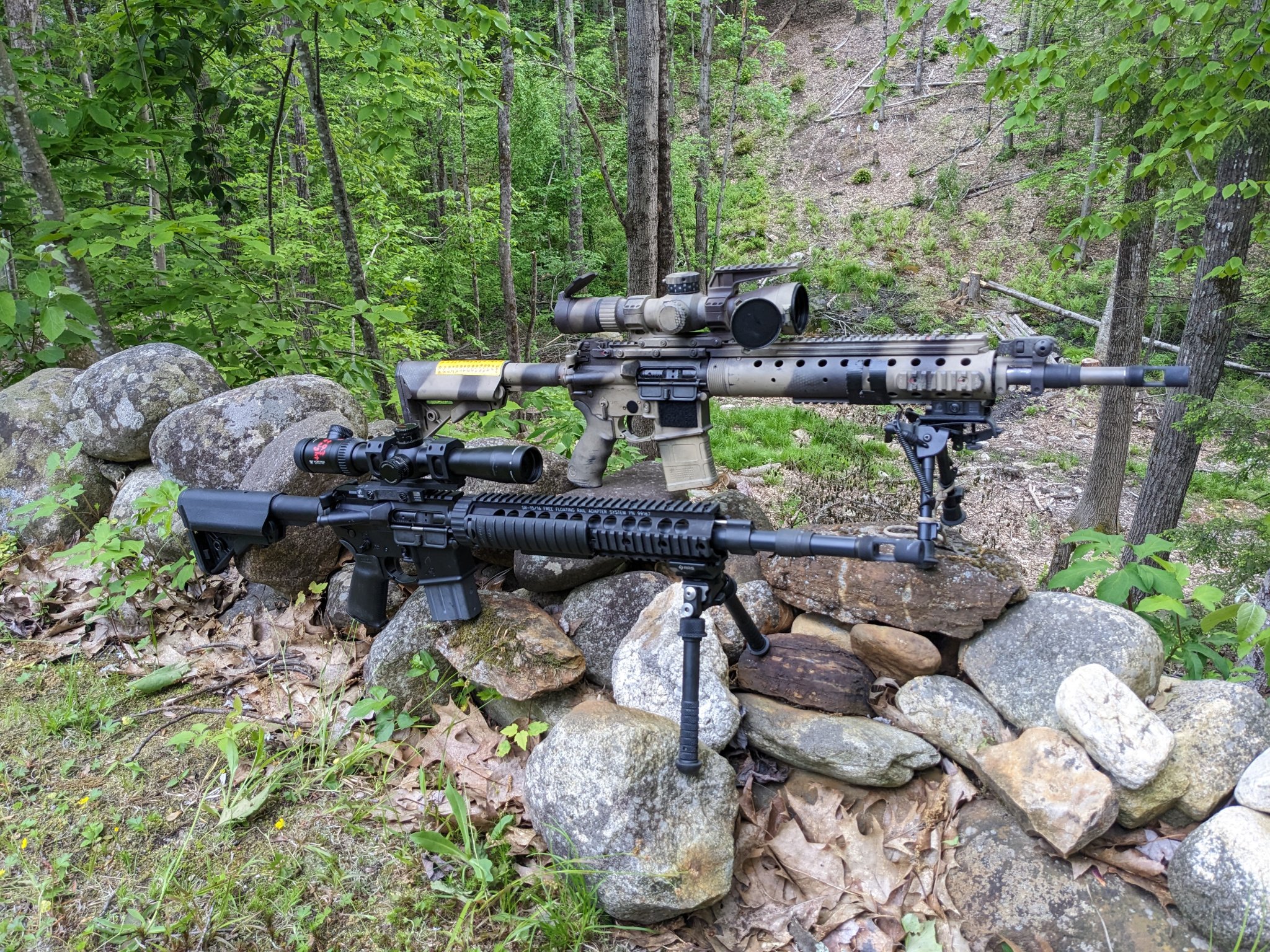

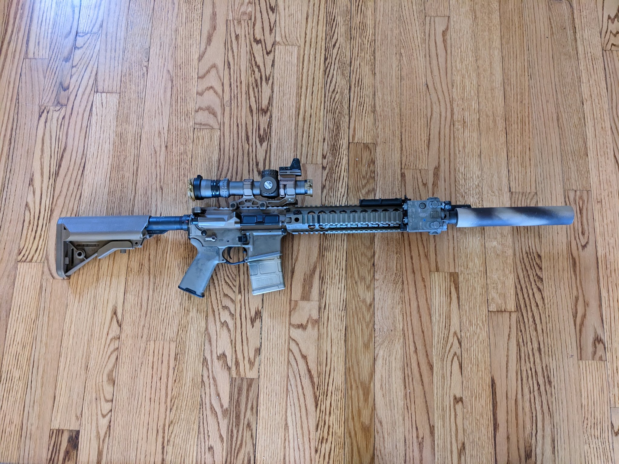

I have a Mk12 Mod0 and Mk12 Mod1. I am about to toss a Mk5 on the Mod 1 to match the Mod0. It is much lighter than the Mod0. The Mod0 does have a Bartlein 1:7 18" from CLE.
I kind of agree with @LRRPF52 that the NSW Recce is a super unique build. Without realizing, I had actually built a similar rifle using a BCM QRF12 and a Douglas 16" 1:7 from PRI as one of my primary rifles. It's stupid quiet and accurate. A RAS FF Long and a 15.1" barrel would be sweet although I think a 1-8 or 1-10 FFP is a better optic choice than the NSW in the picture above. Personal preference.

Mk.12s are great to shoot from the prone, bench, or off a tripod. Once you go to shoot kneeling, seated, or other alternate positions, they don’t balance well even when slung-up. Seated isn’t too bad if you have a larger torso and a lot of experience shooting that way, but the others are a pain.
This is just one reason why I like the shorter guns suppressed. That 15.1” SEAL Recce Carbine with the KAC FF RAS is about as long as I would want to go once you start shooting positions, and it still isn’t bad to run in the house. Still easy to clear rooms and maneuver with, unlike the Mk.12 (beside the Mod-H).
No appreciable difference in ballistics either. I wouldn’t even do one in 5.56 after shooting 5.56 on steel for the past 30+ years, with another 7 years prior to that shooting water jugs and paper or E-types. Great for 200-300, weak at 400 to where you can barely hear impacts on a crosswind day (which is almost every day for me). If you’re out East of the Mississippi with lots of tree baffling, you should be able to hear your hits better at 400yds, but they will get anemic at 500yds/barely audible even with a small wind. Maybe it’s just my ears.

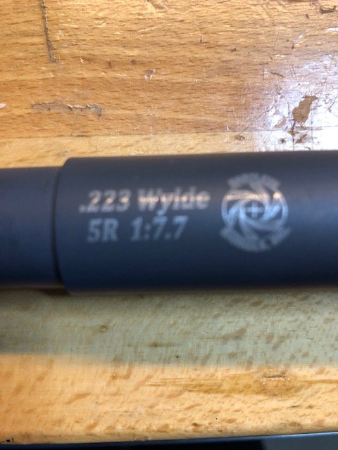

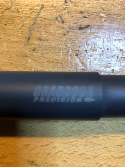

We also have some Bergara barrels made for lighter loads, as the twist is 1:9, but a reasonable option, and a small savings.
Keep in mind the mission defines the barrel and the barrel defines the rifle. If you are working backwards and saying you want an accurate rifle that is Mk12 like, then you want an accurate and dependable barrel that is profiled for all the AEM equipment. Now, Centurion will accept the AEM hardware, just not the suppressor. That may have changed. I know Alex at Trajectory is trying to get some of the third party barrel profile companies to change their profile.
