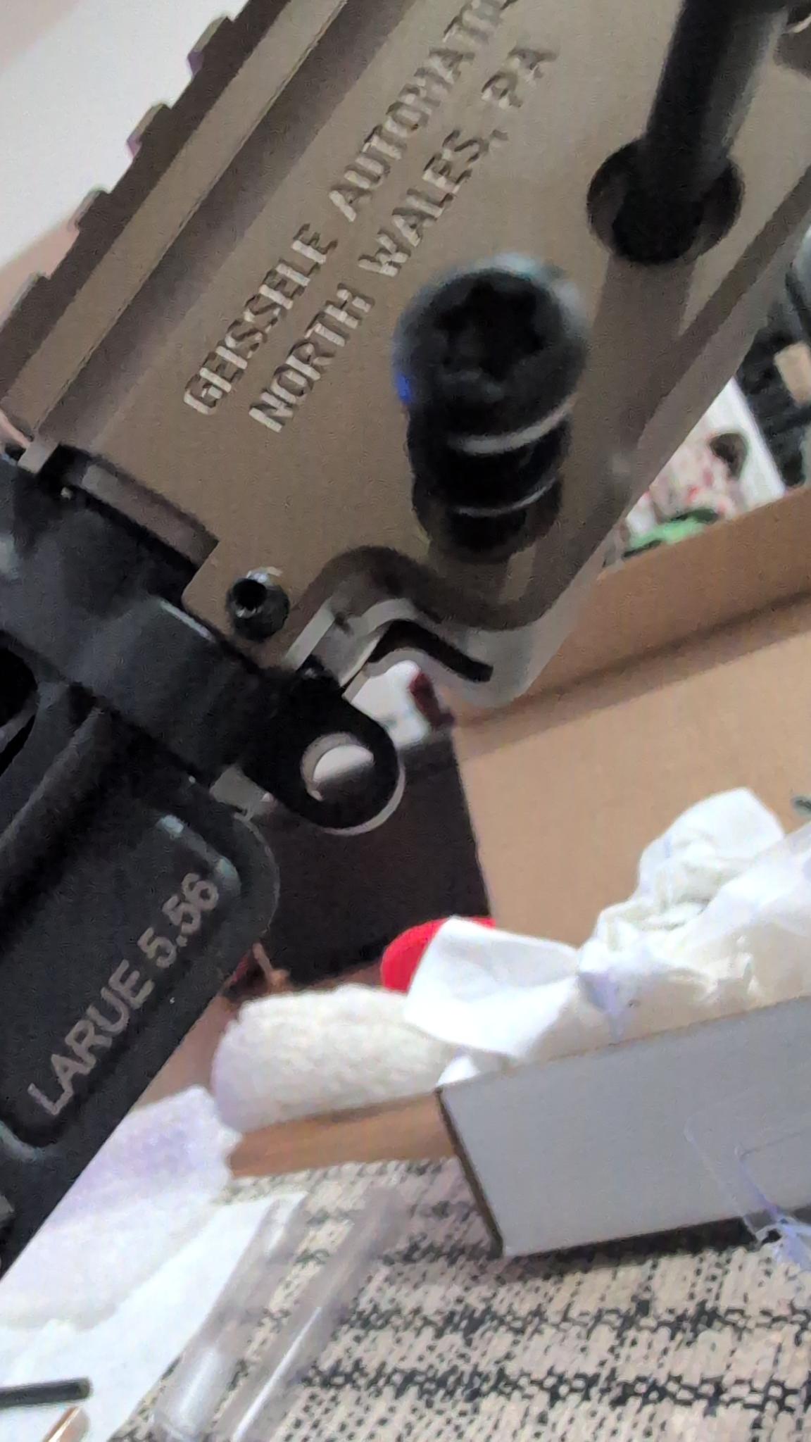

however, the MK16 (or any of the geissel rails with the 4 anti rotation tabs) does NOT fit with a larue stealth upper receiver. Even though both claim to be "mil-spec"
I was super pissed. Then I realized I could use that rail on another project and ordered a forward controls rail and that should fit.
Maybe I should clarify my earlier post. The .750" SA set screw GB will fit under the mk14 and mk16 but the handguards may not work on all uppers. I have run into both rails not fitting "thick" uppers to include a CMT I just installed a mk16 on last week. A small amount of measurements and application of a fine file and it fits fine. Some may not want to use a file on a $$$ handguard but me and aluminum black liquid have a long history.
Looking at the Larue above, yeah that won't fit. I bet it did piss you off.
