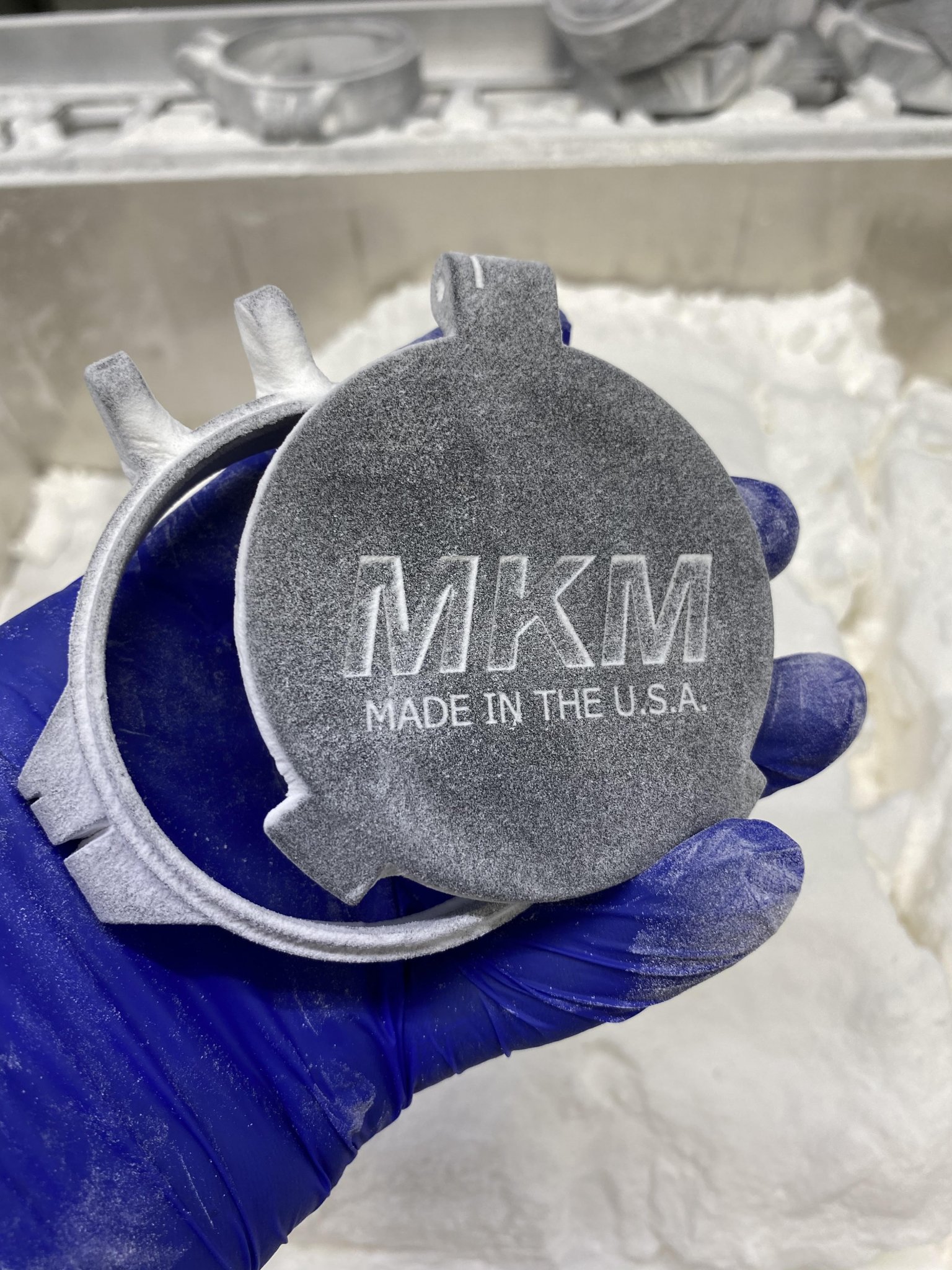

I have a few of MKMs early printed throw levers. On one scope, the lever was loose, so I emailed Tyler to tell him. First, he responded to let me know that I could try heat curing the lever to make it shrink some so that it was a better fit. I did that and it worked. Second, without me asking, he sent me a new lever free.
As far as the heat curing process, it was a year or so ago so I don’t remember exactly, but I believe it was 200 or 250 degrees. I put it on a tray in the toaster oven for an hour or so at that temp. The ring shrank in diameter just right, allowing for a nice tight fit. No issues since.

Im curious on the scope caps. Was just about to order a set of aadlands for my hunting rig. 3-12 LRHS.
I will need 3 sets of caps.
May as well get some throw levers too....
Will be watching for updates
I have a set of AAD caps for an AMG I'd sell. Frankly I don't like them. I think I bought every scope cap on the market for the AMG and in the end just lock wired the OEM Vortex caps on so they can't move.

@Tyler Kemp
Where dem scope caps at😊
Got an Athlon Helos 8-34x56 on the way.
Gonna need some caps 🧢
why didn't you get it from me?!
they are awaiting spring testers that should arrive this week
