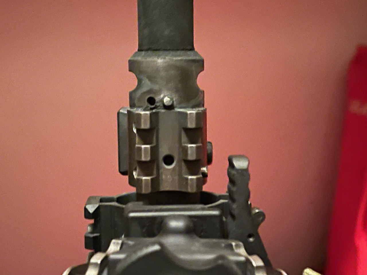

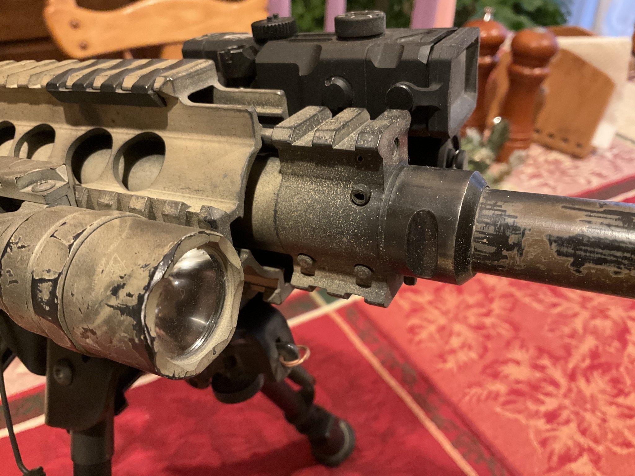

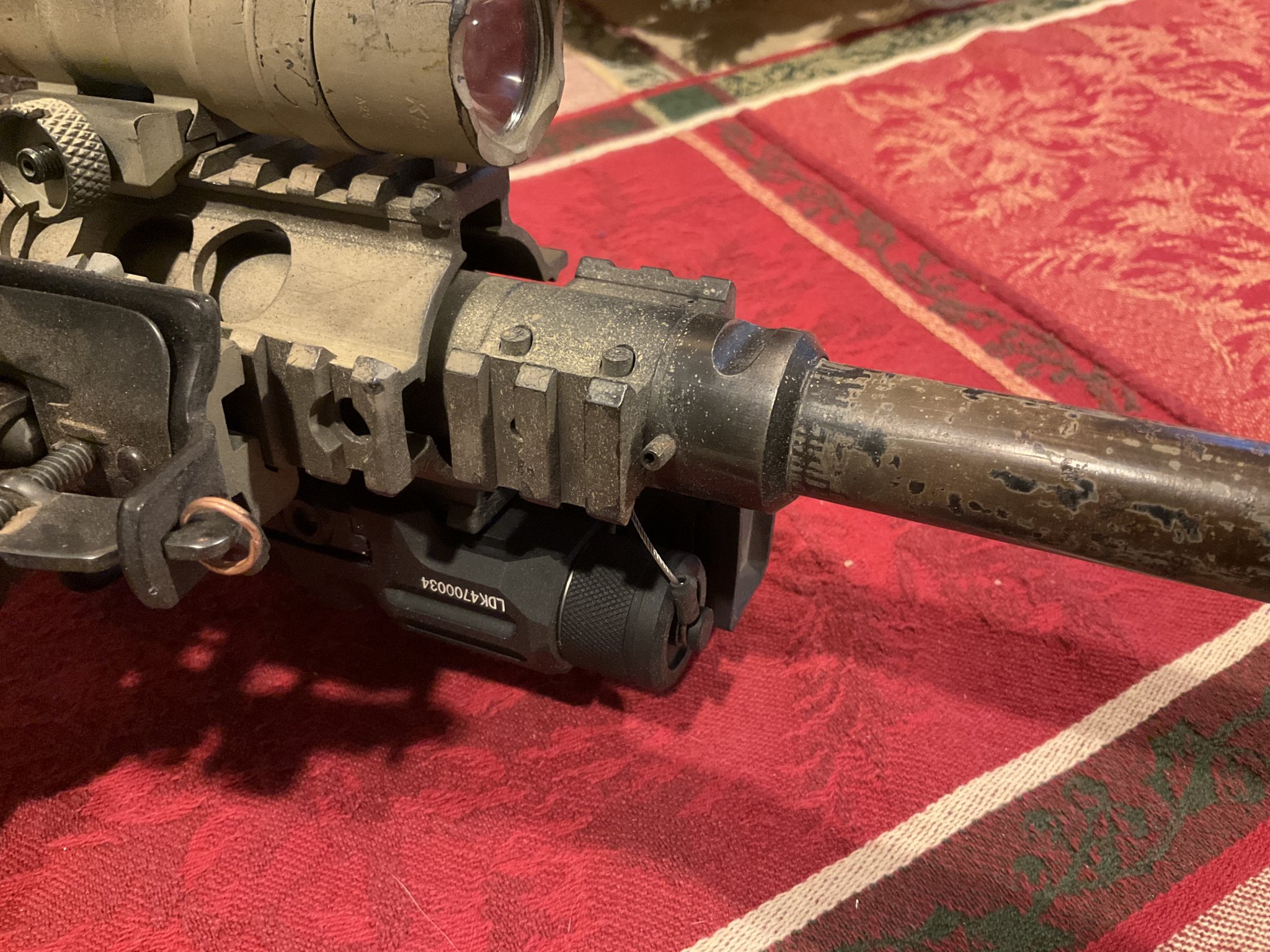

Here’s the underside of my Mk11’s gas block. Im almost positive the same block (at least footprint wise) is used on the M110. There are two pin placement locations; the M110 would need that pin in the 7oclock position but otherwise its the same block.
The blocks have cosmetic differences between the two. The m110 block has the center of the lower rail cut out like your photo above, along with the two horizontal scallops cut out between the gas tube and barrel on each side. A mk11 block is all solid and filled in in these areas. Only other variation is the mk11 mod 1, which used the mk11 block but with the 7 o’clock pin for the m110 suppressor...
