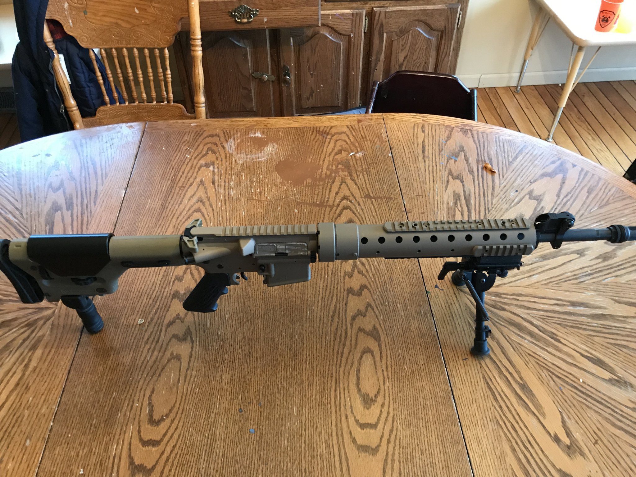

Hey fellas... I’m in the process of building a MK12 mod 0 and I want to order the full top rail with flip up rear sight. I looked on PRI website and it looks like they have a few different options and just want to make sure I order the right set. If anyone can point me in the right direction on which to order or if you have one to sell it would be greatly appreciated

Build specs
Aero precision upper/lower
PRI gen 3 handguard the round one (non delta)
Daniel defense 18 inch barrel
PRI front flip up sight/gas block
Magpul PRS gen 2 stock
Is your forearm GenII or GenIII? That'll determine which top rail you'll need to go with. The rails with the PEQ cut up front are spec. They make them in standard picatinny cut up front too if you dont own or use a PEQ but want to use the front rail space.
So it depends on if you want to run a PEQ or not. Or if you just want it to be a spec clone.
ETA: OK, I see you have a GenIII HG. So assuming you wanna stay with the FDE color scheme:
Heres the spec PEQ rail in FDE: https://www.precisionreflex.com/Detail.aspx?PROD=1293627&CAT=4814
Heres the standard full picatinny:
Hope this helps out...

PRI sells a nice flip up rear but it won't be the correct sight. Honestly, unless your building a 100% clone it doesn't really matter.
There are several mk12 threads on the board. You may check them out for ideas. Sourcing the original Swan sleeve is all but impossible, as is the orginal rear BUIS. PRI makes a new old stock original mk12 mod0 front with the revelation adjustment now. Yours is the one I run and it's a great gas block.
Barrel profile can be cut for the collar and the brake, or its possible Ron could make a collar that would work with your current profile. It doesn't appear to be mk12 profile, though I may just be missing it in your pics.

Not really going for 100% clone as you can tell in the pics. Just trying to get the look without spending the serious cash on a real one. Thanks for all the good info I think a 3.5-10x40 would probably fit my needs as I probably won’t end up taking it out 500 yards or so. After I recoup some funds after putting this together I’ll be on the lookout for one in the optics px. Thanks again!

Magpul PRS gen 2 stockView attachment 7056990
Nice build but why didnt you just go with the AERO SPR ops inc profiled barrel? so you get the look and they are decent barrel that dont break the bank
