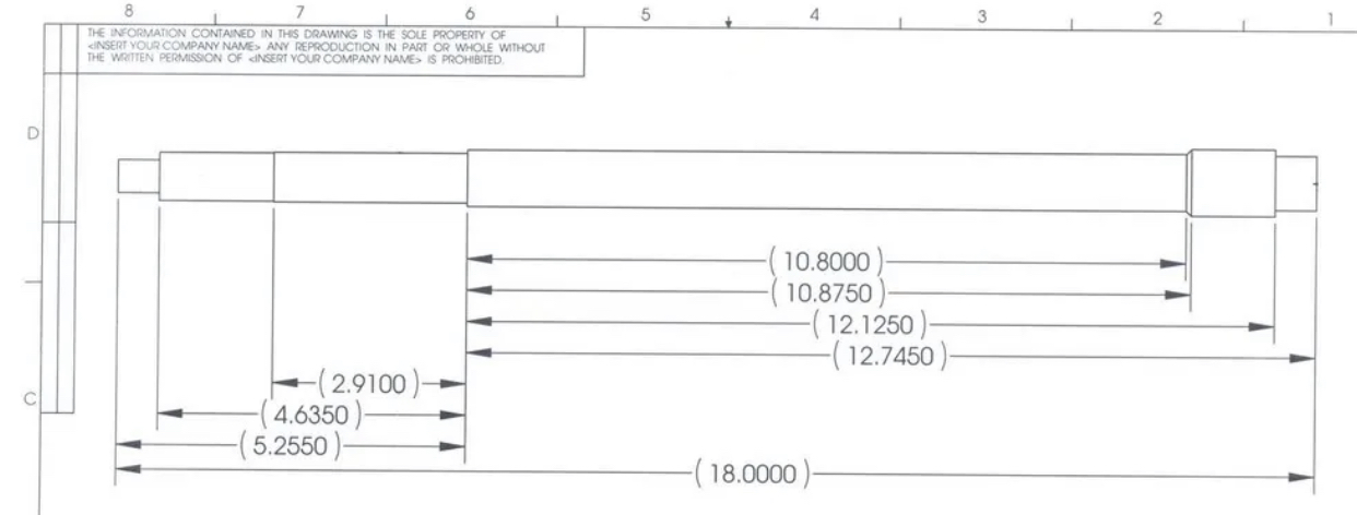

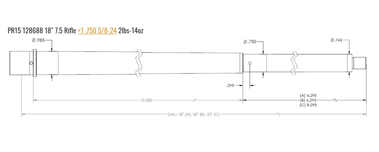

I am planning a build a mk12 mod 0 clone but in 6 mm ARC. I Already have a proof barrel, however it’s rifle length +1. So my question is, do you think it’d be possible to use this barrel for a mod 0 clone? I know everythinf is pretty tight on the mod 0 so it may not work. However Id hate to not use this barrel since it was free. Below is the barrel I have which I have as well as mk12 specs
Problems: The standard PRI MK 12 Mod 0 forend will be too short for the +1" gas system. The PRI flip up front sight won't work with the short Proof gas block journal. There's no shoulder on the Proof barrel for the Ops-Inc barrel collar. I don't know if you can get an Ops-Inc style muzzle device threaded 5/8-24 for the Proof barrel or not.

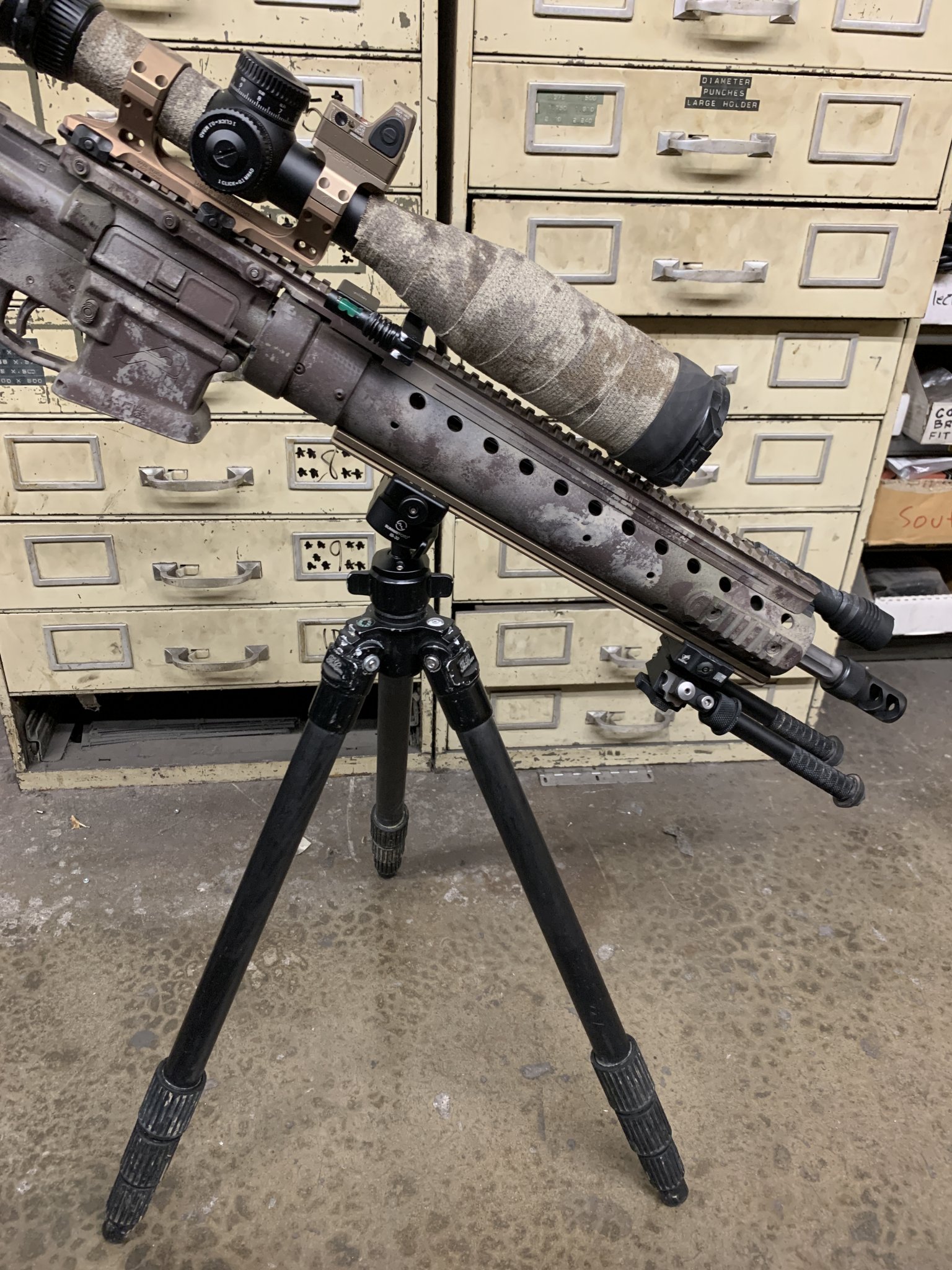

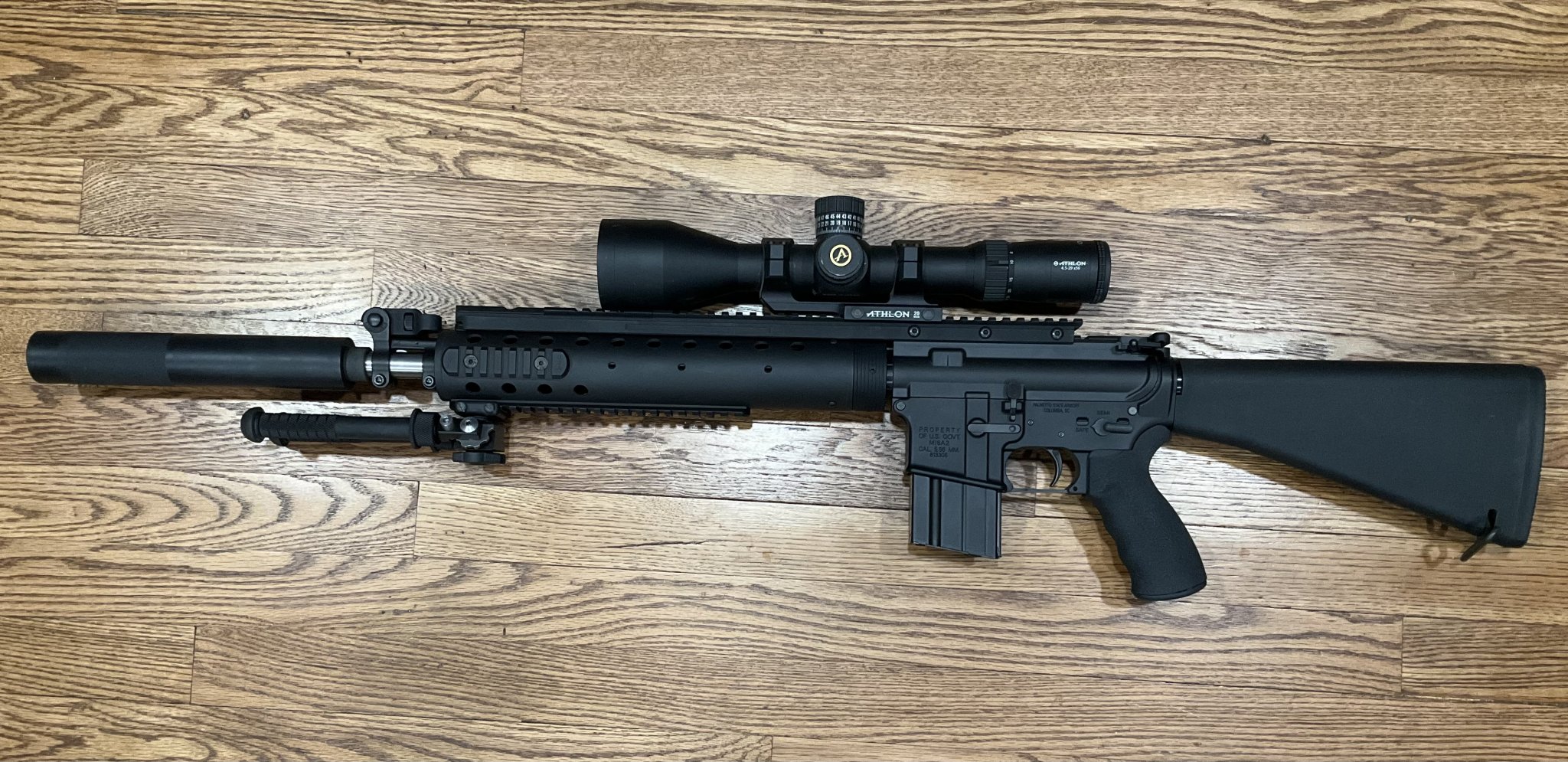

I like the idea of a 6 ARC on a Mk 12, for sure. As a builder of Mk12 riles, I would personally see that as a possibility, but given the other projects on our plate, maybe a 2024 offering. But the barrel needs to be profiled correctly. As @MSTN mentions, you have gas journal issues, gas tube length, lack of a shoulder for the collar. Perhaps gas port size if running suppressed....
If I were you, I would put that barrel to good use and get a good receiver set host and MLOK rails. The potential of 6 ARC is there, but not everything can be 6 ARC overnight. There are some other practical issues that are causing some builders to look at dedicated 6 ACR receivers and BCGs. I am no expert on 6 ARC, just learning, but it is not as simple as a move from .308 to 6.5 CM.
