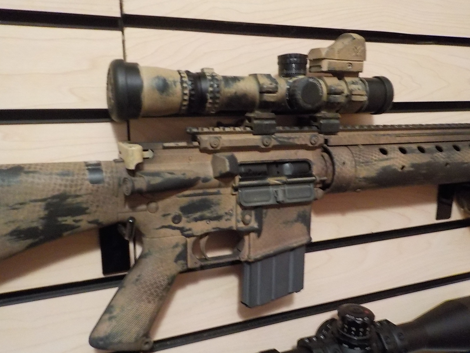

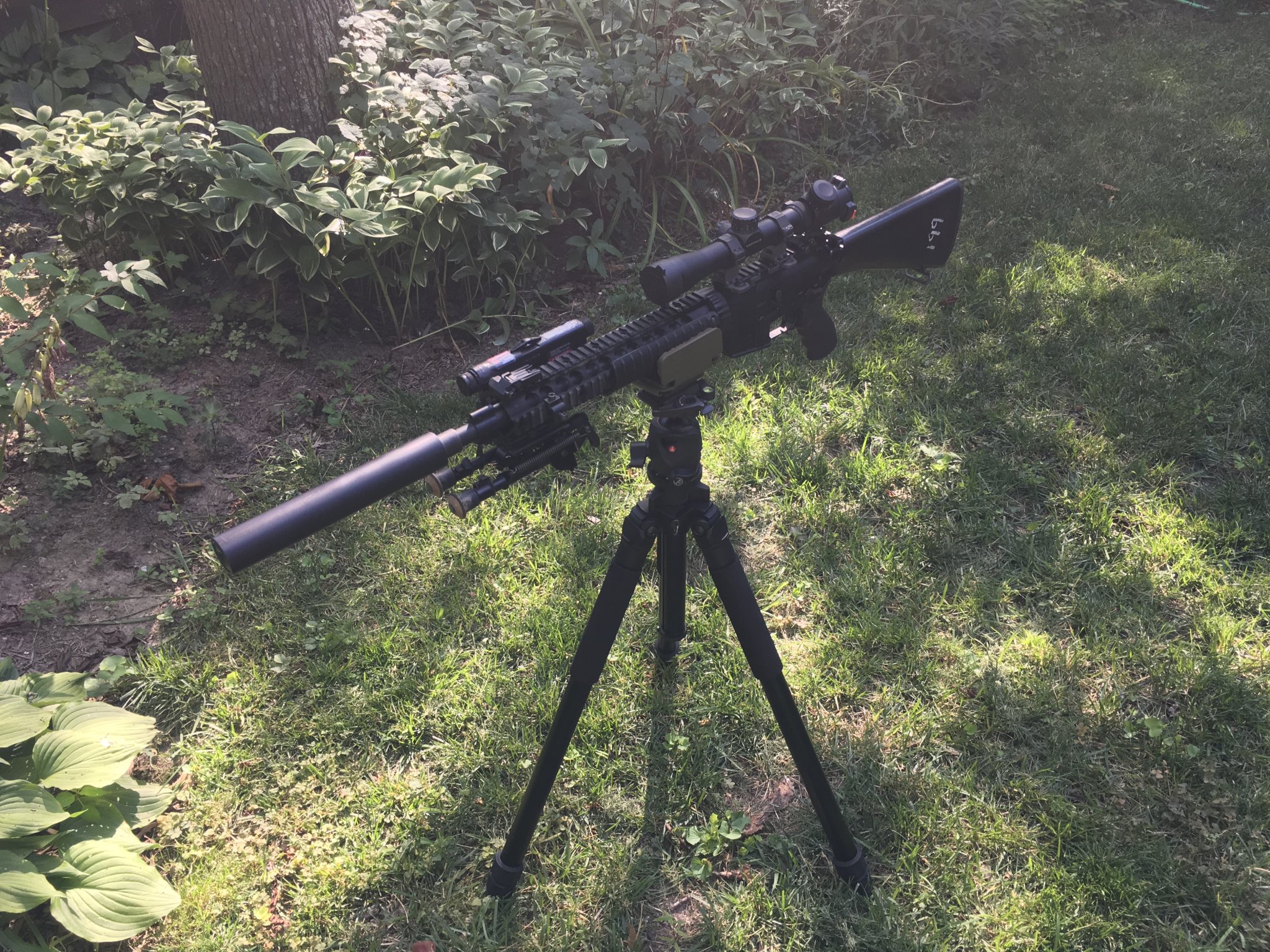

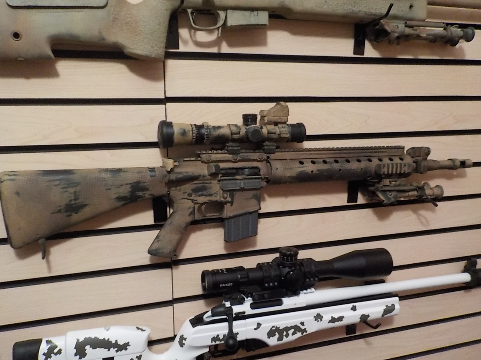

    I really like Cerakote, but recently I have been building a bunch of rifle clones as used by USSOCOM. Researching these guns, almost all had a spray paint finish and all had battle wear. I really like the look of a rifle that has been used hard and has a story to tell. Consequently, I've been giving a lot of my USSOCOM clones a battle worn spray can finish. Here is a very accurate Mk12 Mod 1 Special Purpose Rifle clone. I'm still waiting on my Allen Engineering suppressor.
    Colt m16a1 lower
    Colt upper
    Brownell's Mk12 SPR 5r rifled barrel
    dscn2027-jpg.7021577
    dscn2028-jpg.7021578
    Allen Engineering brake and collar for Allen Engineering suppressor
    Gas Buster charging handle
    M16a1 original surplus stock
    Precision Reflex carbon fiber handguard
    Precision Reflex gas block w/ front sight
    Swans #40 buis (not shown)
    Colt bolt
    Harris Bipod
    m16a1 grip
    Nightforce 2.5-10x scope w/ swans rings
    Vortex red dot
    And, unlike Cerakote, spraying the gun with paint thinner will return it to it's pre-painting finish. Made it a lot easier on making the decision to paint a brand new NF 2.5-10 scope, which is now a collector's item.
