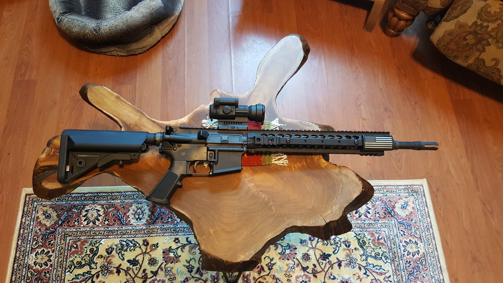

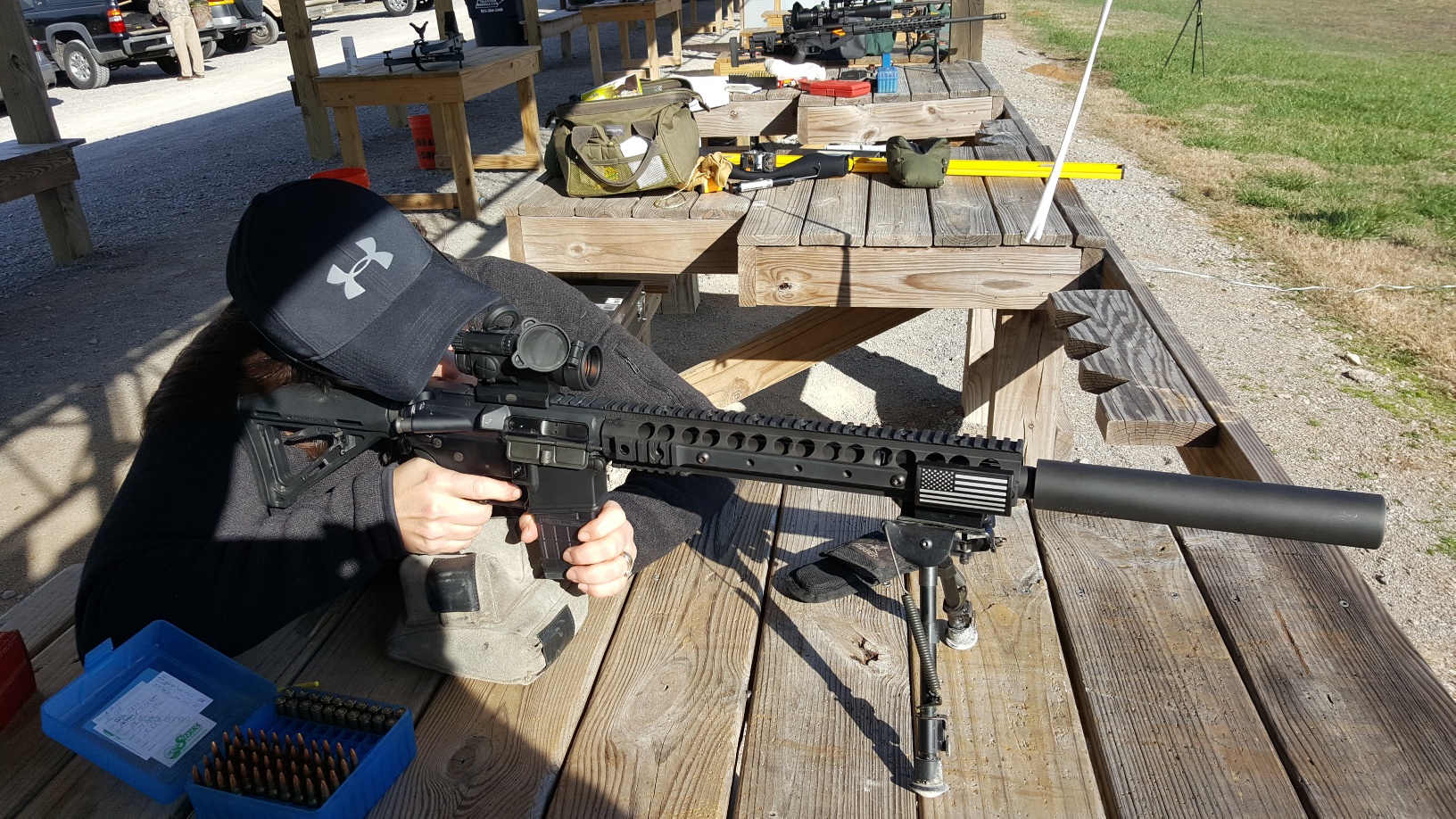

    We made my wife's. (RECCE, not ModH) Started with a 25" 1:7 Green Mountain Stainless blank. ( before you poopoo them, they make a shit load of blanks for other sellers to finish).
    Profiled to accept my AEM5 at 16". OPS collar and used a Smith Entreprise brake as she shoots with without the can mostly. We also took some of the meat off under the handguard to lighten it up. Use a KAC URX3.1 handguard and it came together nicely.
    Lessons learned. The Smith tri-brake for the AEM5 is a touch longer than the AEM brake. I had to cur about. 020" our the "fingers" were contacting the blast chamber and allowed the can to loosen.
    Za German mentioned more turns to tighten the can. Ron actually changed the profile slightly over the one hanging one Gene's wall ( the original, for the first five test barrels) I am paraphrasing, but he preferred at least 8 full thread engagements over the 2-4 you get with the orginal print. We have moved the shoulder slightly on all of mine so I have 8-9 turns.

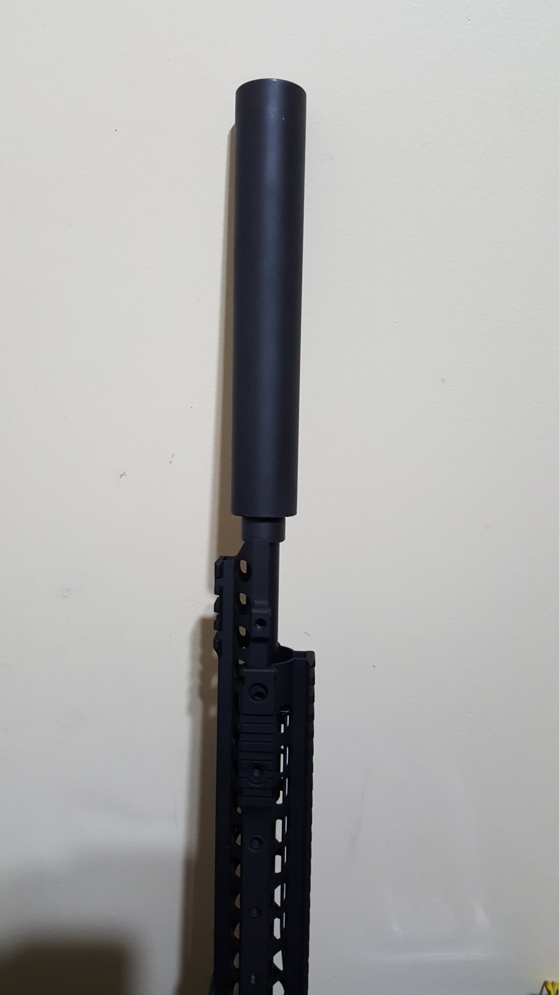

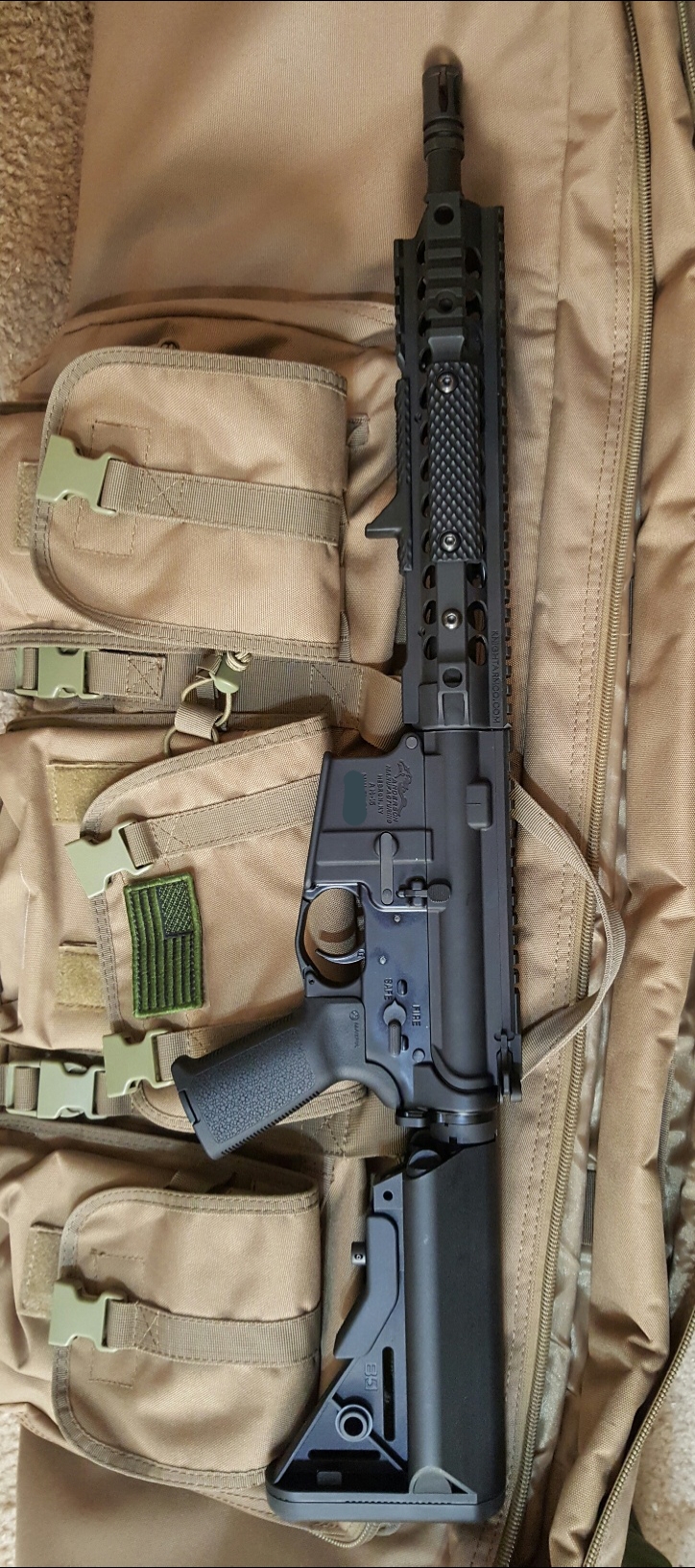

    Here it is. I'm not a big KAC fan but these URX3.1s are light. I have a 12.5" with a 10" URX3.1 as well and it's nice in the hand with the panels.
    Here is a pic with the lower panel pulled back so you can see where the handguard meets the AE collar.
    Here is the 12.5". Just because I love it...

    so the handguard doesnt get in the way of the can right? looks like a sweet set up
    No, fits perfect. It's far enough off the handguard that if you're shooting fast it doesn't get very hot. Basically, just the barrel heat. This is gonna be the tits with a 2.5-10x32 or a 1-8.
