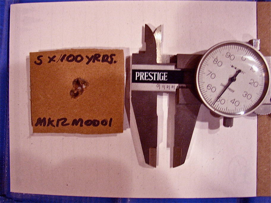

18" BCM Barrel twisted 1-8" (5.56mm USMC SAM-R Chamber) with Nosler 77 gr CC over, 24.5 grains RL15, CCI 450 Primer, in a Speer case, and is good for 2701 FPS and .76" @ 100 yds for an average of five- 5 shot groups.
For IMR 4895 23.0 grs. is max for a .223 Chamber, with a 5.56 Wylde chamber you could work up a bit more....

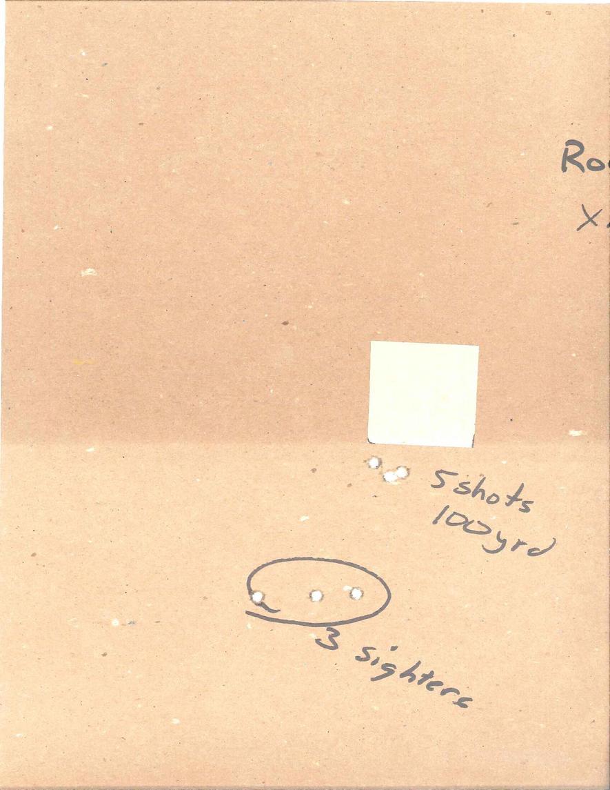

this is a target shot with a woa mrk 12 barrel , 77 grain sierra, 23.4 cfe
3 lower shots are sighters
next 5 went into the group

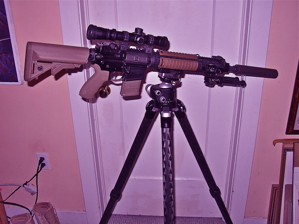

HCS Douglas 1:7 stainless barrel. Factory Black Hills Mk262. Must be your loft.
