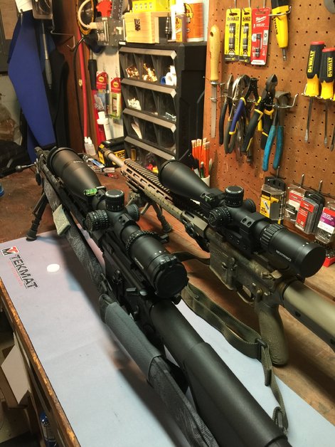

    Two matching 20" "SPR" Douglas CLE match chambers. Barrels were bought years apart from each other. Both shoot sub MOA consistently from 70 RDFs to 77 TMKs.
    You might make a call to Frank at Compass Lake Barrels.
    If you would like to further discuss this via PM that's fine. Also I could manage to drop some of my different reloads in the mail for you.
