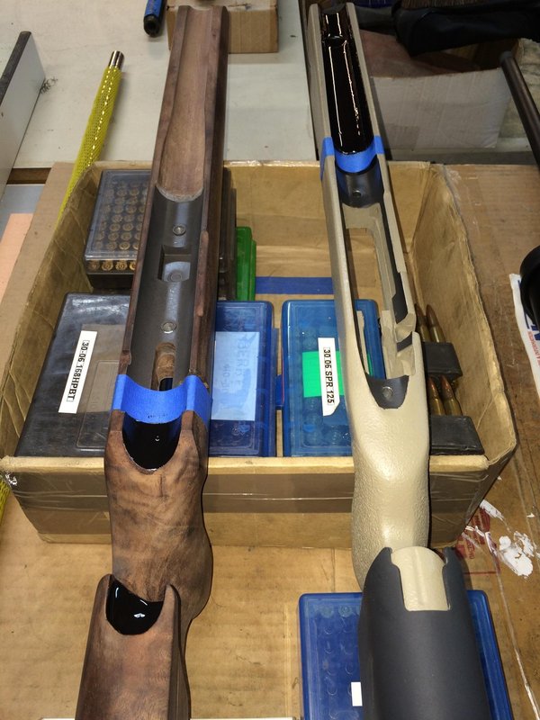

Here's a few pics of my build:
blue tape is covering the bedding for the L- shaped lug. I made a couple changes that are easy to roll back to original. Namely the 40moa rail and I went with a chromoly barrel so we could parkerize it with the rest of the metal. Floorlate is a PTG instead of Remington. It's a higher quality piece. Threaded the cap based on feedback from end users. I didn't use the mk13 trigger on this, tried it but we think with a tuned 40x instread and moved the trigger to the mod7. 20170511_082813.jpg

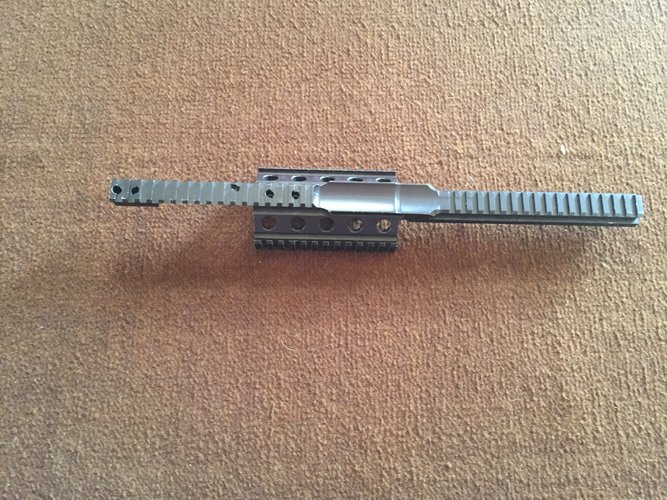

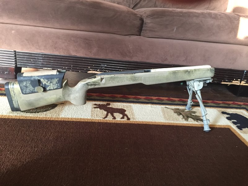

Making some progress! Big thank you to USMCSGT0331 for making these pieces of history available to us!
Really glad you like the stock! Your stock has definitely "been there, done that!"
