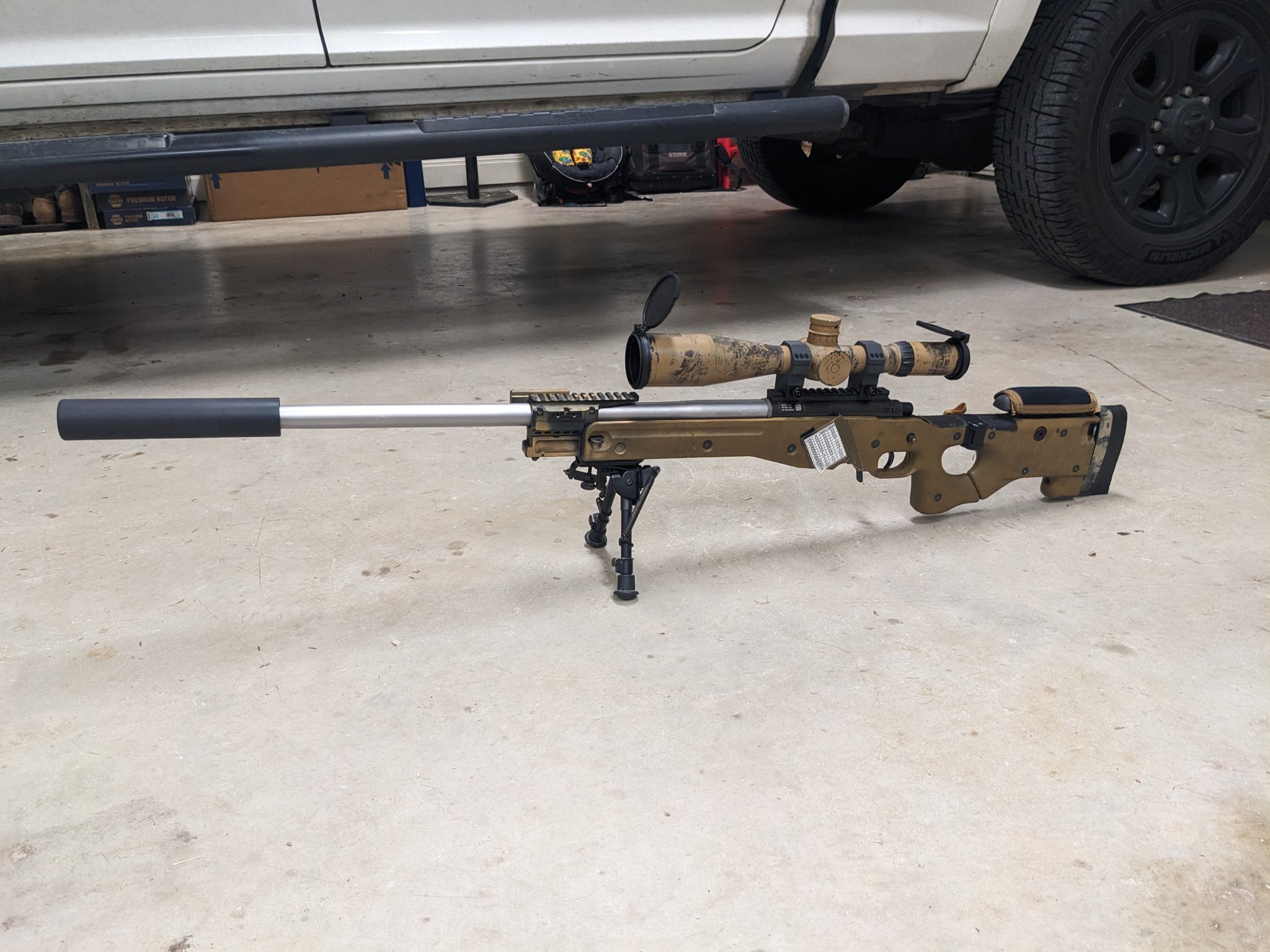

Getting ready again for this.... barrel work should be done this week, i am told by LRI.
They are awesome to work with and now that i have a scope in hand, im ready to have the gun in hand too!
