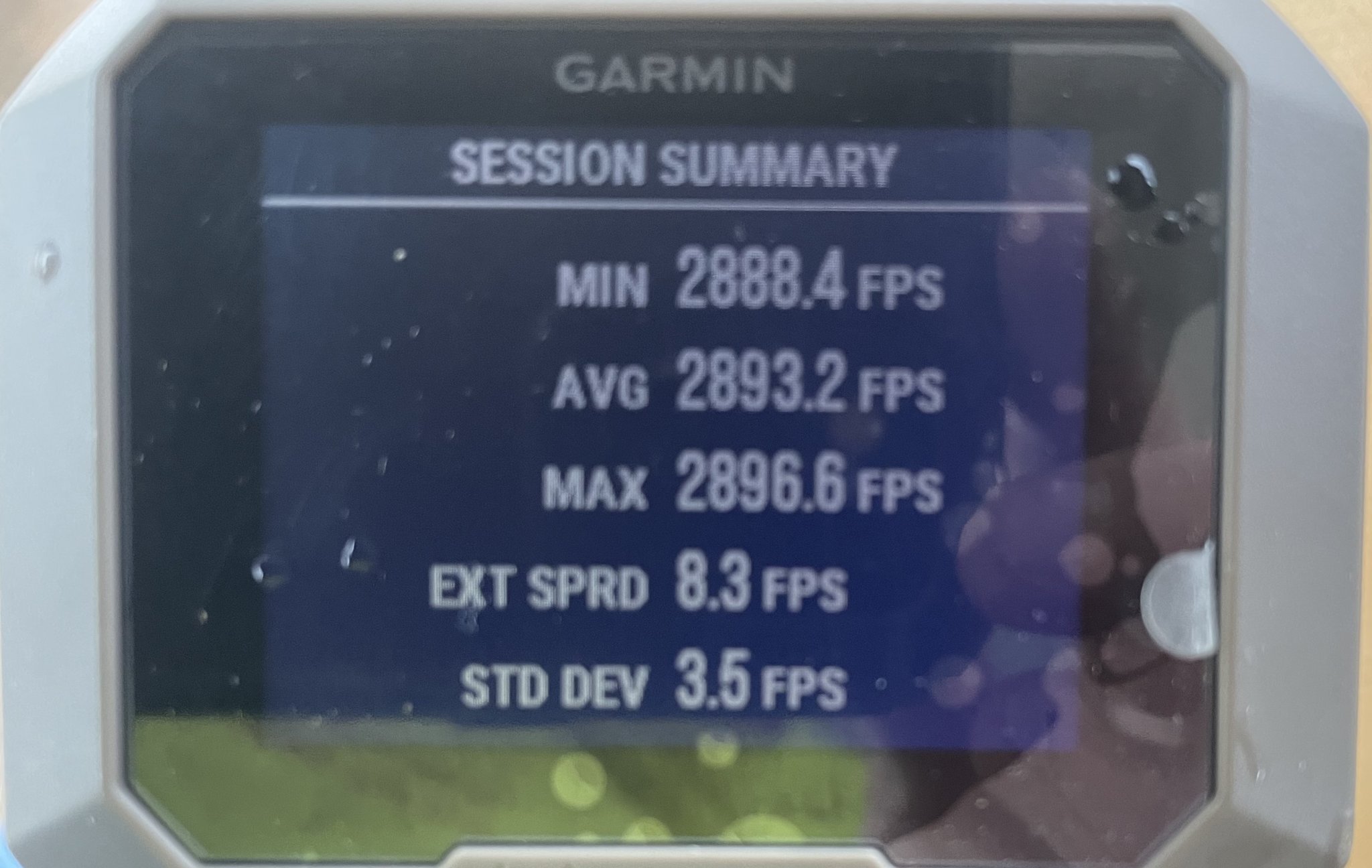

i’ve been slumming it with AAC 77gr OTM in an LWRC IC piston for about 500 rounds now. it shoots right at 1moa if i do my job. at 500 yds i can consistently hit a 12” steel plate.
i’ll buy more at .62/rnd. i’m no professional, just a desert crawler looking for rocks to bust up.

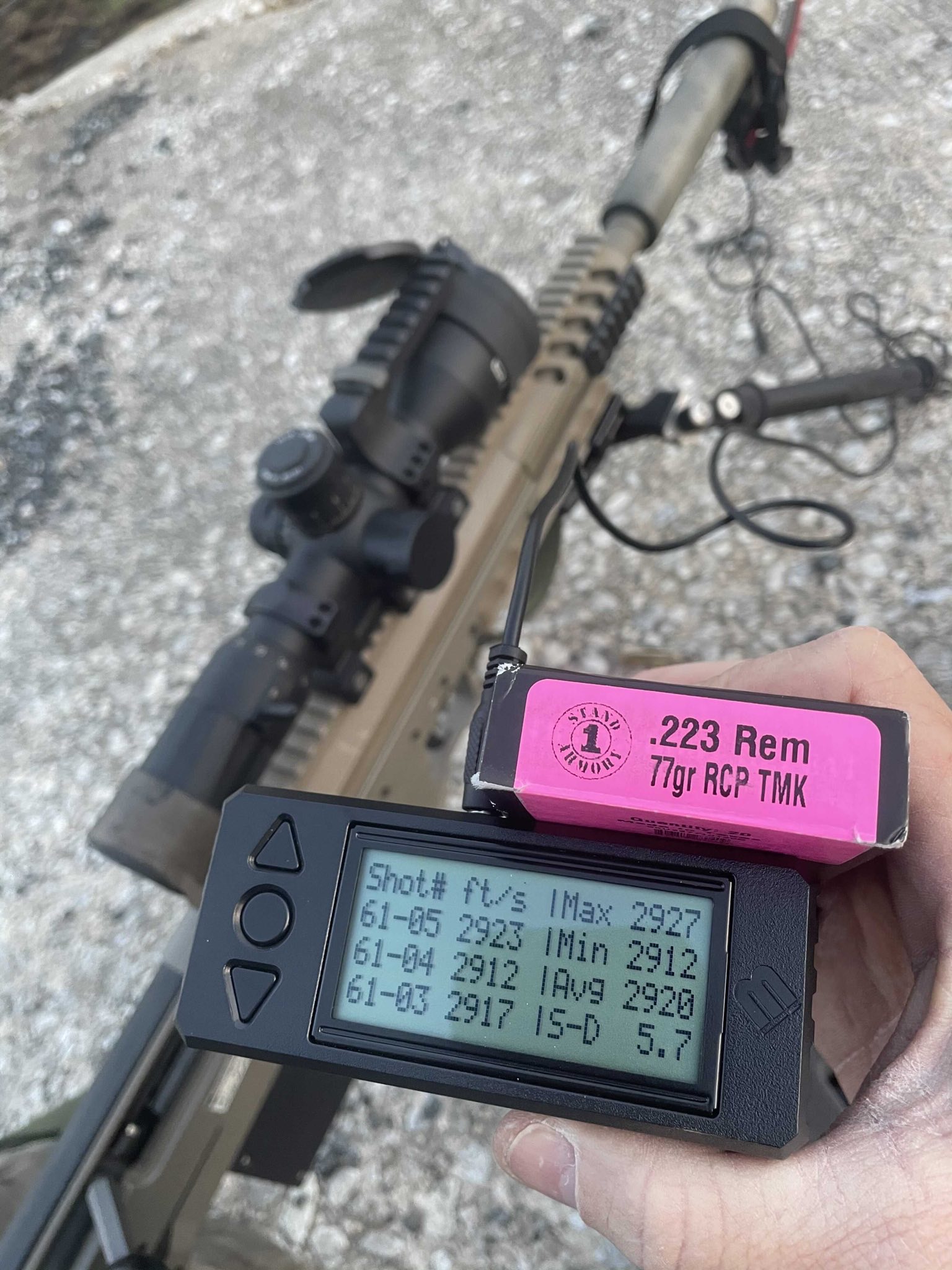

IMI Razore Core 77gr match is pretty close to MK262 velocities and is sub-MOA accurate in my rifles. Black Hills 5.56 77gr match is basically civilian Mk262.
Razor core has been more accurate and had better Es sd than bh mk262 for me
Stand1 loads hot super accurate low es sd 556. More expensive though
