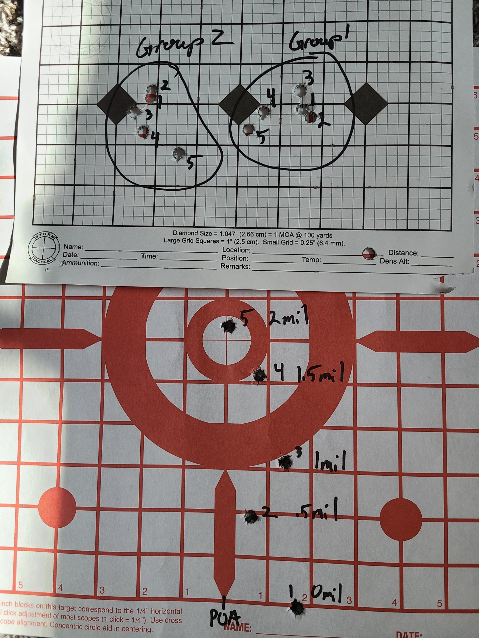

Finally I got to try some of the Norma Match I just got in. I was looking forward to throwing these into my kestrel and trueing up in prep for next weekends match. Two 5 round groups where the first two shots are touching then the 3rd-5th seemed to go whereever. I've attached this to provide a visual.

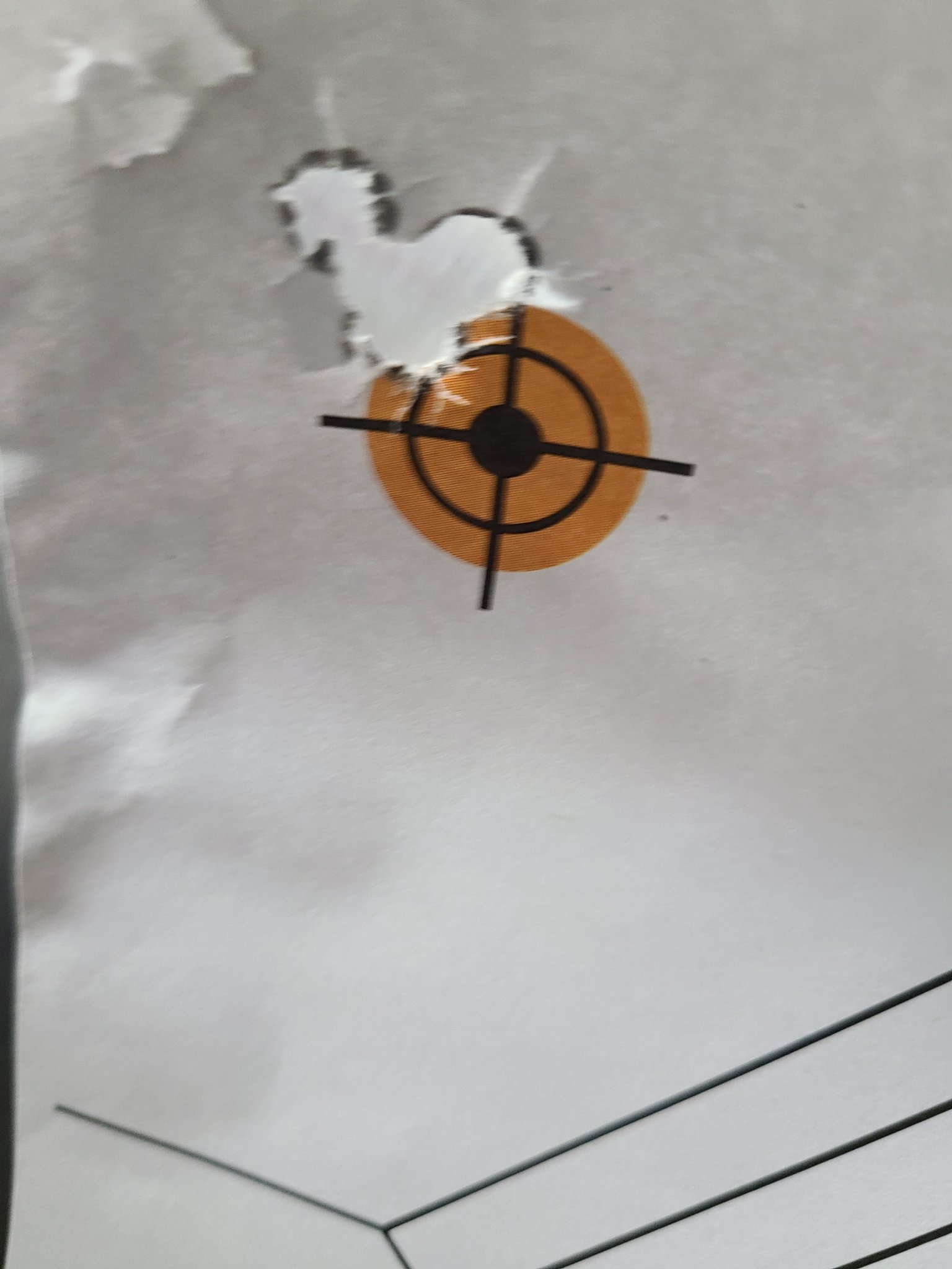

I decided to run a quick 5 round 100 yard turret test which is also attached and labeled. Fired 1 shot dialed .5 mils 5 times. First picture is a group from the Kraft challenge a few months back with FED GM 175 SMK.
Second picture is from the range session where it started to show. POA on the diamond is the right tip. No adjustments were made
