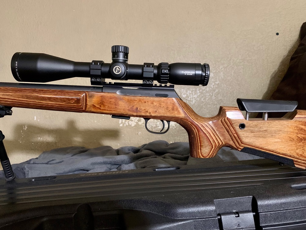

First, which CZ? I have a 457 and got a 20MOA rail from DIP,Inc. It is low to the rifle (no bubble in the back (which for me was the difference of also going with new rings) and the DIP rail is also half the price of the 419. I It also extends beyond the receiver which was a Godsend for me because of eye relief. I haven't tried a come-down to 15 yards but with a 100 yard zero it has a ton of come-up. Coming down to 50 yards is 2 clicks. To 300 it is ~ 11 mils (~1 revolution of the turret). This I calculated for 22 LR. I shoot 22 mag -big difference.
I use a bubble attached to the scope. Never looked back - it's perfect. Here's the link and a pic of it installed on my CZ:
https://www.diproductsinc.com/Detail.aspx?PROD=1422401&CAT=3600
