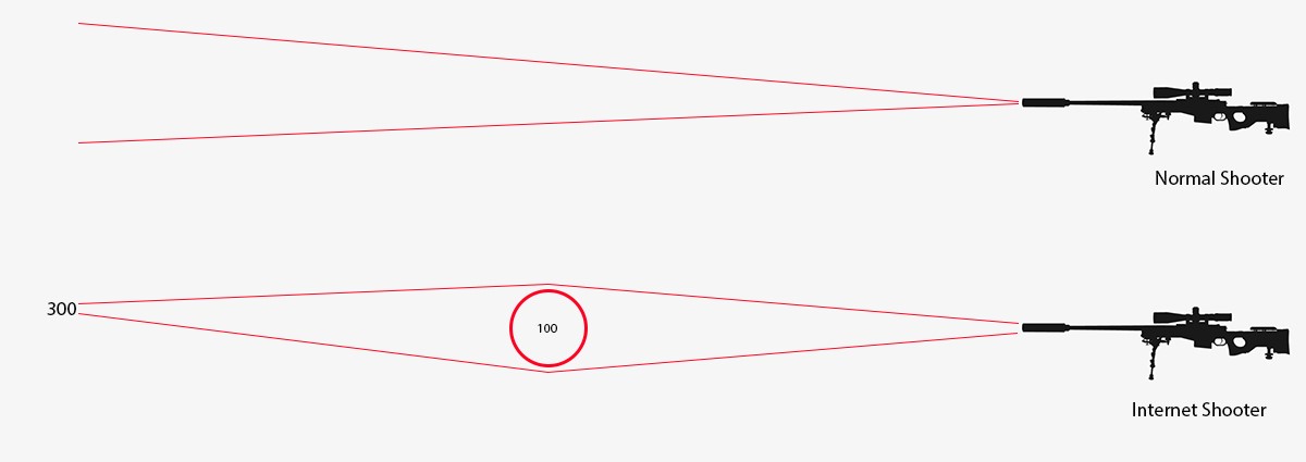

Bullets do not get more accurate at range.
This has been covered before.
Reactions: Steel head
You’re spot on, and unfortunately this bit of folklore just doesn’t seem to go away.
Just to reiterate, bullets are not guided projectiles and they can’t correct back to POA. They disperse in random directions. If you’re getting 1MOA at 100yds, then the best possible accuracy you can expect at any greater range is still 1MOA. They can’t self correct to less than 1MOA, that’s the angular size of their randomly generated dispersion pattern.
Sorry to beat a dead horse, carry on.
