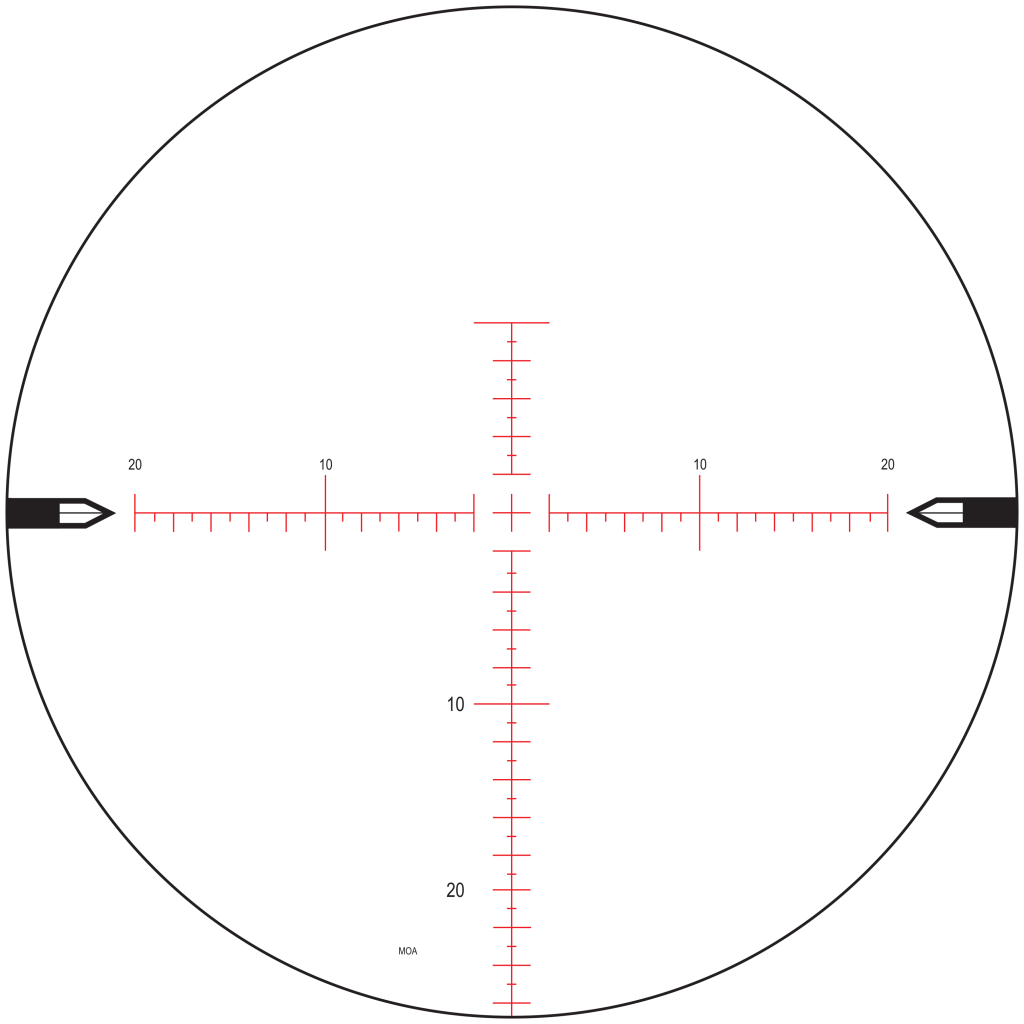

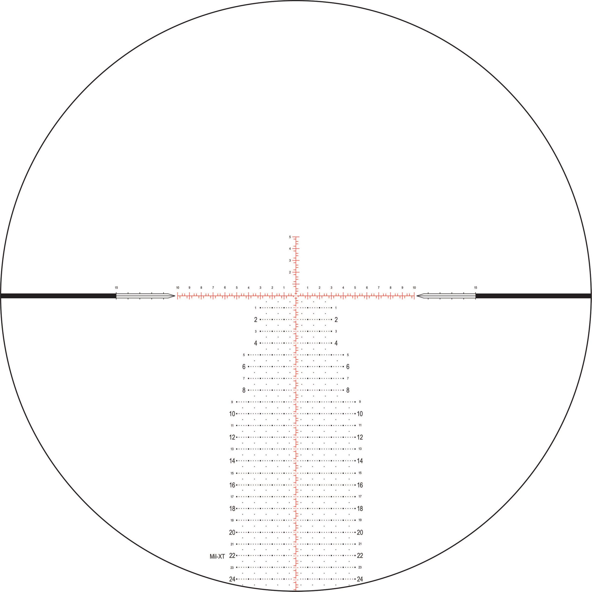

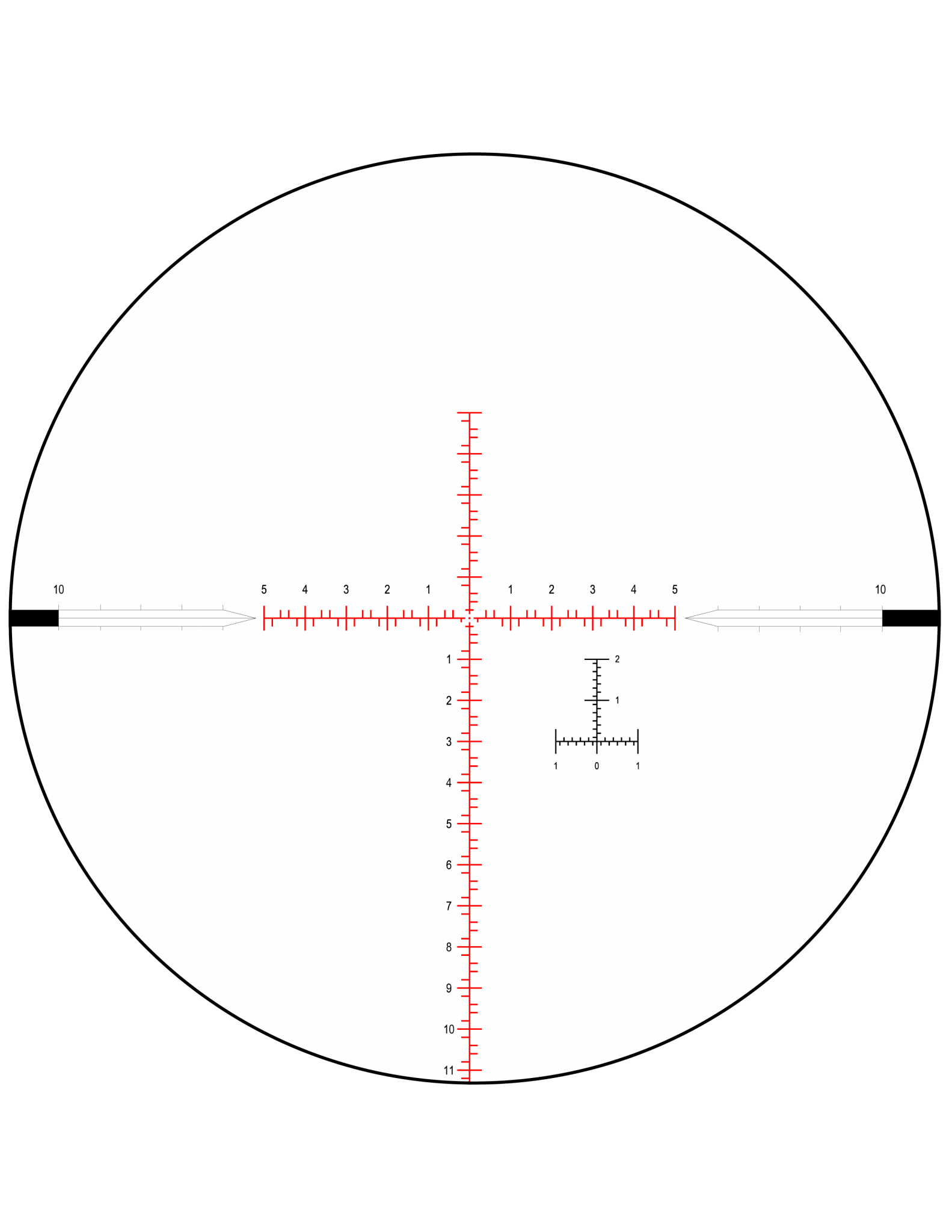

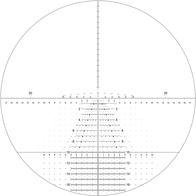

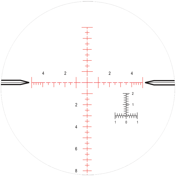

So, I am absolutely going to get the ATACR™ 7-35×56 F1 RIFLESCOPE.
Now, I'm looking into the reticle.
I'm leaving toward the MIL-XT, but the Tremor3 looks interesting. Can someone school me on the advantages/disadvantages of each?
So, we have the MOAR:

MIL-XT:
7088736
Tremor3:
7088737
MIL-C:
7088739
MIL-R:
7088740
Mil xt is really the only one that compares to the tremor 3. If you want hold over points below the main horizontal line, it's between those two. You need to decide if you want a "tree" style reticle first. If so, it's mil xt or t3.
If you think you'd rather have a standard crosshair reticle, then it's between the other three. If you want moa, there is only one choice, the moar. If you want mil, it's between the Mil-R and the mil-c. The Mil-R is useable, but i think most people would recommend the mil-c as it is a more detailed, modern reticle.
