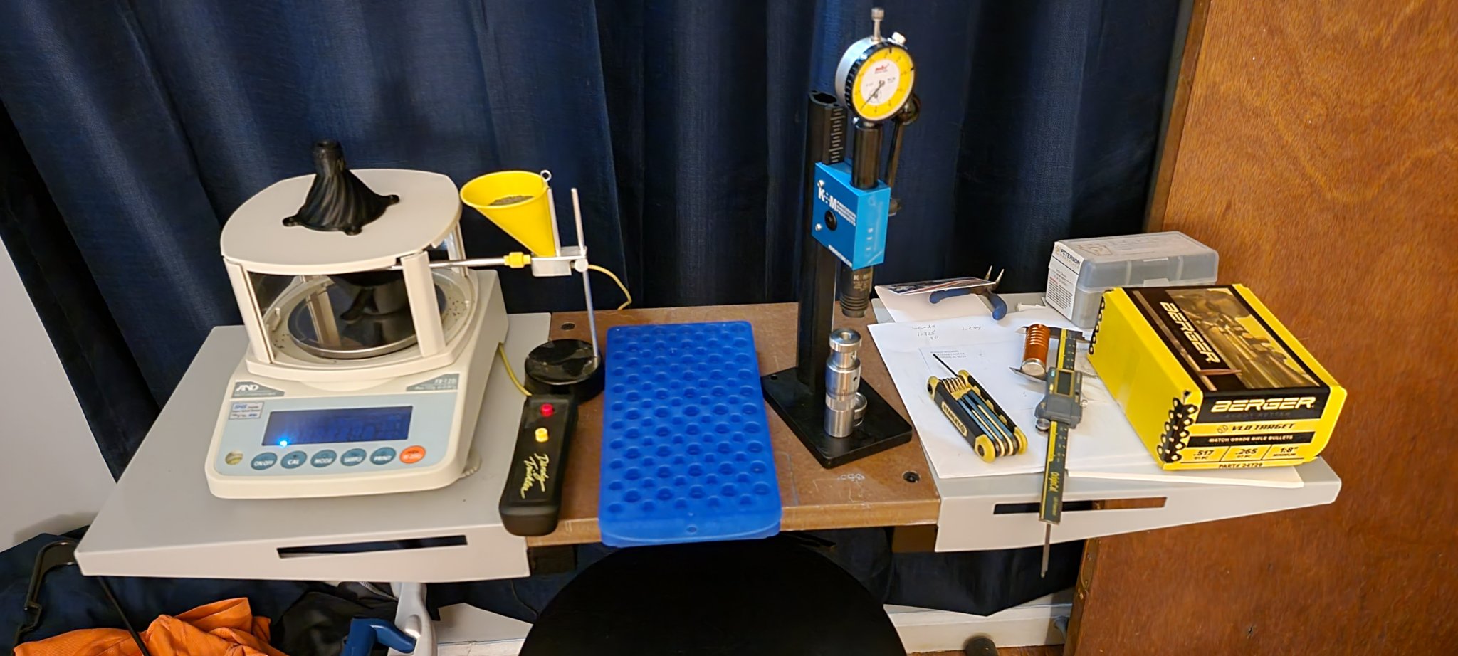

I want to resurrect this thread in the hopes that someone has a similar setup. I'd like to be able to charge and seat bullets into prepped and primes cases at the range to make load development more efficient. Anybody have a system they'd like to share?

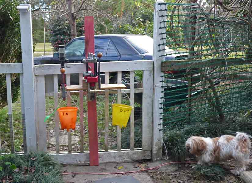

Here's a couple of ideas:
You need a place to put the scale to shield it from breezes.
A Harrell's measure can be used if you know what each click is worth beforehand.
Here's a less messy version of the first image.

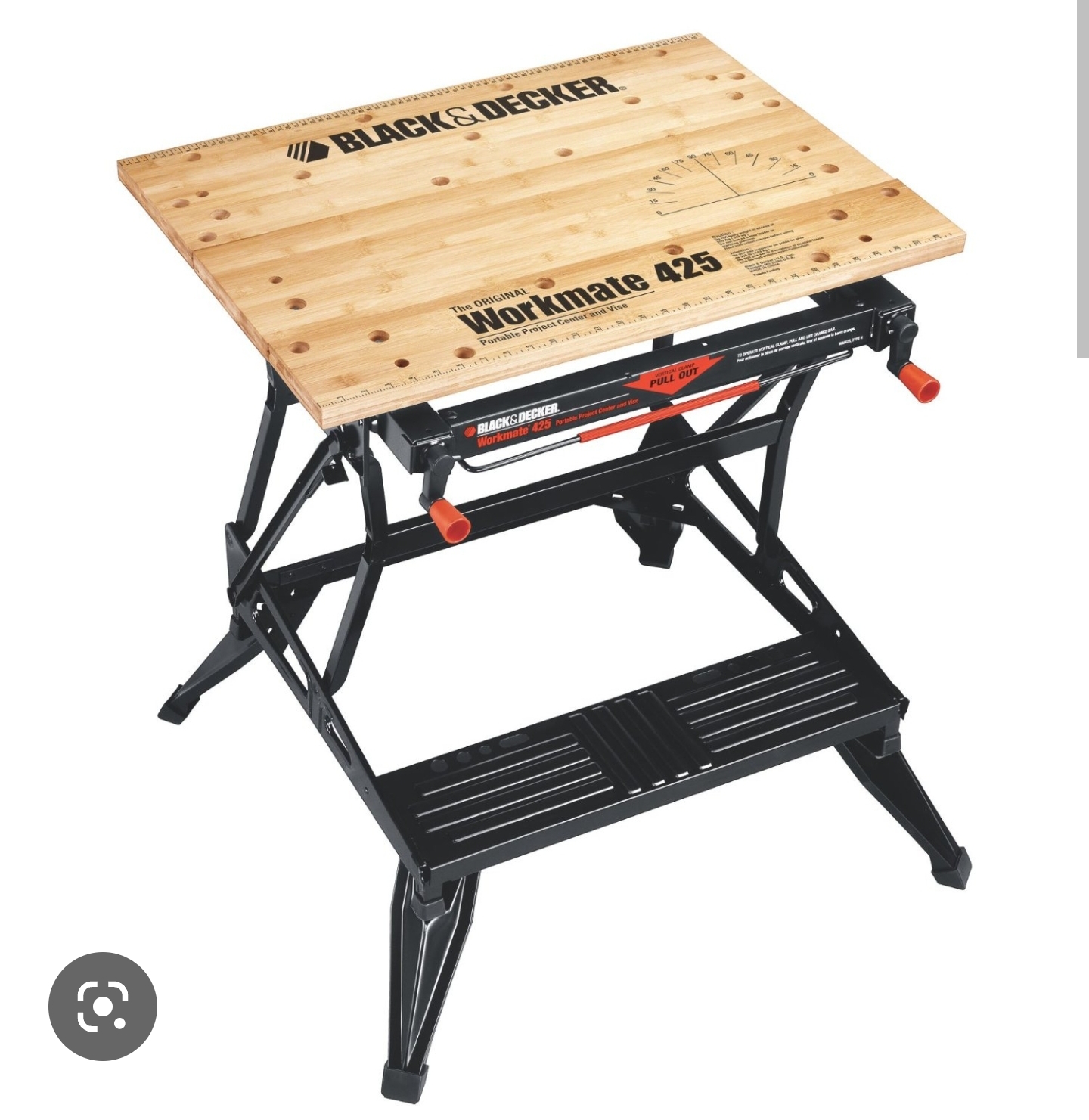

I used the workmate thing for several years.
I taught school in Bush Alaska. If there was anything of any apparent value left behind for the summer, it would be stolen while you were out. It might get stolen if you were gone for just a few days. 3 or 4 generations of government dole has developed the Native Alaskan into being MUCH like the Urban scum of the lower 48.
So...when I'd pack up for the summer, I took everything of true value with me or shipped it and stored everything else in a shared shipping container (Conex box).
I used a piece of 2x6 attached to a double layer of 3/4 plywood about 30x30 glued and screwed all together. The 2x6 would be clamped in the Workmate. I could also then use it for the summer but rarely did. Admittedly, it was not even remotely close to being as sturdy or stable as the bench I have now but it most definitely worked. To do it over, I'd use the T-track stuff on it as well.

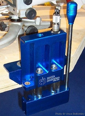

Guy I know, benchrest shooter reloads at the range. Uses a Rcbs chargemaster and this small 2 station press he clamps to
a picnic bench. Similar to the one in the pic.

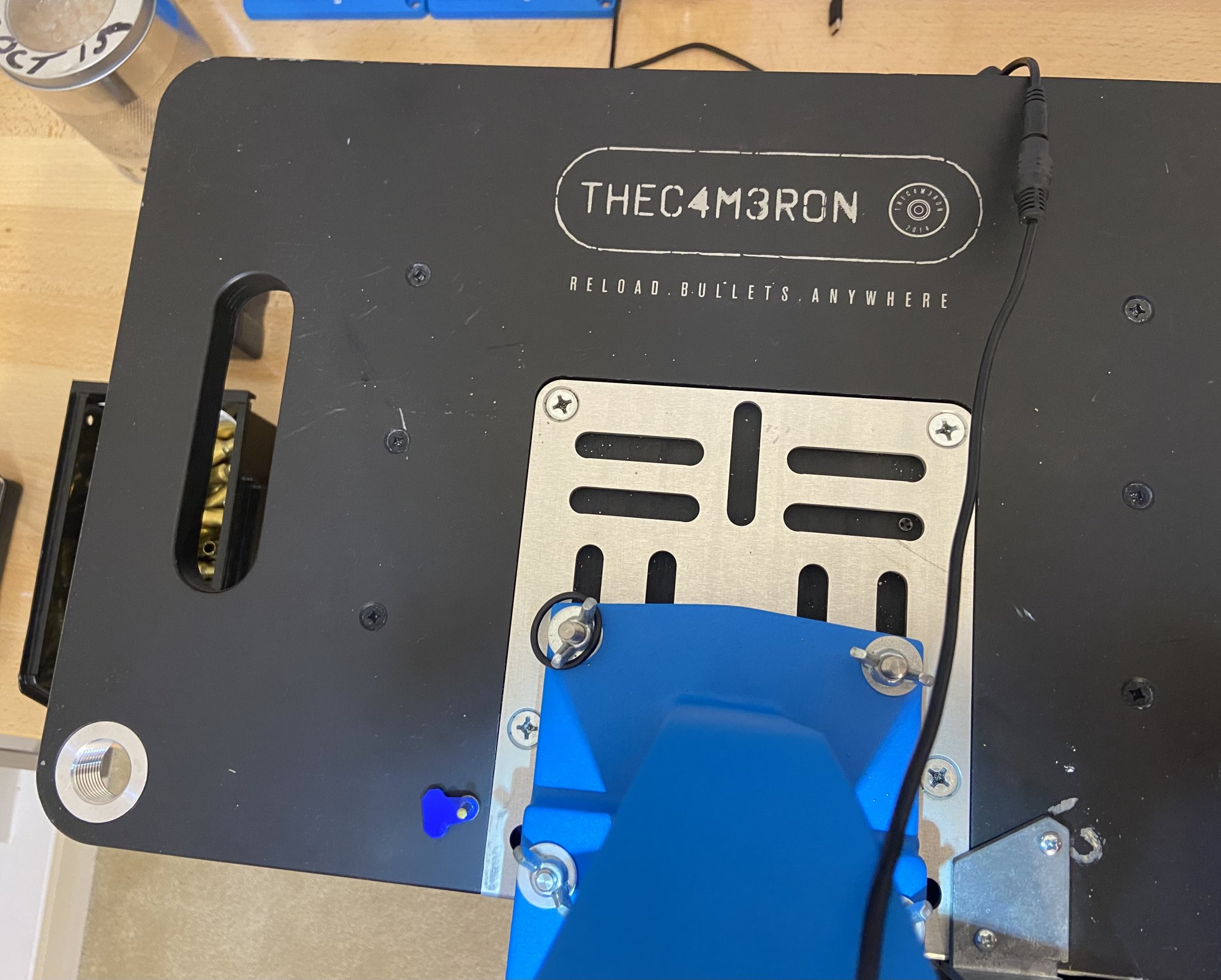

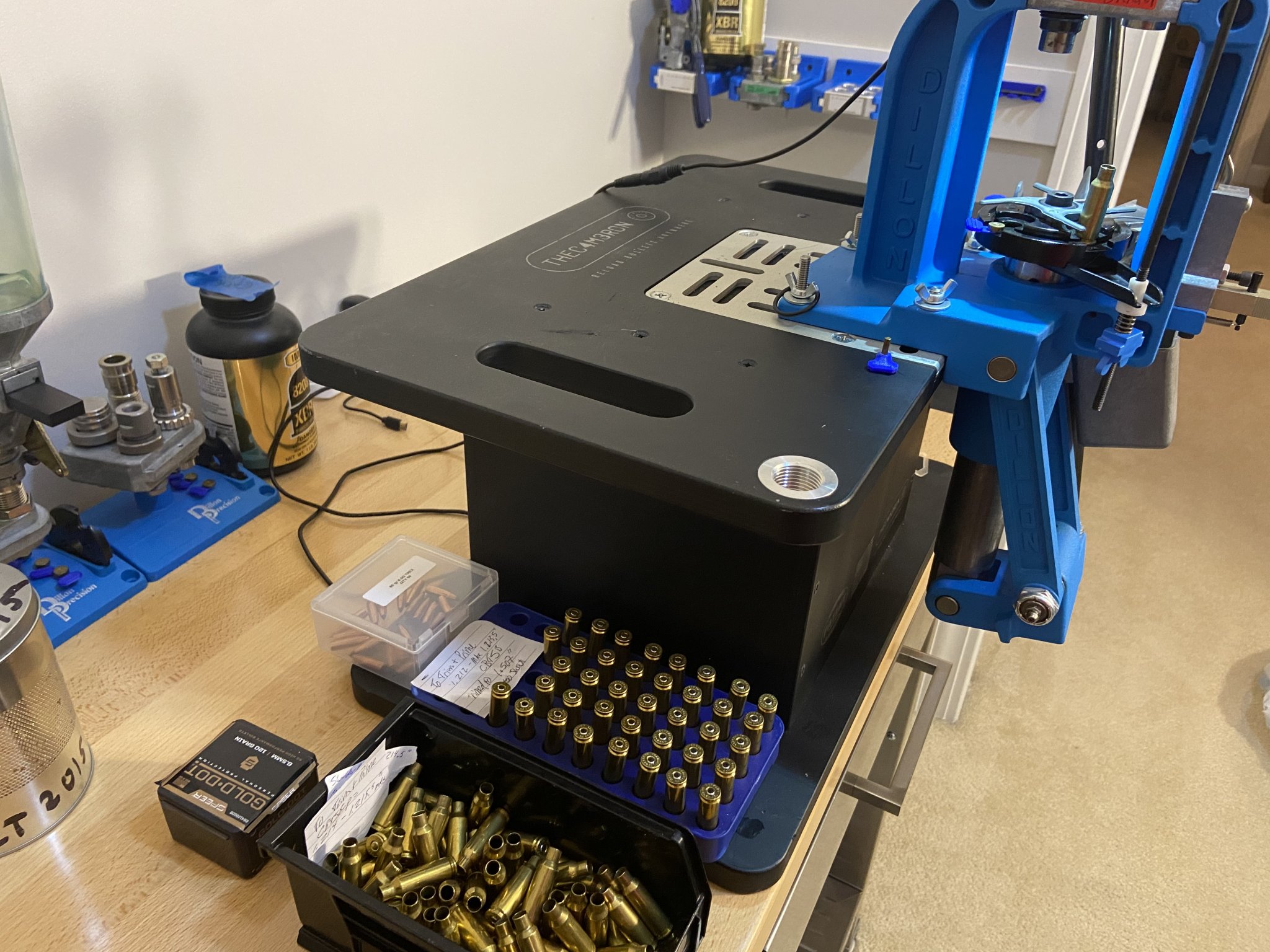

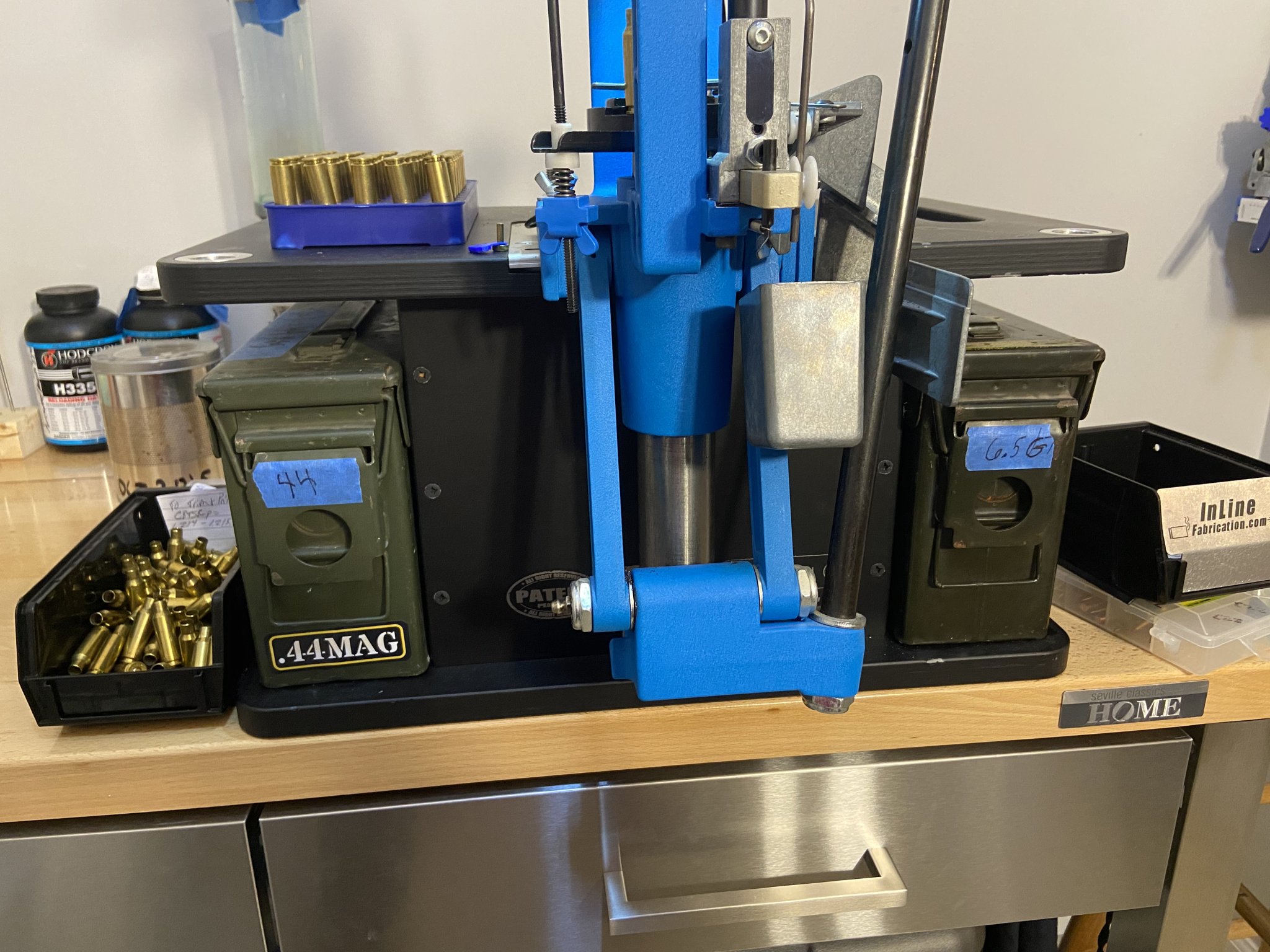

TheC4M3RON. If they're still in production. Think wooden, H-shaped box with a SS mounting plate. Can fill sandbags/ziplocks, whatever up to 25lbs and stabilize your press. Moves from countertop to countertop. I used to run it from my living room or kitchen table, even the patio. Last pic shows perfect size to stick a couple heavy ammo cans if you choose not to fill interior with sand or go lighter sand for easier transport.
That looks cool, what press is that?
I like that. Might purchase one for loading in our home when it is just too cold to load in the shop. Move my large primer 550 to this bench.
Now my two 550’s are not nearly as clean as yours. Keep them dust free and well oiled but I suppose, loading cast bullets for a decade on one and two+ decades on the other, allows the finish to be not so pristine. Loaded 44 magnums on the large primer press last night. A dream to use.

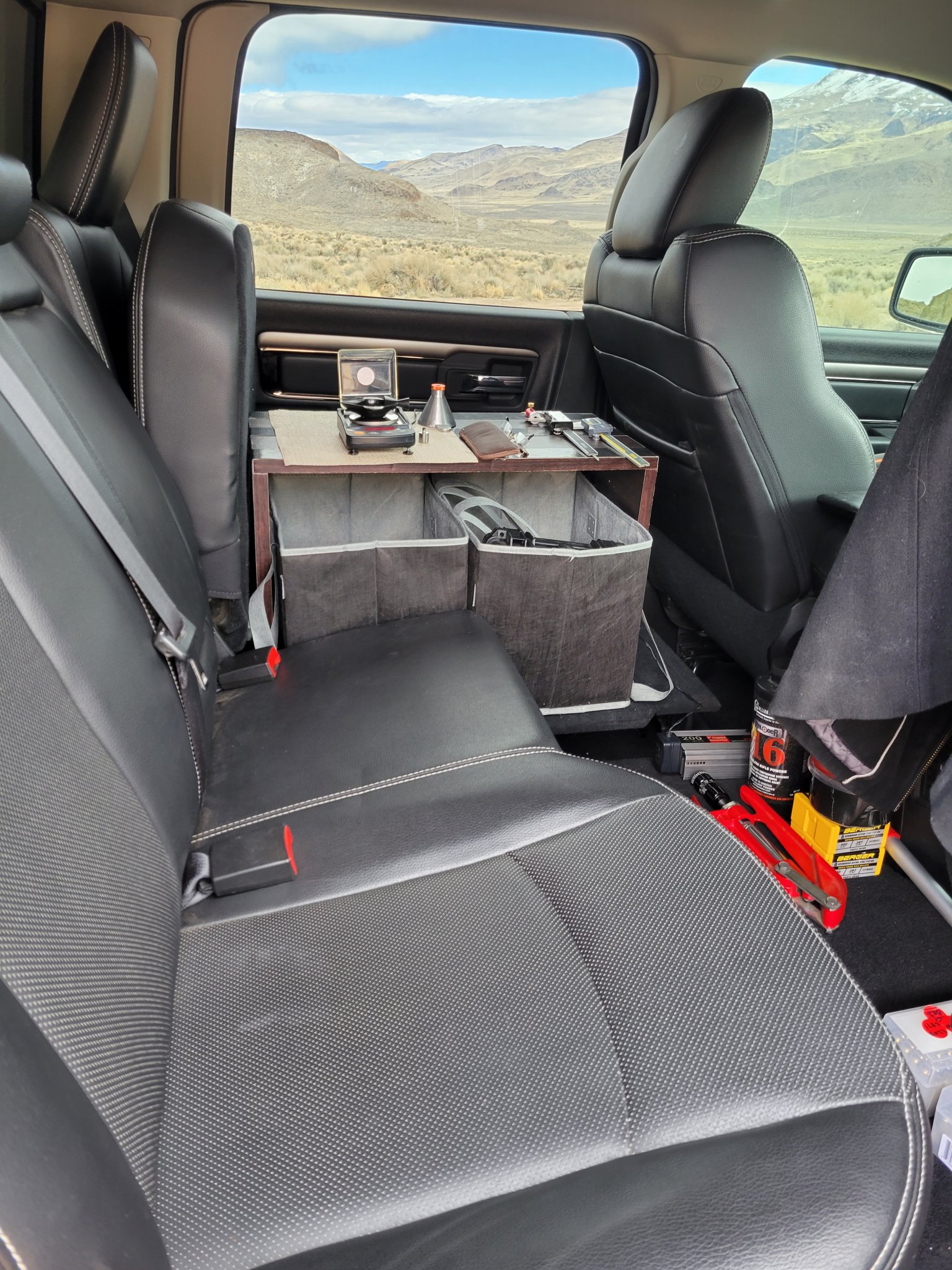

I bet I could use a power converter with my Chargemaster Pro with my truck's engine running. I like the little table idea. Some butcher block and a few short table legs from Lowes and I'd be in business. I guess my only concern would be a level surface for the chargemaster.
How can I use the tailgate of my truck as a table? I smell a winter project coming on....
